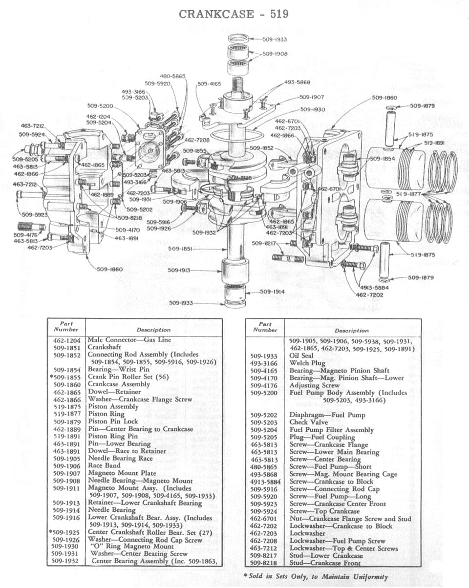

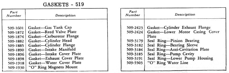

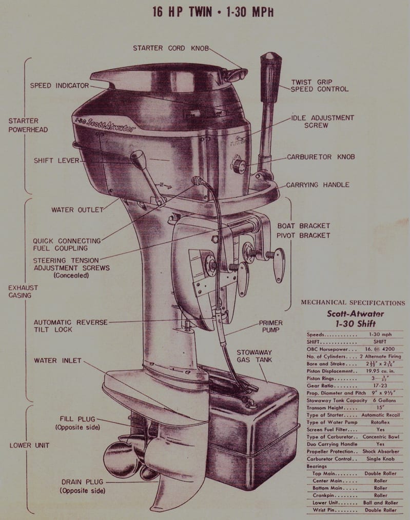

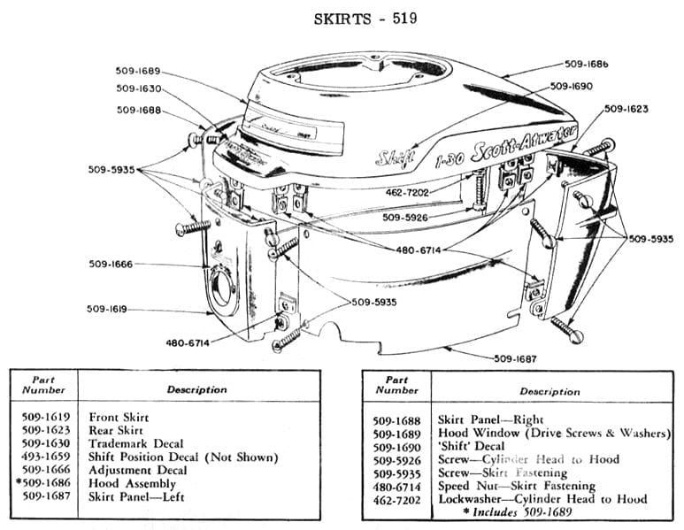

        Here are the parts
        Specifications
        Skirts
        Crankcase
        Gaskets

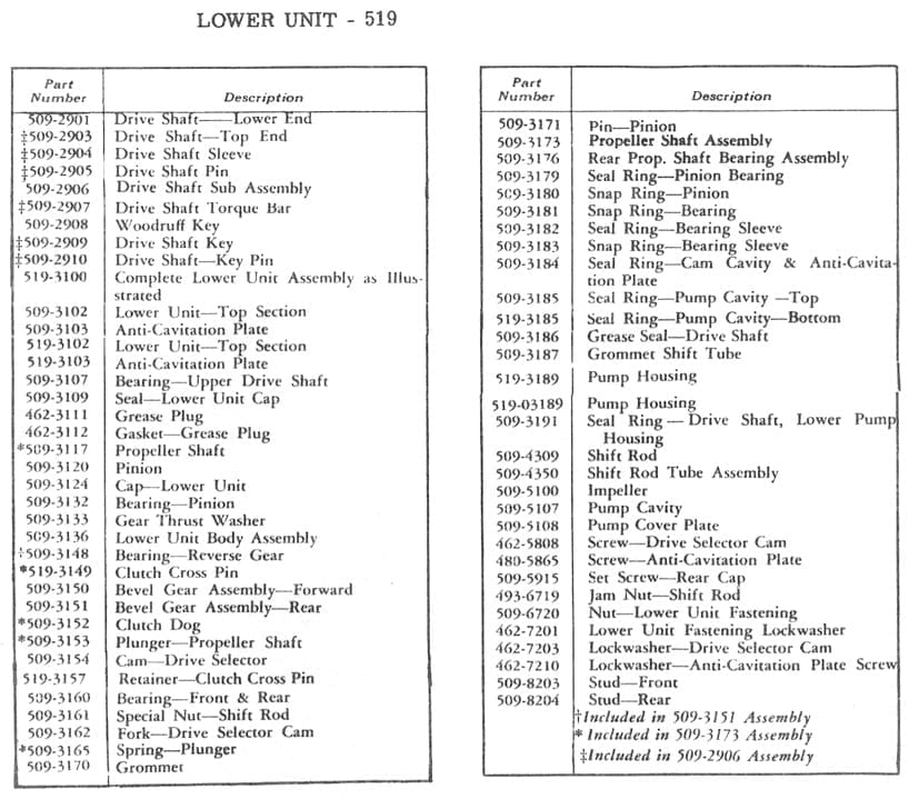

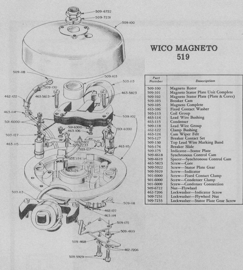

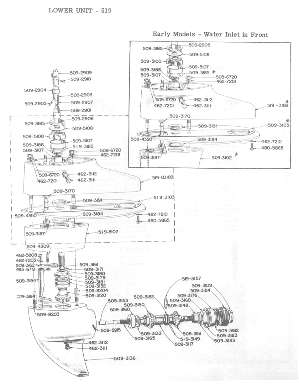

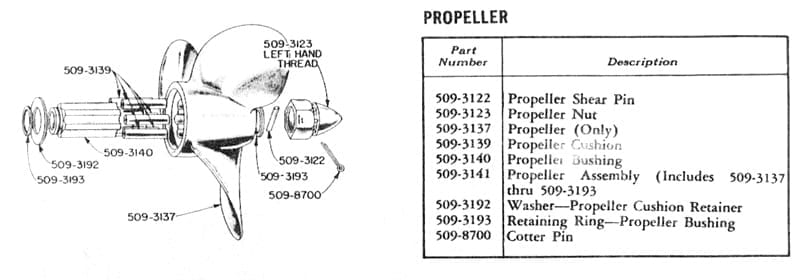

        #188318
          More
          Lower-Unit
          Lower-Unit-Parts-List
          Magneto
          Propeller

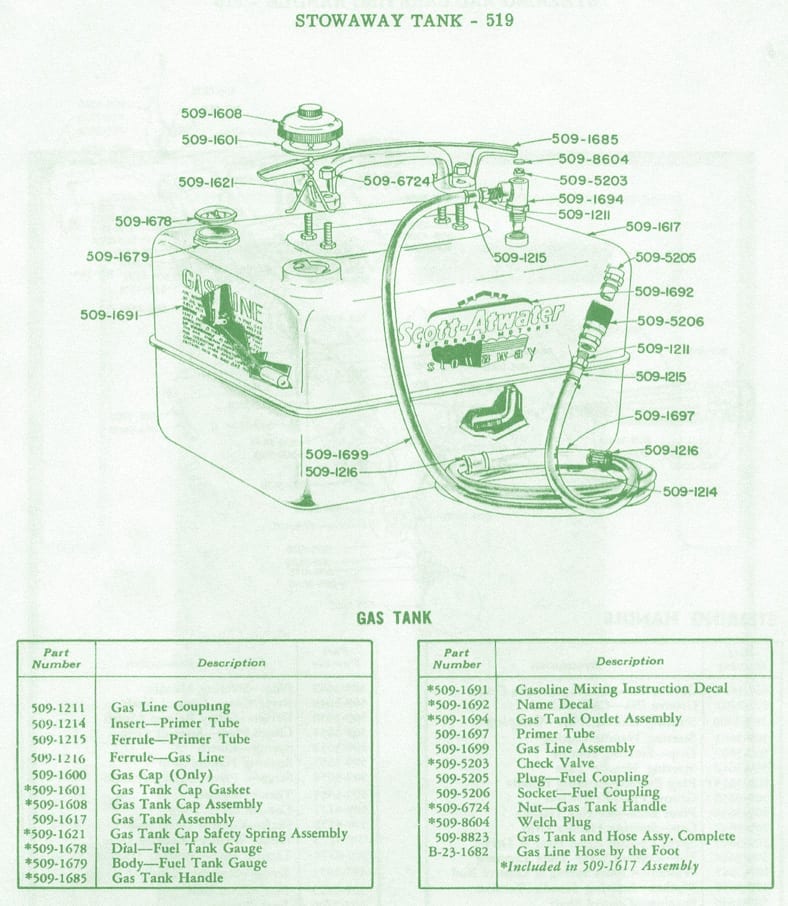

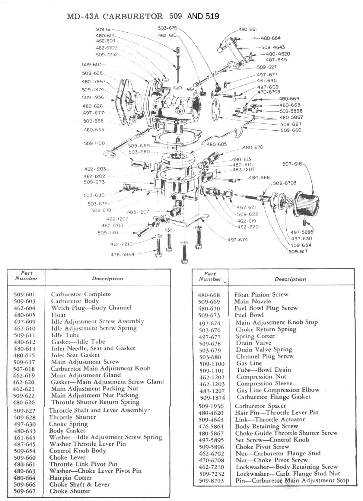

          #188325
            More. Sorry, I’ll have to hunt for the carburetor. I have it somewhere</strong
            Stowaway-Gas-Tank
            #188328
              Carburetor
              MD-43A-Carburetor

                Thank you thank you thank you! ( I feel like Gomer) This really helps a lot. Took the covers off and found NGK A-6 plugs. Had spark on #1 cylinder. Pulled the fly wheel. Coils are toast. Originals. So now , I”m on the hunt for the usual suspects. The motor looks like it’s from outer space. So cool. Can’t wait to run it on the lake next year. Again, Thanks for the help!

                    CHUCK
                      The driveshaft on those is very unusual; various pieces connected together. When (if) you get it apart…..I’d like it if you could post some pictures of the driveshaft?
