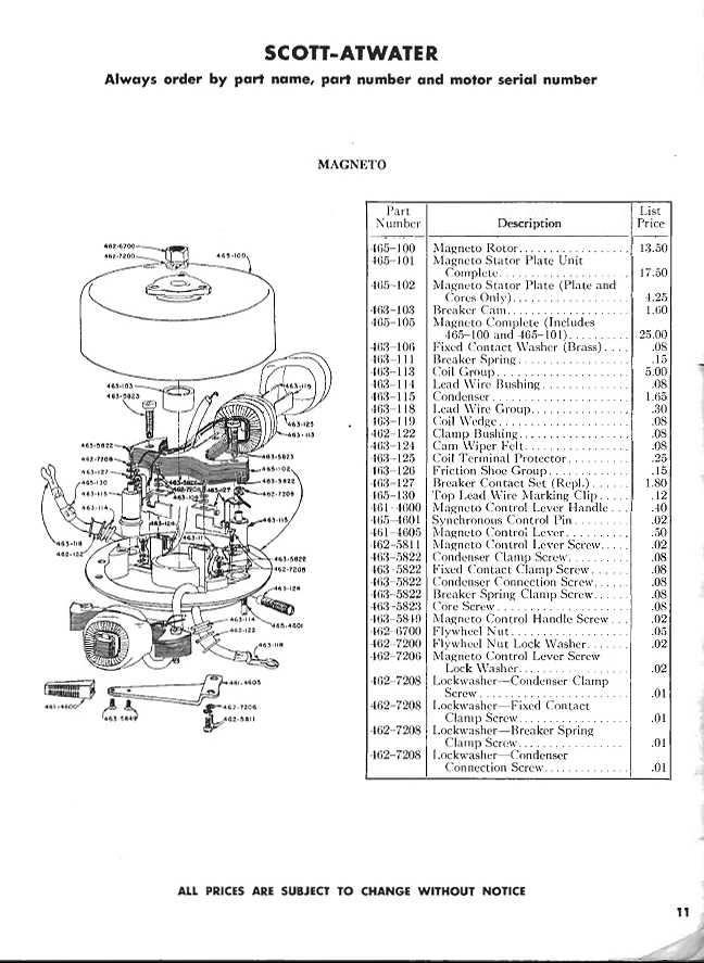

                So; what can you tell me about the ignition pictured; what brand is it…..and especially in relation to other motors that used the same set-up…..so I can start searching out parts…..
                #57099
                  That is a Wico with the sliding points and upright condensers. Used in lots of Scotts in the 1950’s
