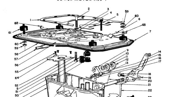

      Trying to locate part #332-1711 mount (#61 in picture) for a 1960 Scott 40hp motor – which is apparently a very tricky mount to find… the dimensions are 1 inch diameter by 3/8″ height with 1/4 -20 threads that exted 3/4″ either side
      anyone have any suggestions where i could find these? i have scoured ebay and google to no avail!

      #240326
      retiredoz
        Looks like the early 60 and 75-hp McC used them too. Might expand your cadaver search ?

              18-20-25 Johnnyrudes also use something similar and might be the same size. They are vibration isolators and Princess Auto carries them but they are slightly taller so the hood and lower pan would sit a bit higher. McMaster Carr or Grainger might be a source.

                Hey Mumbles I didn’t get too lost. It’s just a lot easier to put pictures on Facebook. i did check the earlier OMC versions, not a good match IMHO.
                The ‘support grommets’ used on the 9.9-15 (and maybe a bunch others) might be close enough, they’re 1″ by 5/8s and accommodate a 1/4×20 bolt.

                Captain_Rum
                  turns out discount marine does have them… i will order me a set from there
