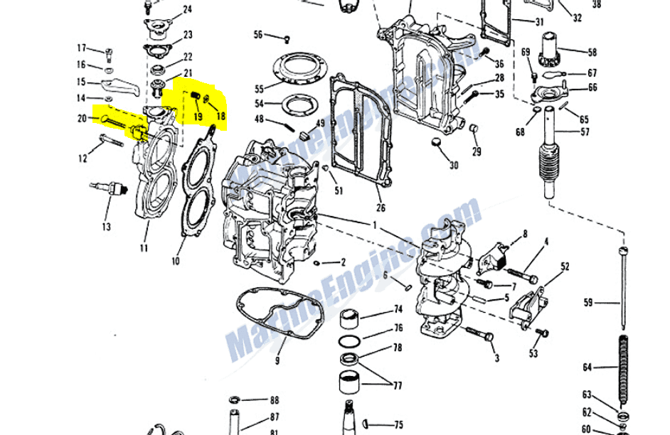

      just curious to find out what is the purpose of the parts shown in yellow
      there is also a funny little detent that clicks as the mag plate rotates …? see parts 48 and 49 ….

        The thumb screw and associated lever are the idle speed set. Limits how far you can set it toward “slow”. The clicky thingy is a friction device to help keep the speed at whatever you want (prevents creeping).

          thanks
          I had not noticed that the MQ’s year 65 version had no side idle adjustment on the tiller handle …all my previous 9.5 have the round idle setting on the tiller
          makes a lot of sense !! 🙂
          same goes for the clicker on the mag plate

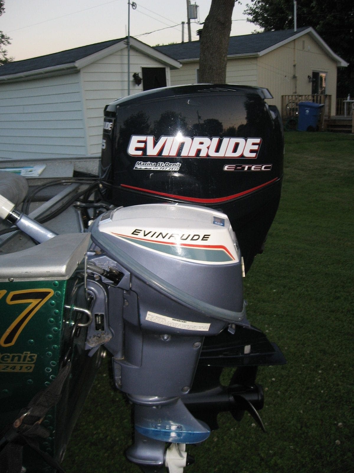

                I am confident as all my other 9.5 were in that range (65-70) I will do the electricals ( I have all the parts anyway and could strip them back out if things don’t work out..
                never done honing.. i’ll have to try it on this one if it is to sluggish
                my spare kicker worked out fine at 65
