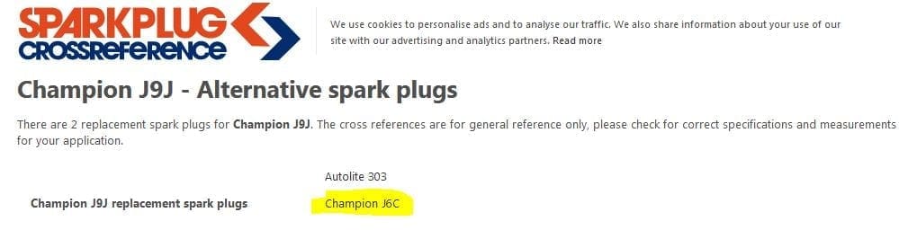

        Your Goodyear is a 1948 1.5HP made by Gale. The Gale equivalent is Model 1G5. I see no 025-3582….
        There is a parts manual for your motor here:
        http://richardlpaquette.ca/C1G10%20manual.PDF
        The Spark Plug is a #590143 or a #200322 which Frank R says (in a former post) is a Champion J6J (J6C).
        Cool motor; eh?
        J9

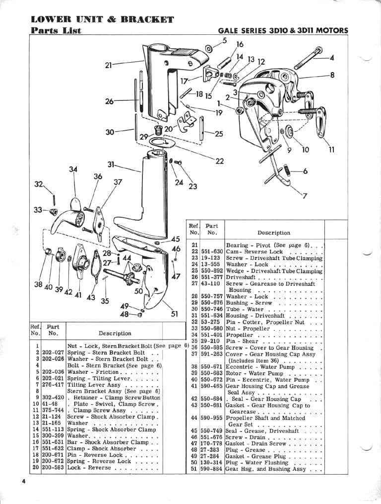

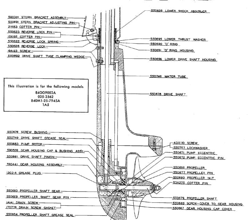

            #176190
            benji41
              gary-in-tampa—–do you have the drawing for the lower unit showing the parts including gears & gasket. Also what is the oil or grease used in lower unit?
              Jim Benjamin
              #176199
                The Gale pictures aren’t as easy as Evinrude, but here ya go–
                Pg-3-Lower-Unit
                #176201
                  Easier to look at, but showing similar unit used on 1951 3hp.
                  Pg-4-Lower-Unit-and-Bracket
