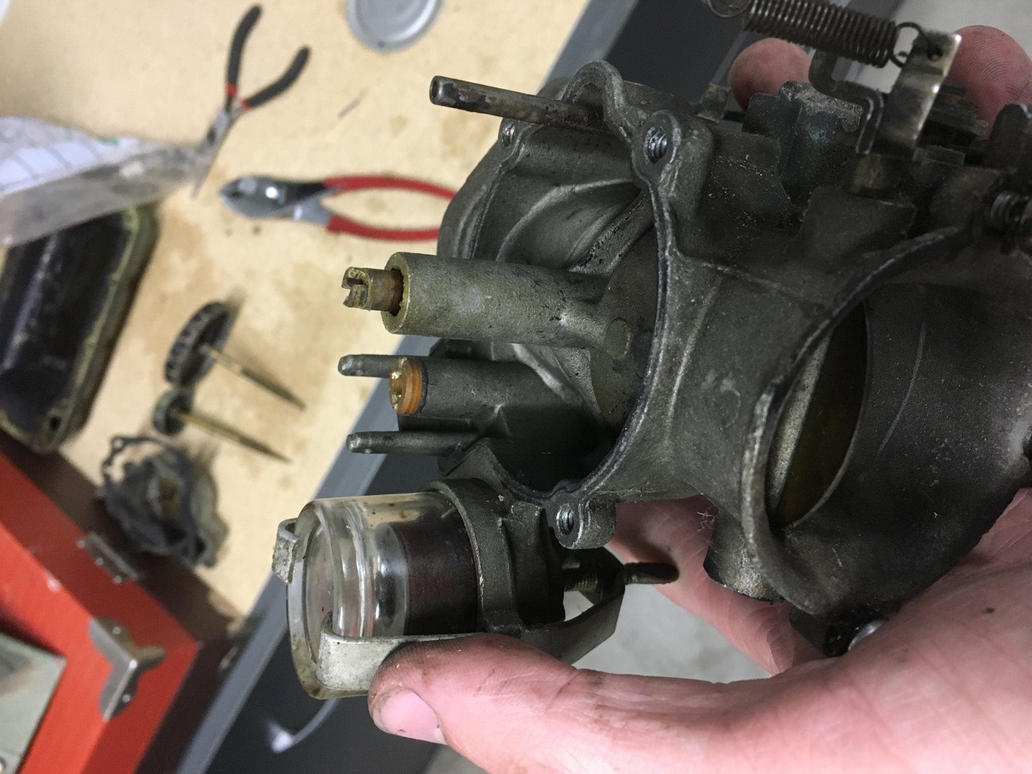

      Hi all. Finally joined the forum and became a member after tinkering with 50s OMC motors for a while. I just bought a Johnson Sea-Horse 25. (RD-14) and I’ve been going through and getting the mechanicals sound.

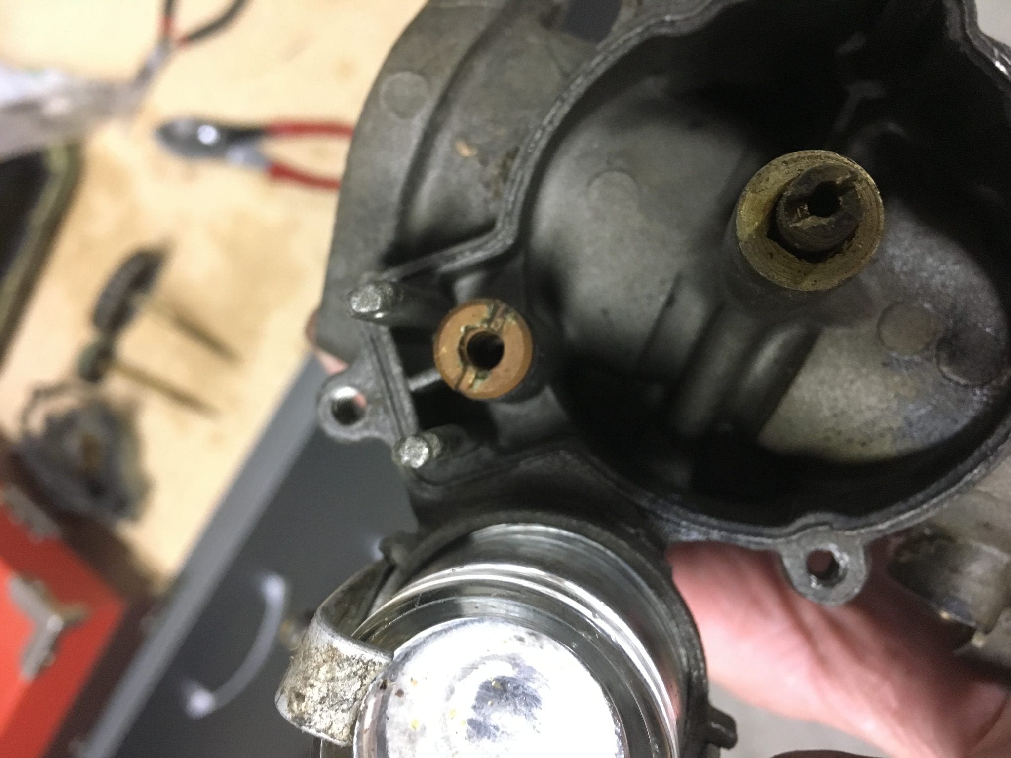

      Checked the ignition and replaced the coils. Did the lower unit oil. I took apart the carb and cleaned it and that’s where I ran into trouble. Everything looked good. The float was well adjusted.The needles were in good shape and the bowl was pretty clean. I just put it back together, and realized that I lost the pin(?) that keeps the float level in the bowl somewhere along the way. I remember something sitting underneath the ‘hinge’ that holds the float in that brass hole(?). Part of my problem is that I can’t find a manual with the exploded parts for the motor either, so I’m not 100% sure what I’m missing. How much trouble did I just get myself into? Pictures attached. Do I need a whole new carb? Does a rebuild kit fix my rookie mistake of fixing something that wasn’t broken?

          It looks like you are missing the float valve needle. While your carb would probably be OK with the original one, I would recommend replacing the float valve and seat as part of a carburetor rebuild. The RD carb kits are discontinued, but the individual pieces are still available and you may get lucky and still find a kit somewhere. The early RDs are fun motors. I have two of them and really enjoy running them.

              The float hinge pin is part number 302661. Just a piece of brass rod. But I think you mean the float valve as others have suggested
