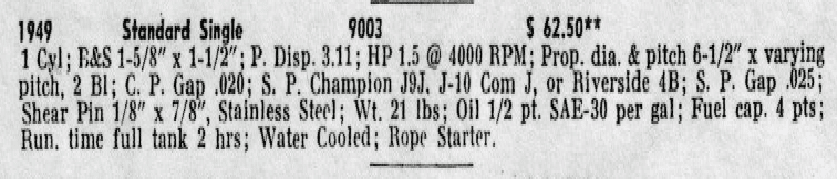

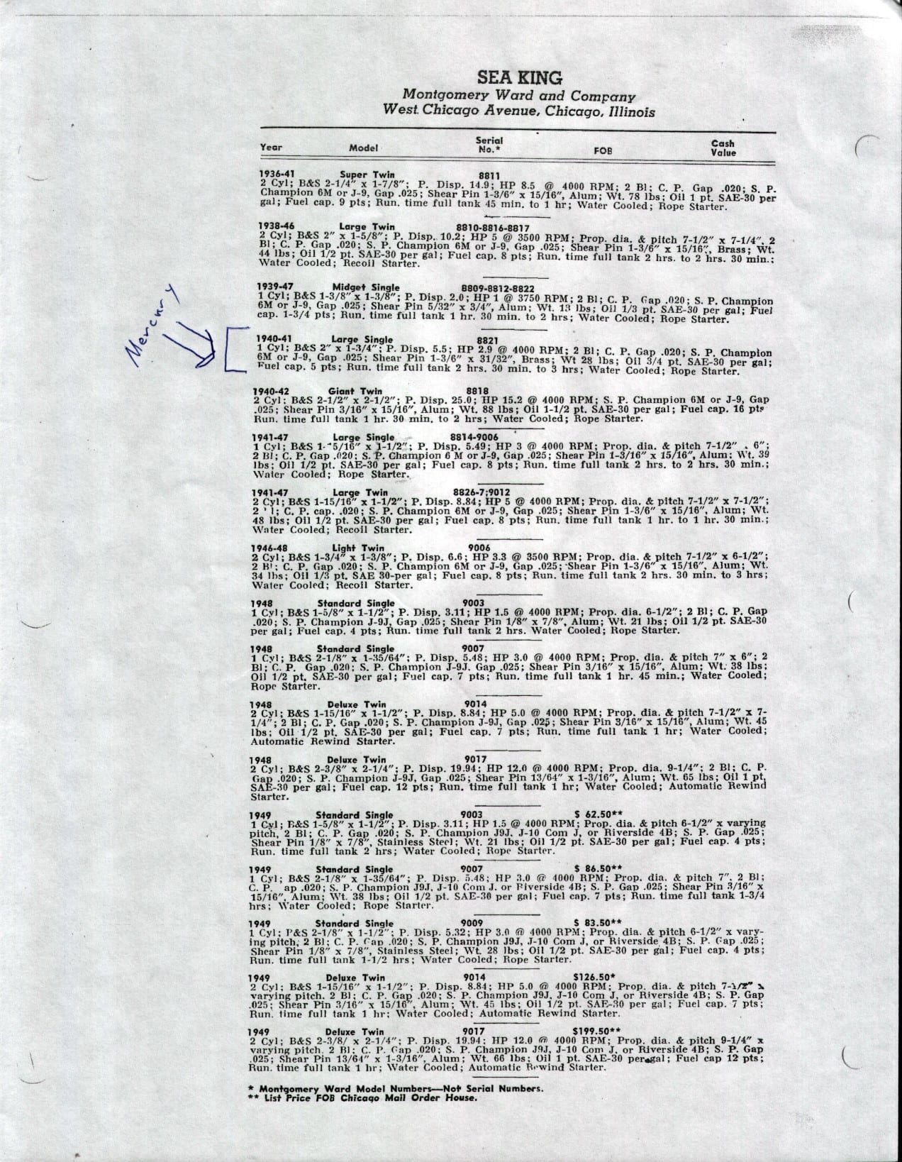

        I don’t have any parts diagrams for those motors in my files. All I find is
        these Specs.
        Sea-King-models-1936-to-1949
        sea-king-1.5
