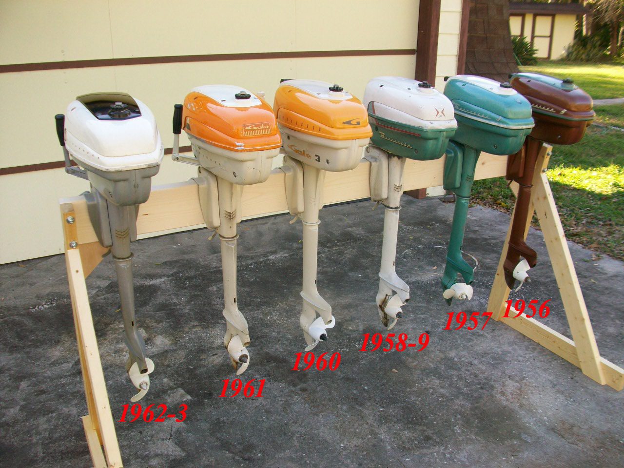

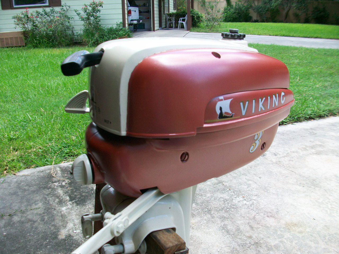

        Well, you might say I have some Gale experience.  How many do you want?  Lessee, I think I have about 12 of them, more or less.  The 3hp Gale Buccaneers were my special interest focus. Gale division made motors for a flock of different stores, Montgomery Ward’s Sea King being one of them.  They all were basically the same motors with varying colors, decals etc.  I have all Buccaneer-branded years from 1956 thru 1963.
        Gale-3hp-motors-by-year
        1958-Viking-3hp

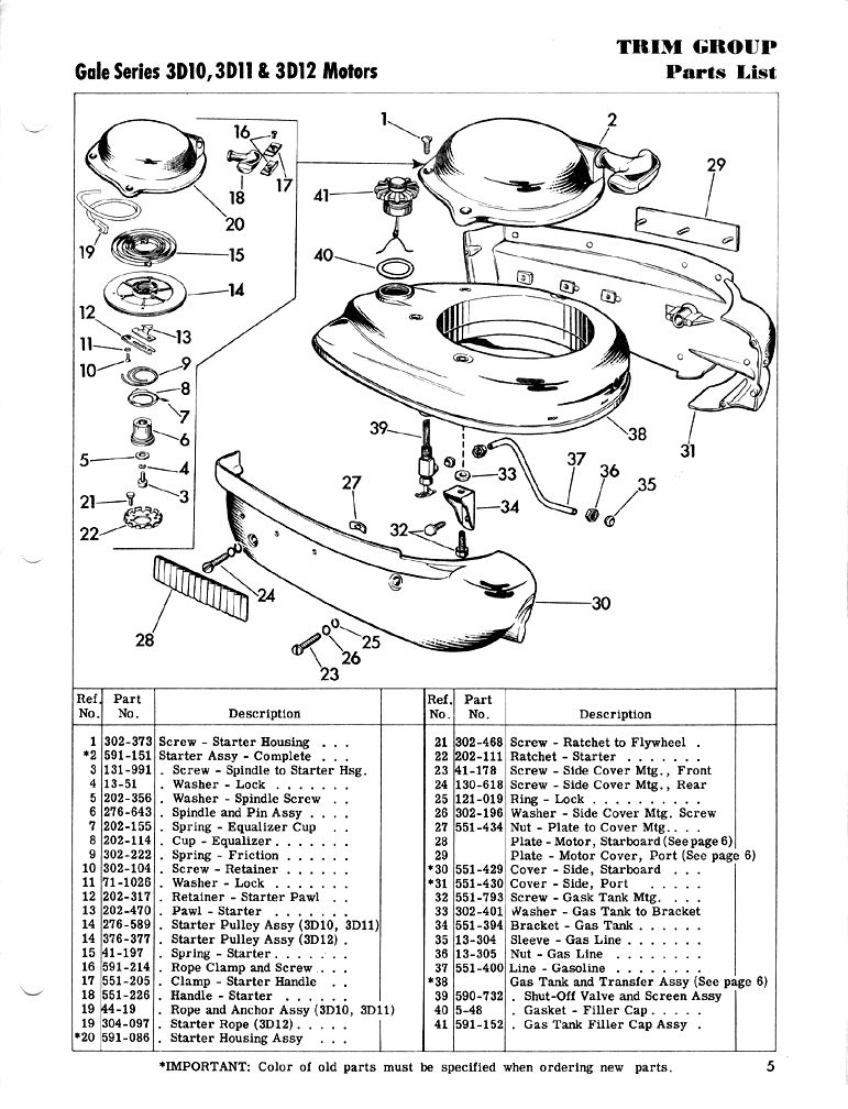

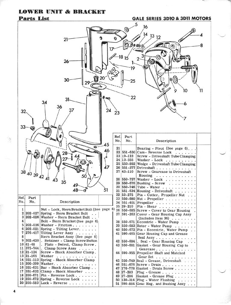

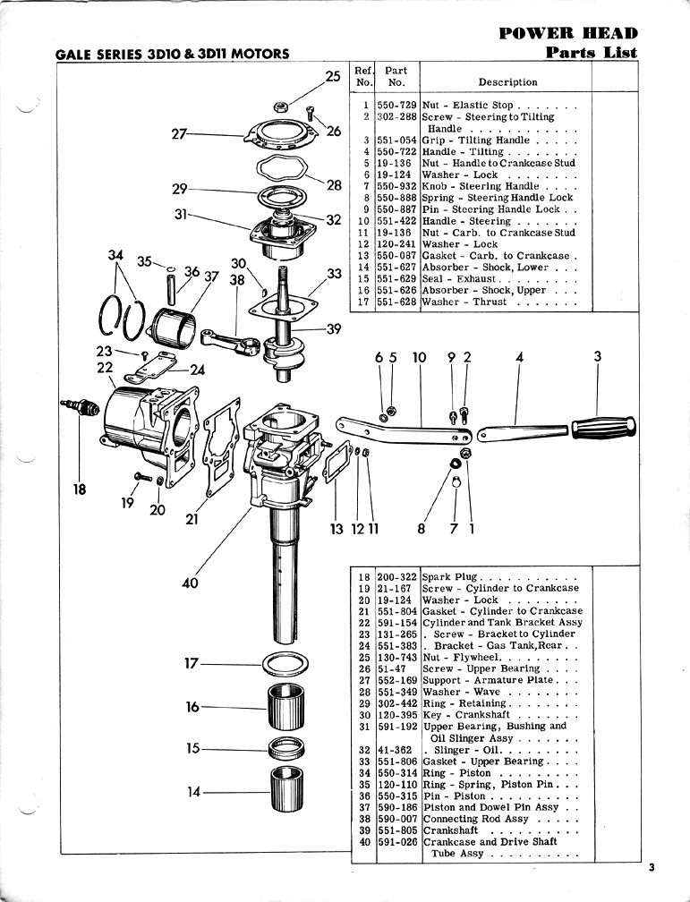

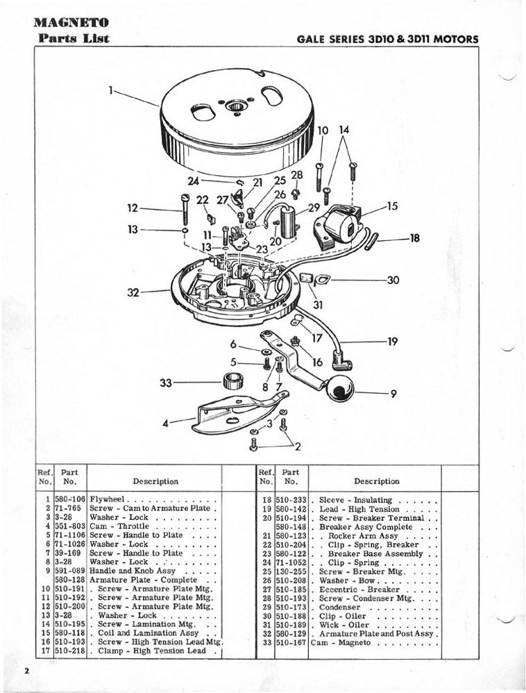

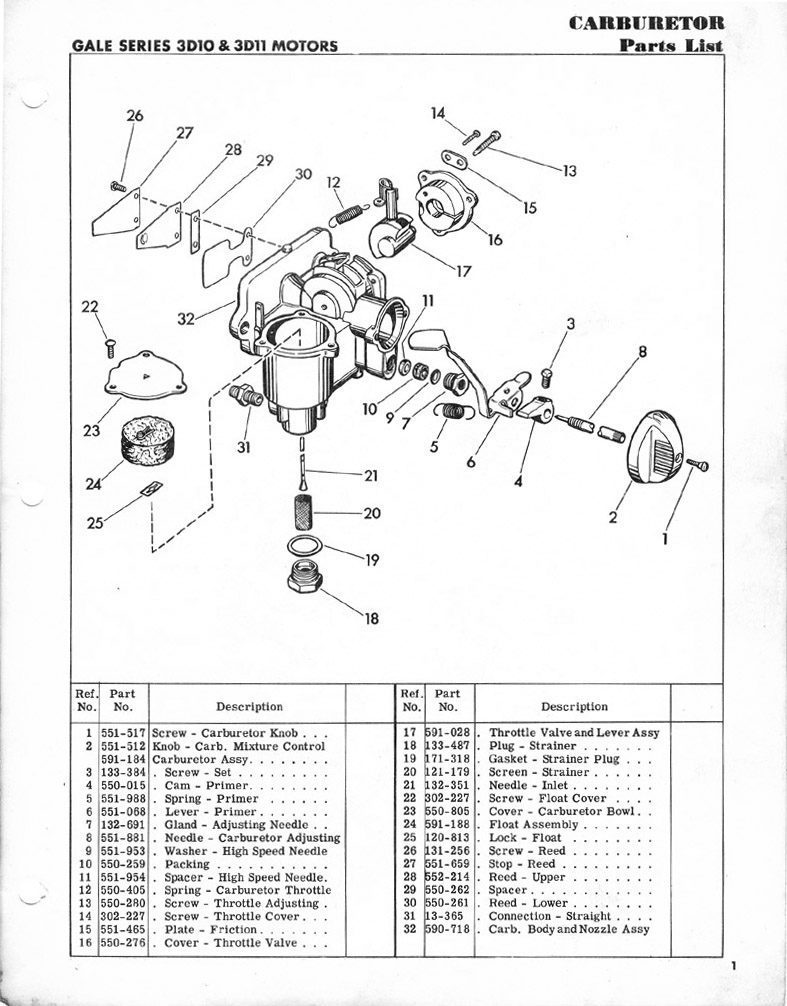

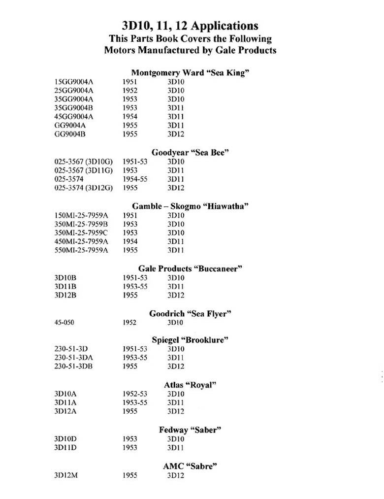

                  3D10-11-12-Applications
                  Pg-1-Carburetor
                  Pg-2-Magneto
                  Pg-3-Powerhead
                  #289827
                    Pg-4-Lower-Unit-and-Bracket
                    Pg-5-Trim-Group
                    Pg-6-Part-Number-Variations
