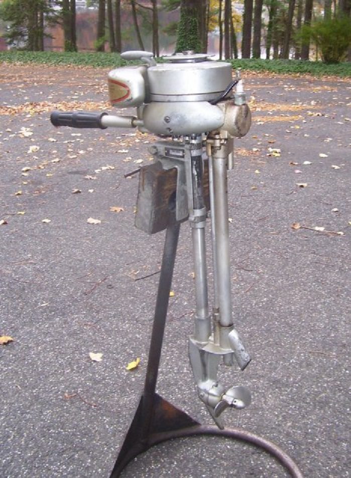

              #257622
                Is this like the motor you’re working on? Not my motor,
                just a photo I filed away.
                1946-Sea-King-Midget-Single
                #257685
