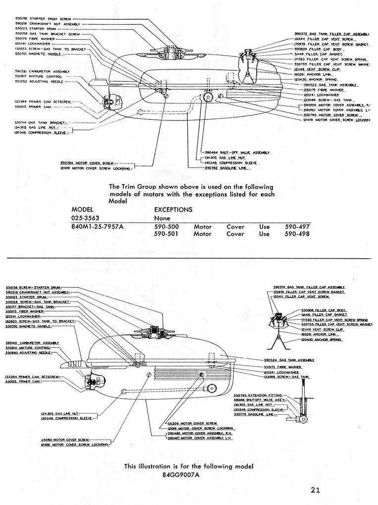

        I suppose a tank swap might be possible.  Anyhoo, the 84GG9007A (1948) did not have a recoil starter.
        Pg-21-Trim-Group

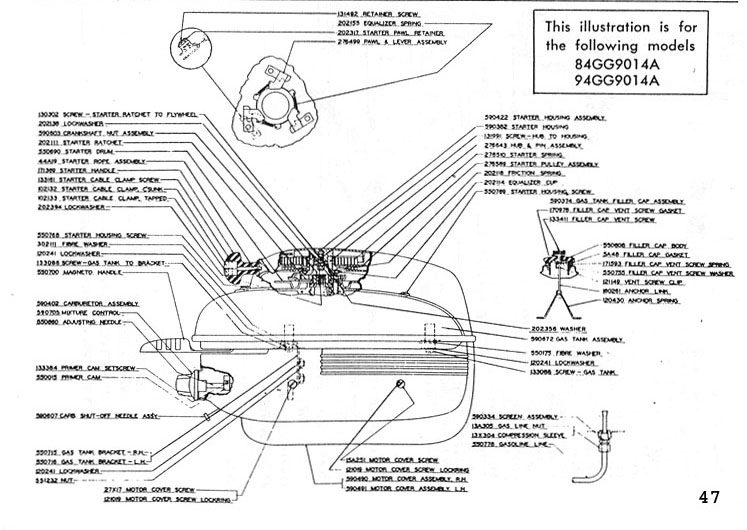

          A 1948 model 84GG9014A (5hp) did indeed have a recoil starter.
          Pg-47-Trim-Group

            Thank you Frank – Looks to me like a swap occurred sometime in the last 70 years or so.
