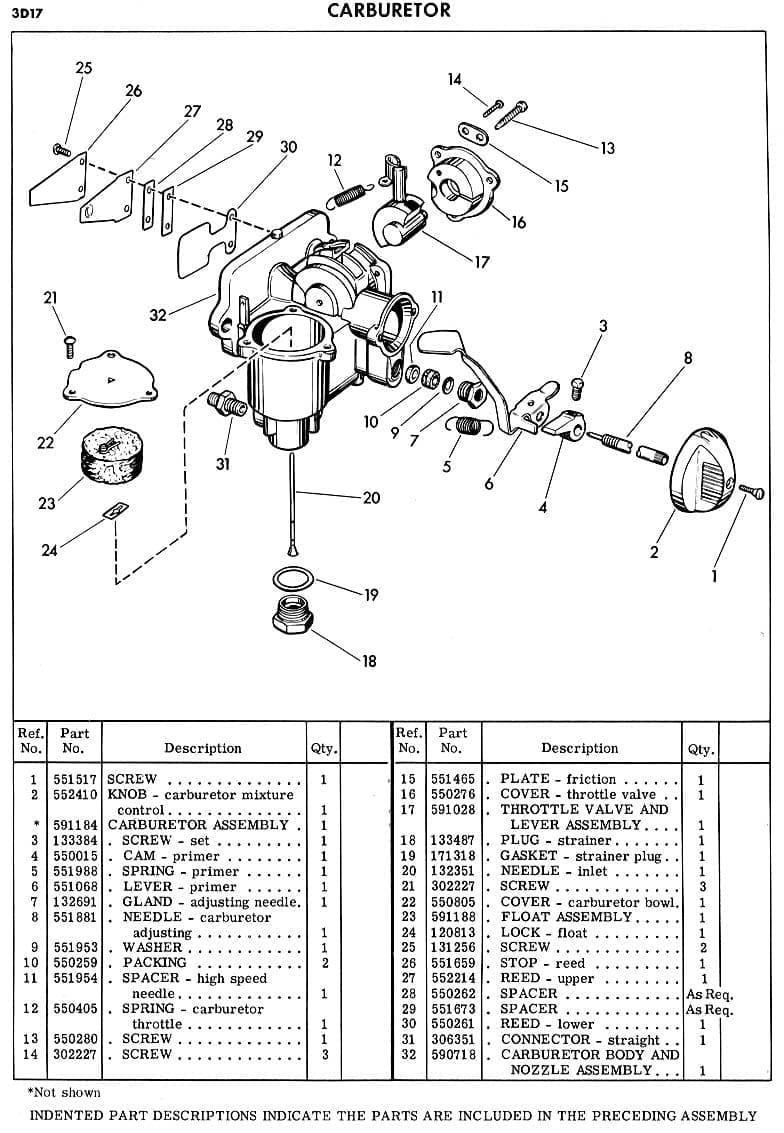

      I have a Sea King Single with a carburetor as shown in the diagram. The motor runs but it’s very difficult to start. The carburetor main needle has to be in a very narrow range, perhaps 5 degrees or so. I suspect the reed plate may be the issue, since I know the motor has been apart by… well… not an expert.
      It has a reed plate (#30) and a stop plate with a dimple (#28). It also has two different spacers, one thicker than the other. Can someone confirm whether the diagram is correct, or if there was a different version of this carb? Also, where are the two different spacers supposed to go?
      As currently assembled, there is no clearance between the reed plate and the dimple on the stop plate, even with the thicker spacer between them. Is the stop plate supposed to keep constant tension on the reed?

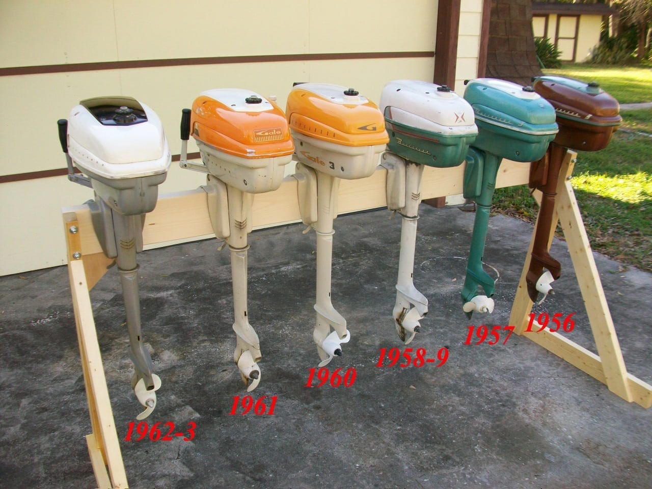

        Those things varied over the years. Here is 1961. Honestly, I forgot how you determine what “as required” is. Actually, I never worried about it much. They seem to work no matter what you do. The reed probably isn’t your hard start problem anyway.

          So I looked it up in the Gale Service Manual. It sez, “The reed tension is pre-established at the factory with special gages”. The word from here is put it back like you found it and get on with life.

            Thanks, Frank. I’ll look for that third plate, which seems to be in both versions of the diagram.
