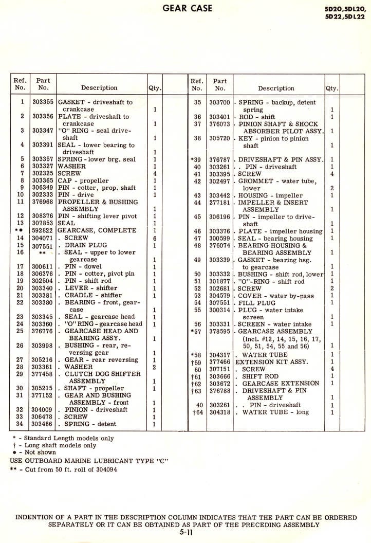

        NO thermostat on the Gale. Be sure to replace the cork gasket in mumbles’ picture. And the o-ring. Those parts keep water out of the crankcase. 303355 gasket and 303347 o-ring.

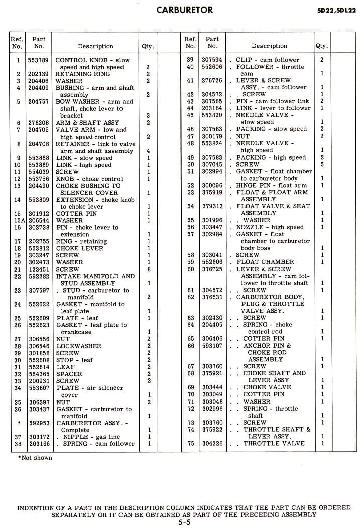

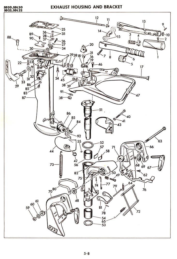

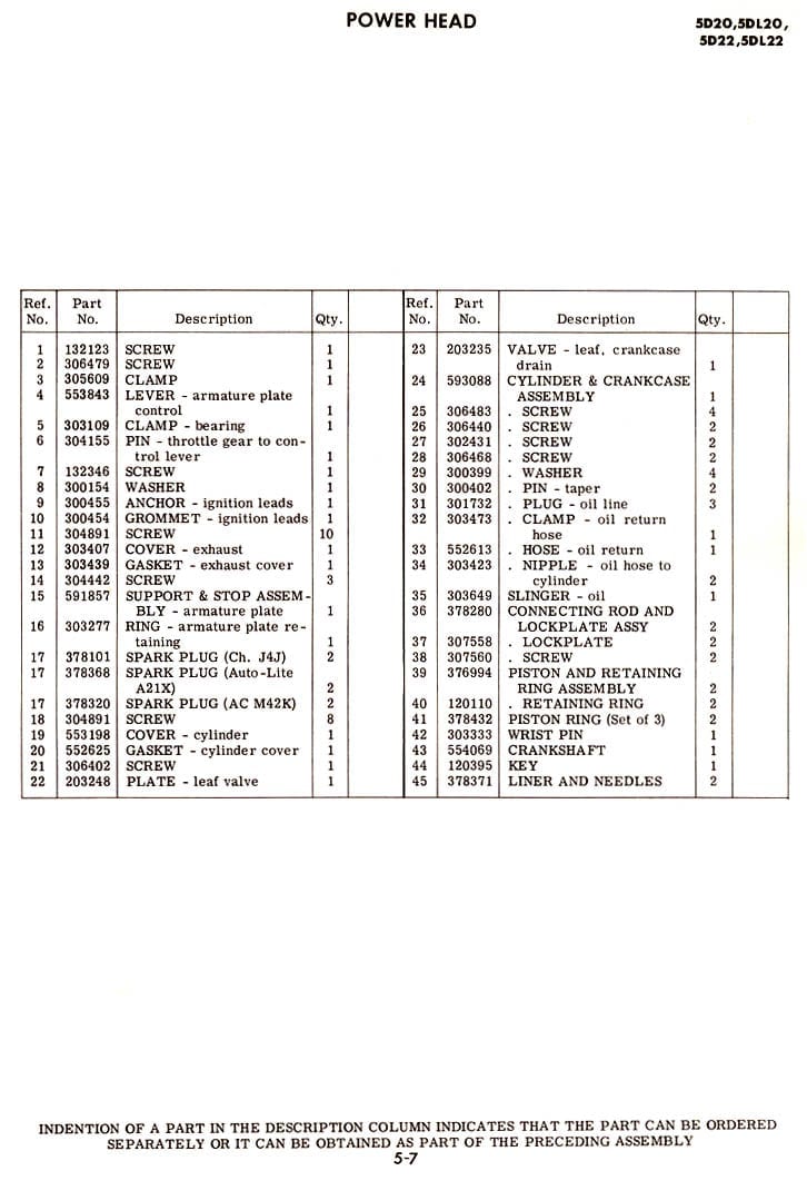

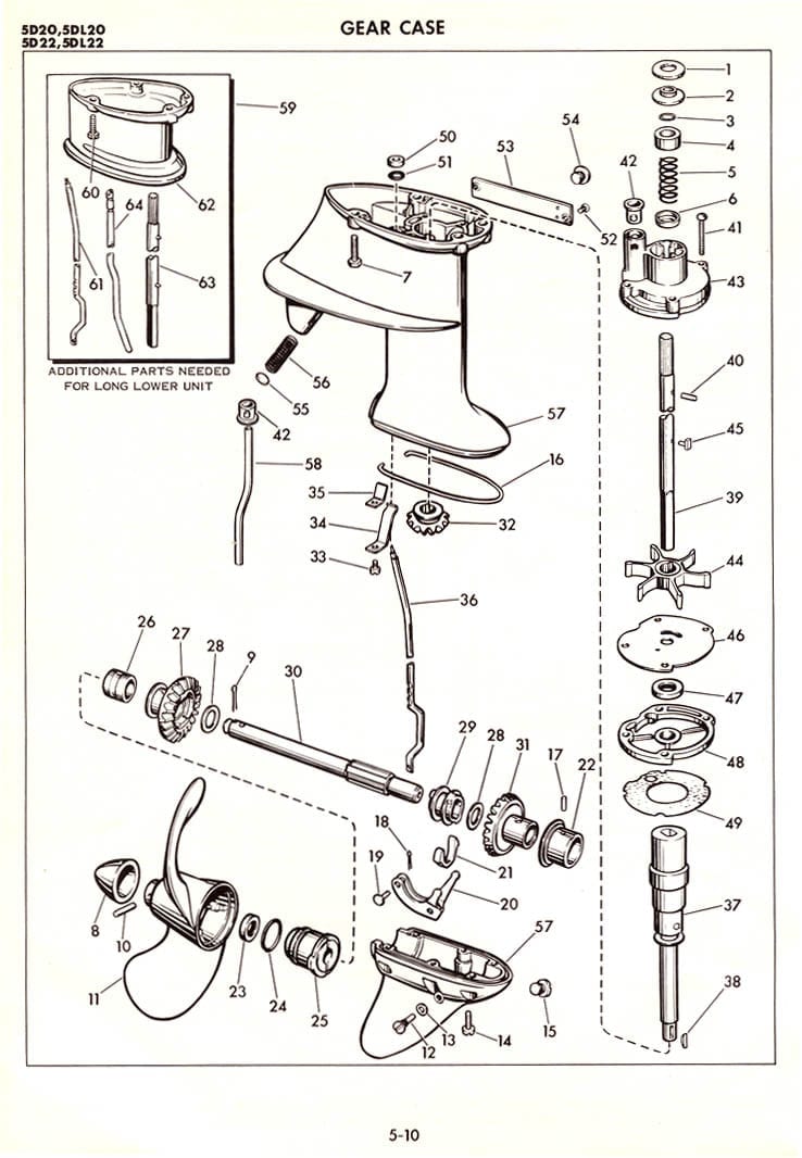

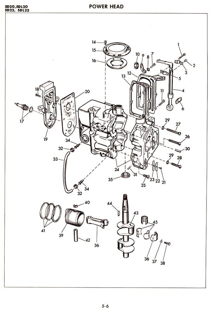

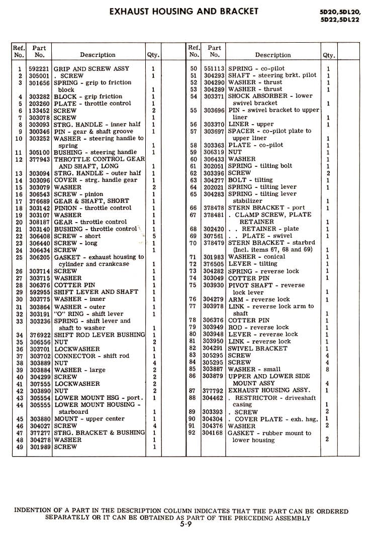

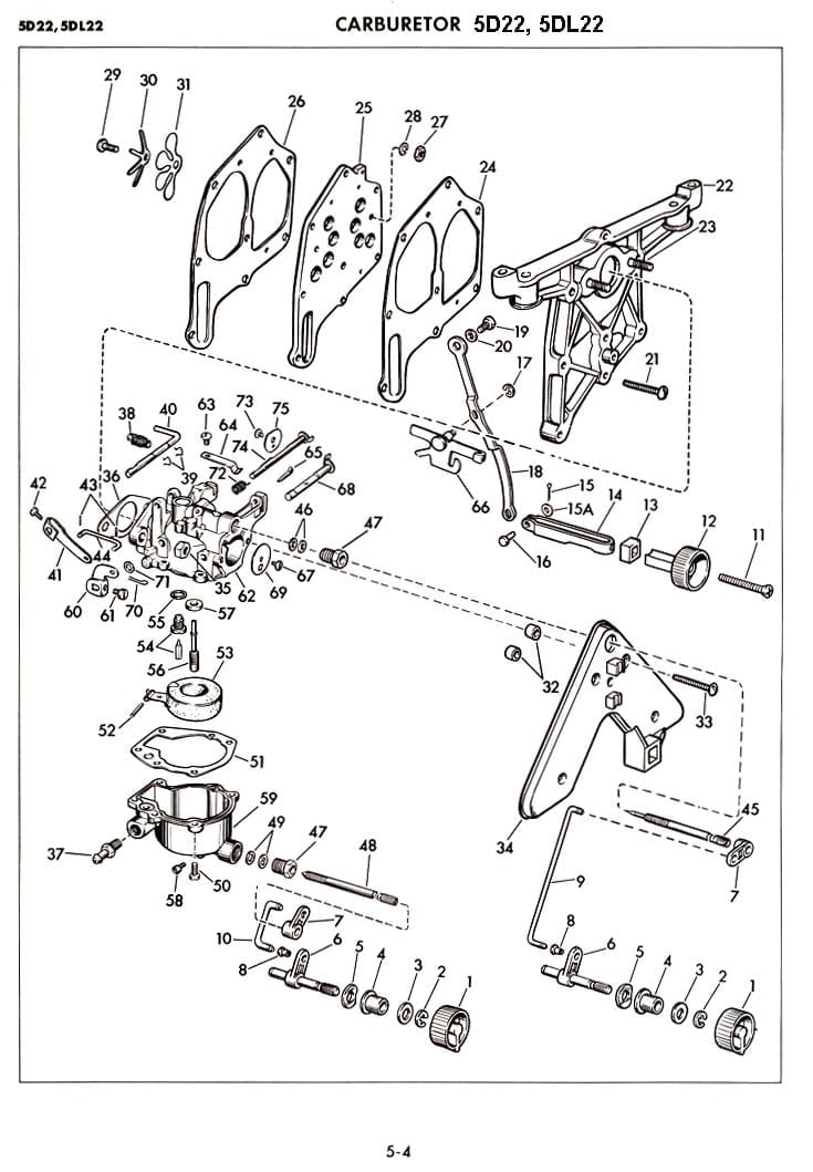

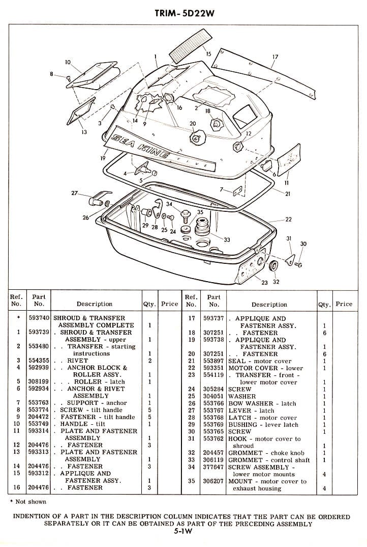

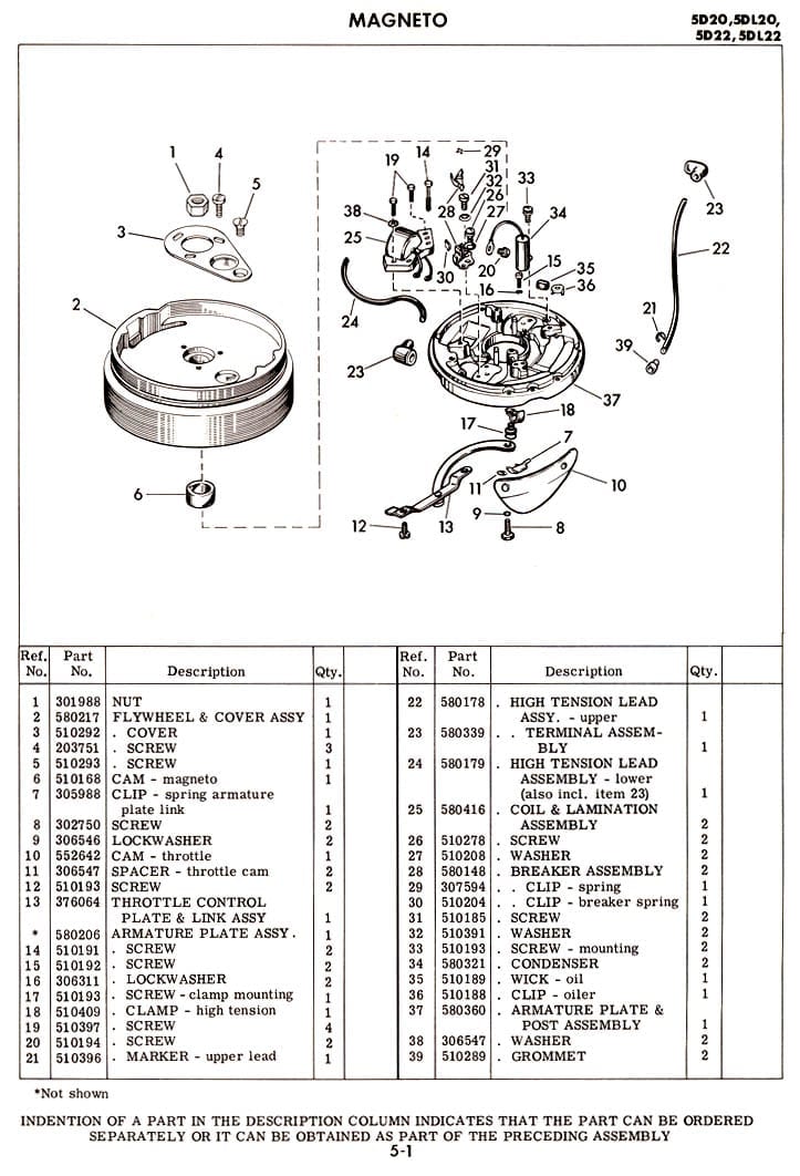

            Any Evinrude dealer, or several on-line, or several aomci members. That stuff is very common and used for years
            1.-Wards-Sea-King-Trim-Group
            5-1-Magneto
            5-4-Carburetor
            5-5-Carburetor-Parts-List

              More
              5-6-Powerhead
              5-7-Powerhead-Parts-List
              5-8-Exhaust-Housing-and-Bracket
              5-9-Exhaust-Housing-and-Bracket-Parts-List

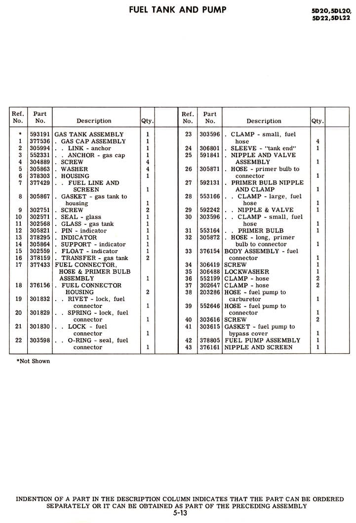

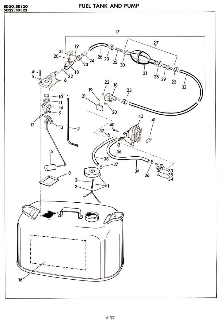

              #198532
                And more–
                5-10-Gearcase
                5-11-Gearcase-Parts-List
                5-12-Fuel-Tank-and-Pump
                5-13-Fuel-Tank-and-Pump-Parts-List

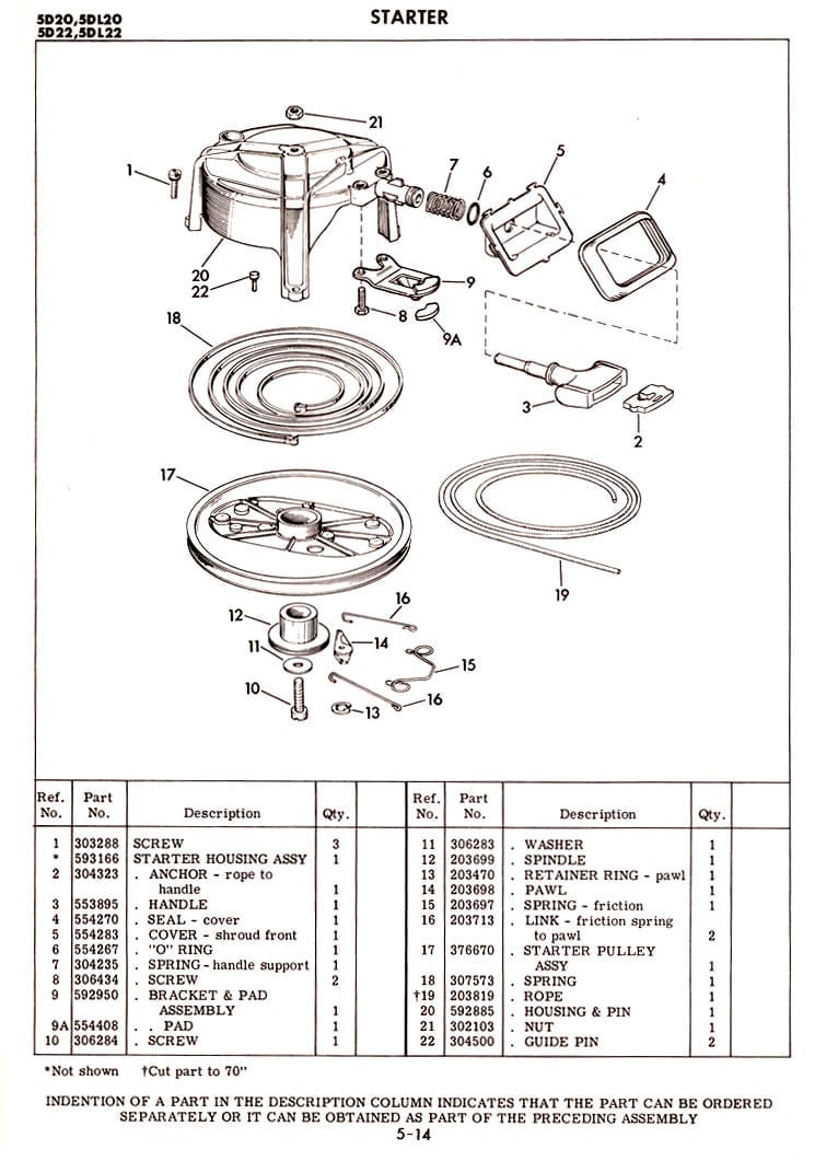

                #198538
                  Lastly–
                  5-14-Recoil-Starter
