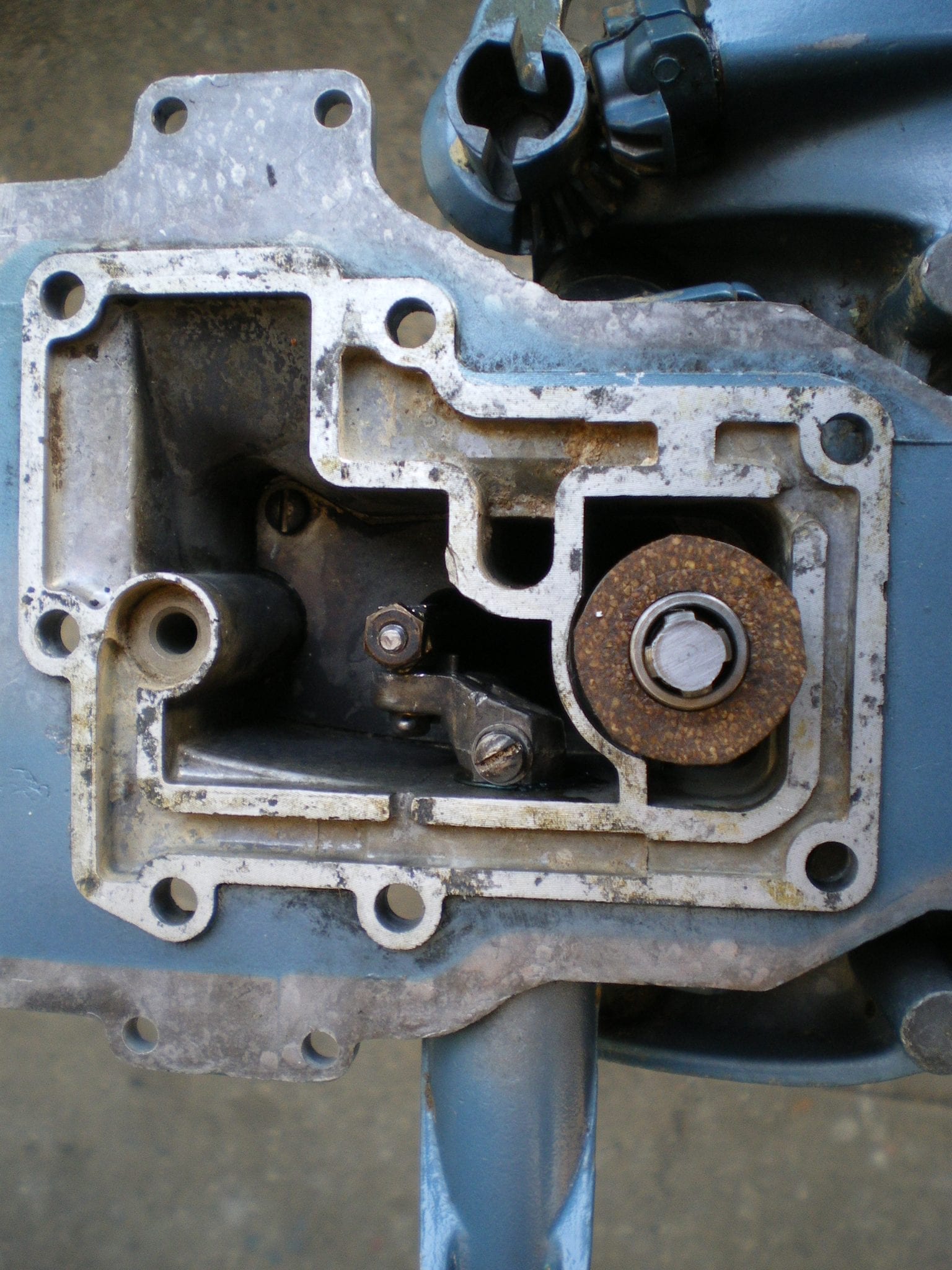

                    Here’s the layout of the seven screws and the two 3/8″ brass nuts holding the shift rod on. There will be a small lock washer between the nuts.
                    IMGP0411
                    #198500
                    AnotherSteve
