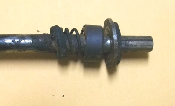

                #198627
                  Forcing you to remove the powerhead causes you to inspect the carbon seal assy, one of the biggest killers of the 5 / 5.5 / 7.5 motors. Of course people just slap it back together anyway, not realizing the importance.
                  #198656

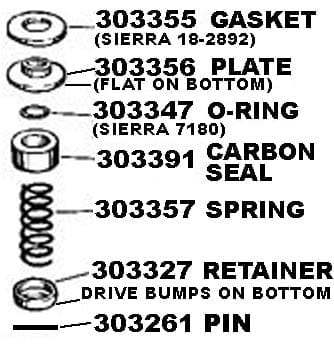

                  AnotherSteve
                    Is the big gasket the carbon seal?
                    Ah to be young and foolish again instead of old and still foolish.
                    #198657
                      The carbon seal assembly
                      5.5-Carbon-Seal
                      5hp-Carbon-seal
