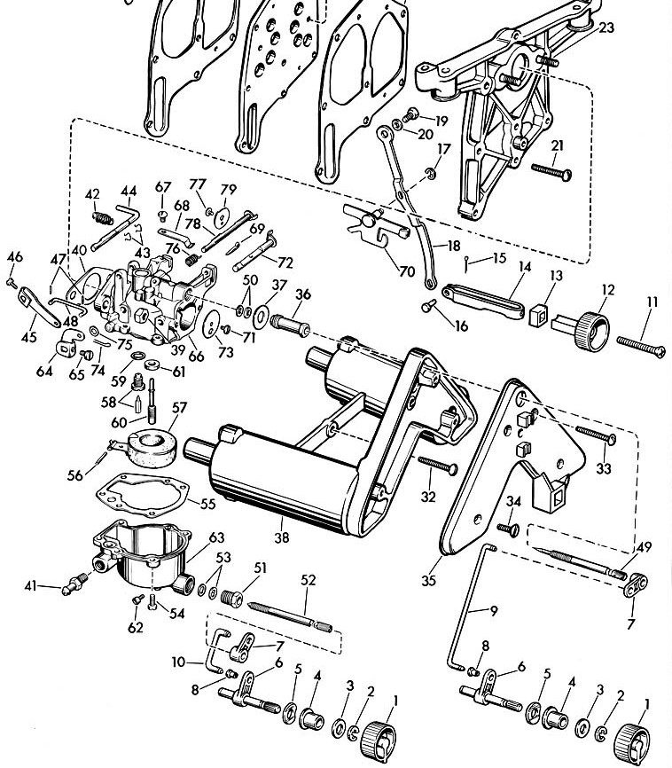

        Lessee if I can remember this correctly.  Remove the vertical throttle shaft from the side (makes it a lot easier to reassemble).  Disconnect the carb links 9 & 10 from the needle valves.  That stuff just snaps together.  Remove the choke knob.  Disconnect the fuel hose.  Now the powerhead should be ready to lift off, assuming you have all 7 screws removed.  Yes, it probably will destroy the gasket.

          Would you get a replacement gasket or just use “form-a-gasket”?

            You must be looking at a different parts list than I am.  If you are speaking of the water intake screen behind the prop, it would be indeed rare to need to remove it.  But if removal is needed the plug below it must be drilled and tapped and a screw used to yank it out.
