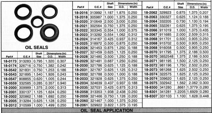

Well, BRP doesn’t include prop shaft seals for the bearing carrier in reseal kits. That makes a lot of sense, doesn’t it?
Anyway, the OD is fairly simple (1.62" – 1.625"), but the prop shaft size is 1.125". So do I want that size for the ID, or maybe 1.0625"?January 10, 2016 at 5:21 pm #29943What unit are you working?

January 10, 2016 at 5:53 pm #29945#330137 in this chart has the given dimensions but is it the correct seal? It’s best to check the P/N at M.E. to make sure you get the proper one.
January 10, 2016 at 7:13 pm #29948OK, here we go – the motor is an ’86’ Johnson 40hp with a bastard lower unit on it. I’ve spent at least a couple hours on ME trying to figure out what I’ve got, first to hopefully get the right 15" driveshaft and now for the seals. The bearing carrier has 4 bolts holding it in, the closest thing I’ve found so far is a ’78’ – 70hp. Believe it or not, just about everything else only has 3 bolts. I ordered an ’86’ – 40hp seal kit and it only had 3 bolts and the only 2 seals were only like 1 & 3/16". 2 possible Sierra numbers I came up with are 18-2060 and 2001 and it looks like the 18-2001 would work. But now I don’t want to wait for shipping and figure NAPA has about any seal I need. Of course when I went in there yesterday, they acted like a 1/4" thick seal was some kind of freak and would take forever to look up!! "A couple hours to look up" was their reply.
So anywhere I go to check on seals, given a shaft size of 1.125", any seal for it will be slightly smaller, so it seals, right? I don’t have to specify something like 1.0625, right? Guess I better figure the driveshaft seals too.
At this point, I don’t see why I need a $50 plus shipping, seal kit for 4 seals and a large Oring.January 10, 2016 at 9:57 pm #29959Beerman….I picked up a box full of NOS seals ….just let me know what number you need and i’ll search for it. All are brand new and most in original boxes..my prices are 50% of ME.COM …………J.M.
studenut8@gmail.comJanuary 10, 2016 at 11:03 pm #29963All right, thanks everyone. I think I found out it’s a 45hp L/U. At least it’s 4 bolt and all the seal sizes match up. That Sierra to OMC chart is right on the money. If Jerry has them, I’ll be good to go!
