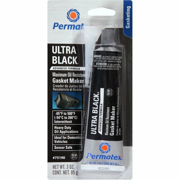

February 19, 2024 at 7:58 pm #285170February 19, 2024 at 9:07 pm #285174bf there are lots of good sealants out there. The last couple gear cases I had apart I used the ultra black that aquasonic recommended. I like it, these new sealants are impressive! To do a good job on a gear case takes some attention to detail. The shift rod seal is usually the culprit. The case needs to be totally torn down to change that seal. The seal under the water pump is not so easy to get out. Remember to put some sealant on the screw heads when reassembling. Those screws are on the grease side of the case edges where you put the sealant. You should have the gear case separated from the power head. If not turn the motor over on its rewind. There are alignment pins in both brass bearing. Those pins must be in the proper position for assembly to be correct.

February 19, 2024 at 11:14 pm #285181I’ve typically used the 3M847 but I tried the Permatex Ultra Black on my last reseal job. After that job, I doubt I’ll ever use the 3M again – the Ultra Black is a lot easier to work with and provides an effective seal.

Thanks for the heads up on the Ultra Black.
I didn’t know.

February 21, 2024 at 6:32 pm #285238thanks for the info. The really good thing about those products is they’re easy to get.

as to the ultra black, just smear a thin amount on the halves and assemble it or is there a trick ?
