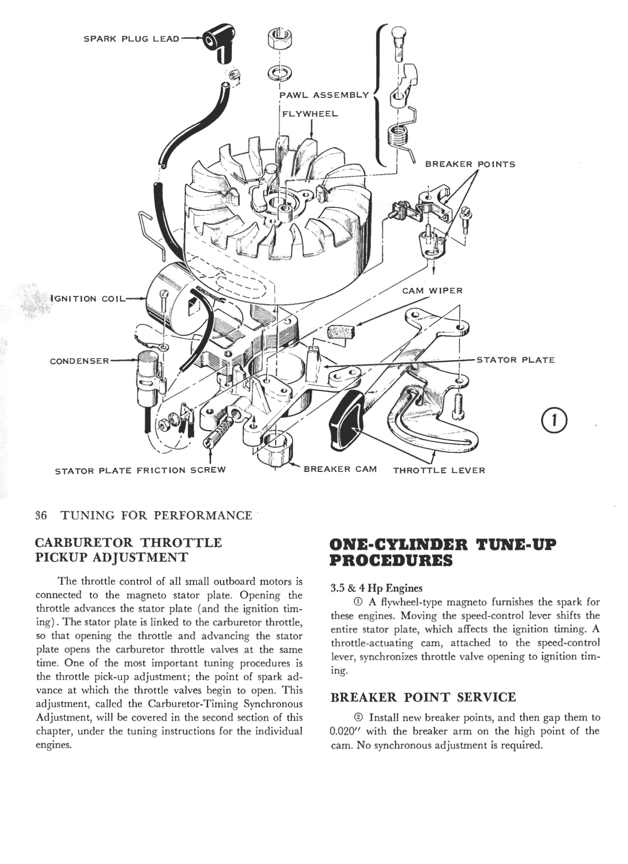

        This is about all I found, not sure of the year though, but probably very similar to yours.
        Sears-3.5-ignition
        Sears-3.5-carb-adj.
        #206129
        bill-m
          Thanks for the reply buccaneer. The diagrams you posted will be a great help and a good start. I did get the flywheel off and there is some surface rust on the inside of the flywheel and stator. What would be a good way to remove the rust? I wouldn’t want to damage these parts by using anything too harsh.

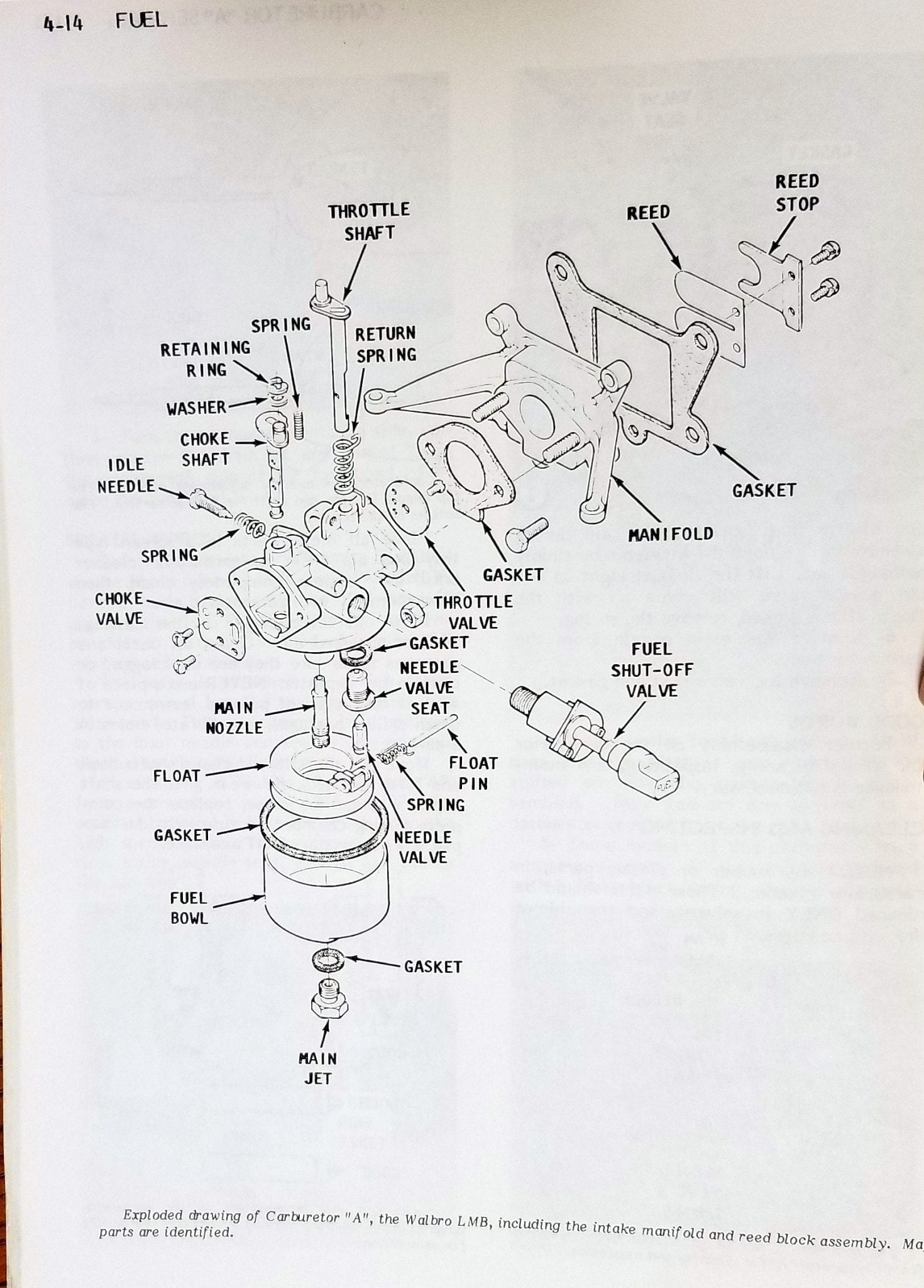

                Walbro_1
                Walbro_2
                Walbro_3
                Walbro_4
                Walbro_1

                #206184
                bill-m
                  Thanks again for the information on rust removal and a special thanks to Seakaye 12 for the carb pictures. They will be very helpful! When I first heard of this motor I posted pictures and received comments that this type won a “slow trolling” contest. I can’t wait to get this motor on the lake and see how slow I can go.
