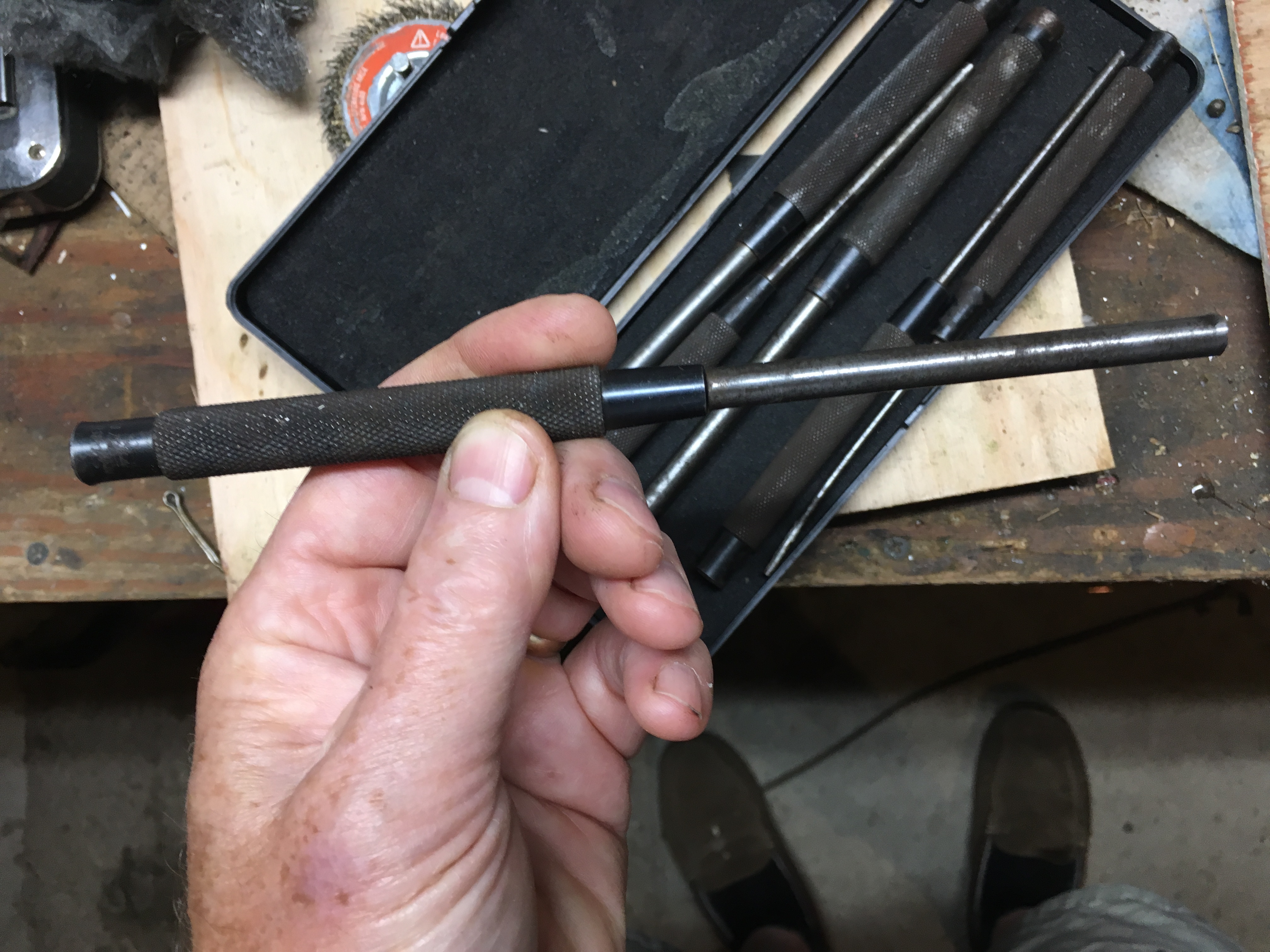

          david-bartlett
            Bill,
            What I use first is a Starrett 5/16” pin punch. It fits through the casting but not the bushing.
