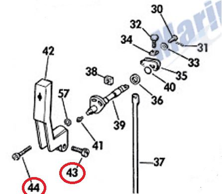

      How to adjust shifter rod on 1966 20 hp johnson outboard

          The two screws, #43 and #44, must be loosened, not removed to adjust the lever for equal travel in both forward and reverse. If you get carried away and remove the shift lever, note the star lock washer #57, goes between the shift lever and the shift shaft, #39, and not under the square nut, #38.
          1966-FD-Shifter
