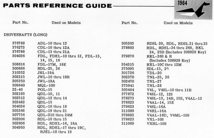

      #240842
        This is from the 1964 book. Sorry, I do not have 1965-up. I’ll leave the legwork up to you to convert to Evinrude models
        DS-long

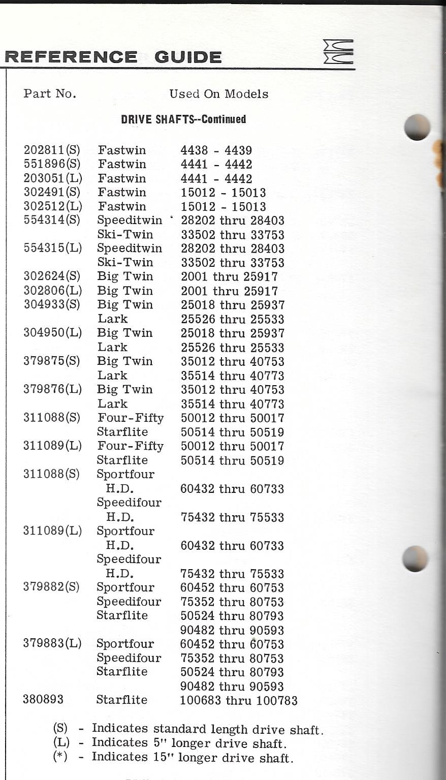

        #240909
        MIKE SIMS
          Save the legwork, here is the Evinrude list from the ’67 quick reference guide.
          driveshafts
