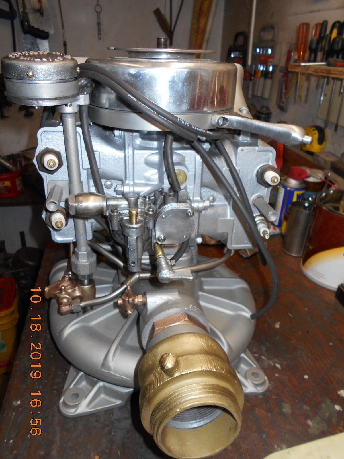

      In researching what spark plugs I should use for the 1937 Evinrude Imperial
      Lightfour “high pressure” pump motor, I find Champion M5, which
      I believe matches up to Champion D9 (509).
      I was just wondering if there’s any 18 mm “Shorty” plugs out there?
      The front engine cover comes awlful close to the current old plugs.
      Thanks.
      DSCN8224-1
      #185631
        I see you have the wrong nut on the lower spark plug on the port side. Use the short knurled nuts and you won’t have any problems.

          Garry, I’ve ordered some Champion D9’s, and will check them for length
          when the come, and use the knurled nuts, if the thread fits.

            Newer plugs are longer than the originals. Best to use knurled nuts on old plugs. On my PO-15 I used modern plugs and then wrapped the tops with electrical tape. Rubber boots were an option, but I didn’t want to change the original rajah terminals since the wires were in nice condition.

                the AC 82M plug has a short insulator on it. They used them in the 1929 Elto Lightweight. Short insulator plu will fit inside the spark plug cover on the Elto.
