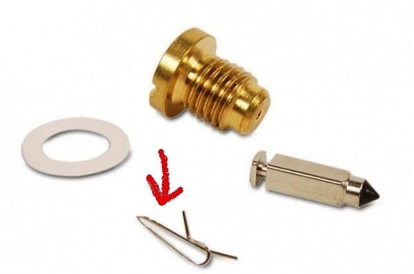

      The parts list for my RDE-17 does not show a carb needle clip.
      Should I use the carb needle clip anyways?
      carb-needle-clip
      #207948
      mercuryman
        Yes its a improvement needle can’t stick
        #207957
          Definitely use the clip.
          1982 Evinrude 25hp
          #207969
          Phil Budne
            The needle with the rubber tip is stickier than the plain metal ones, so the clip is good insurance.
