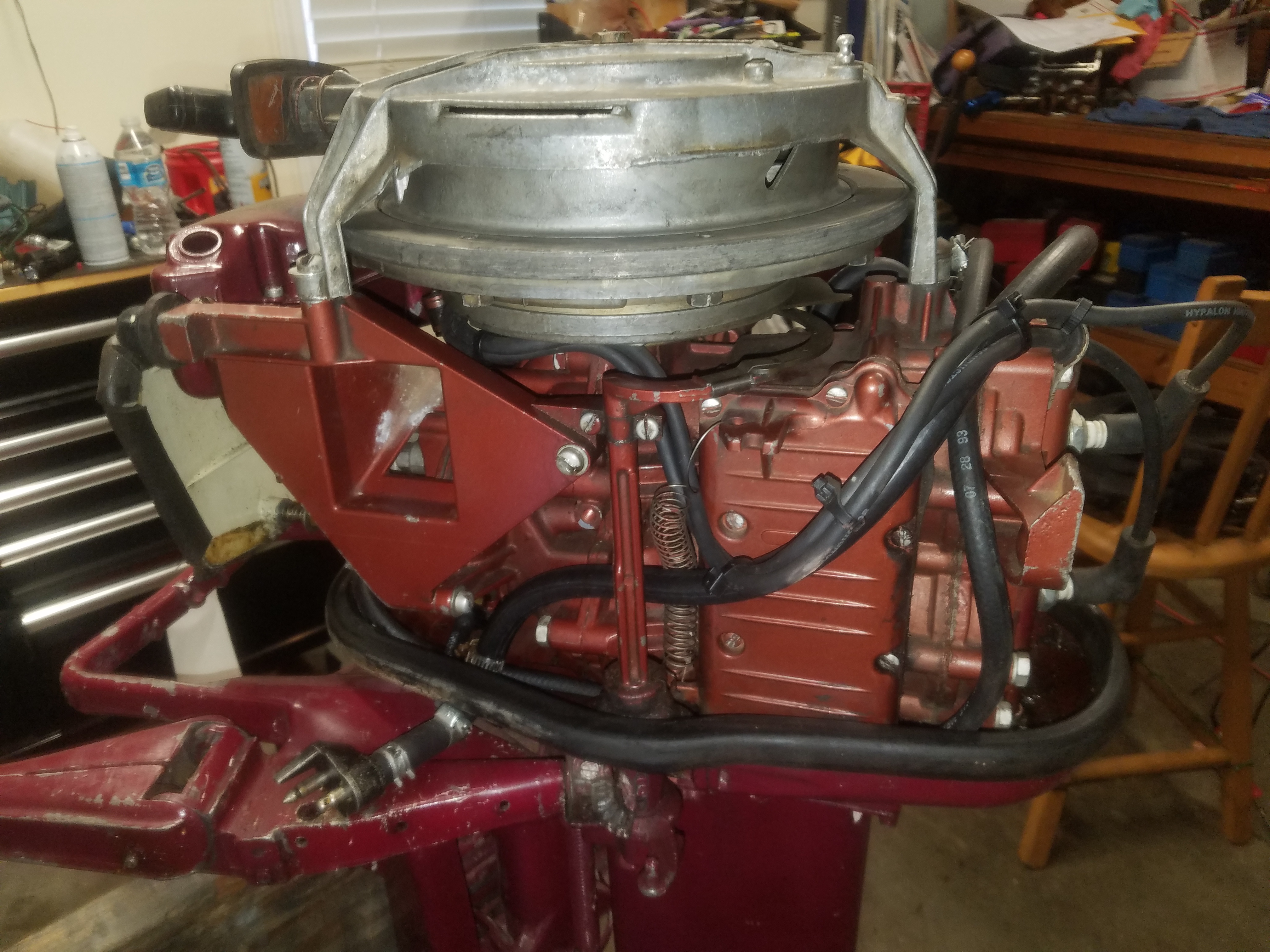

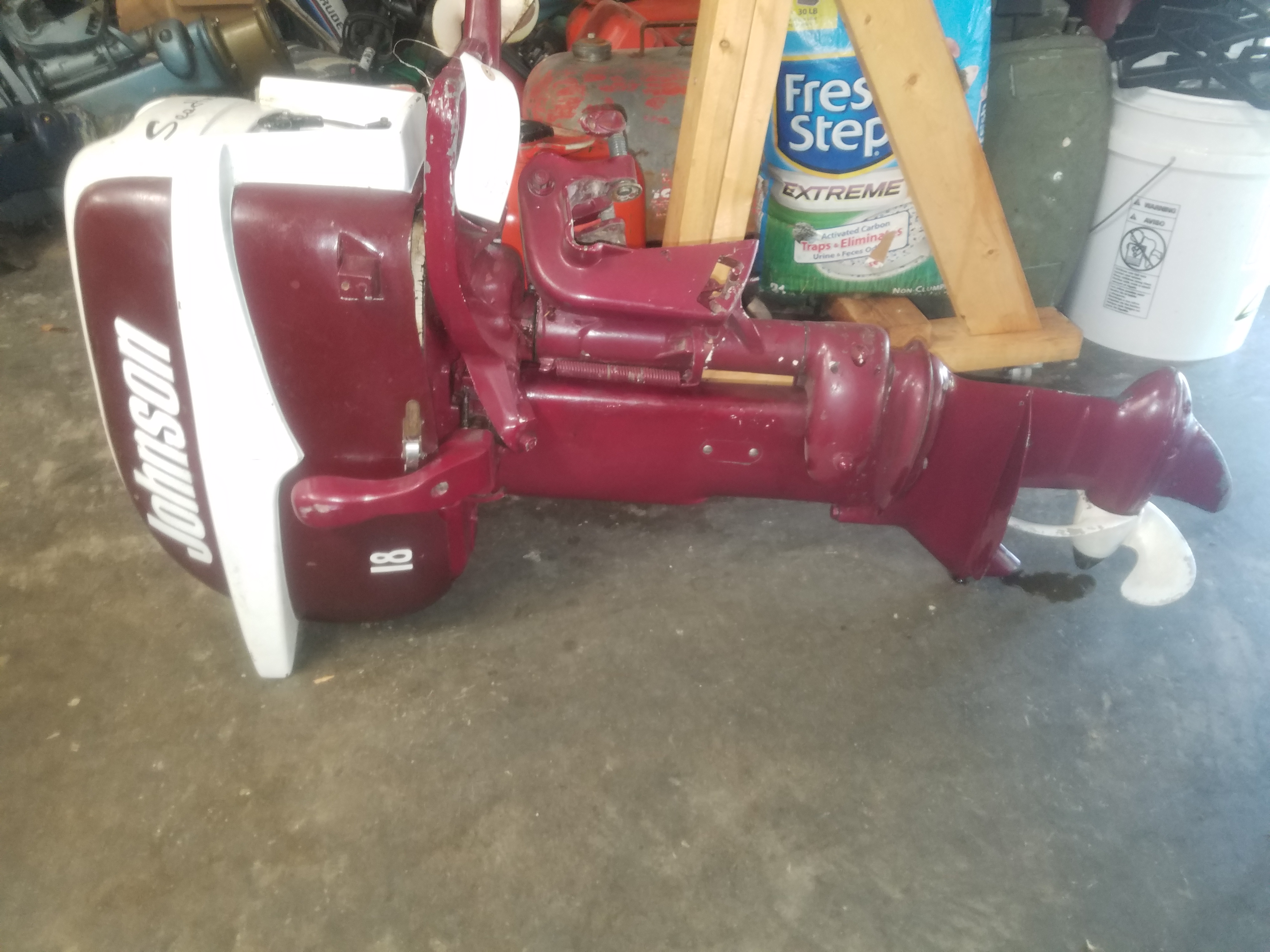

      A cousin I had never met before dropped his 18 horse Johnson off with me this morning. He said it popping out of gear when under full power in FWD. Anyway, it’s a 1954 model according to the tag. I thought they were green in 54 and 55. It definitely has been painted. Maybe they liked Holiday Bronze(ish) better.
      With it popping out of FWD pretty safe to assume the clutch dog?
      #77076
        Whatever it is, it isn’t a 1954. Probably has undergone a data plate replacement.
        #77079
        bullie
          Hmmmm. Ok. It may just have the bracket from a 1954. I am out of knowledge when we leave colors. LOL Do you think it is a later model 18?

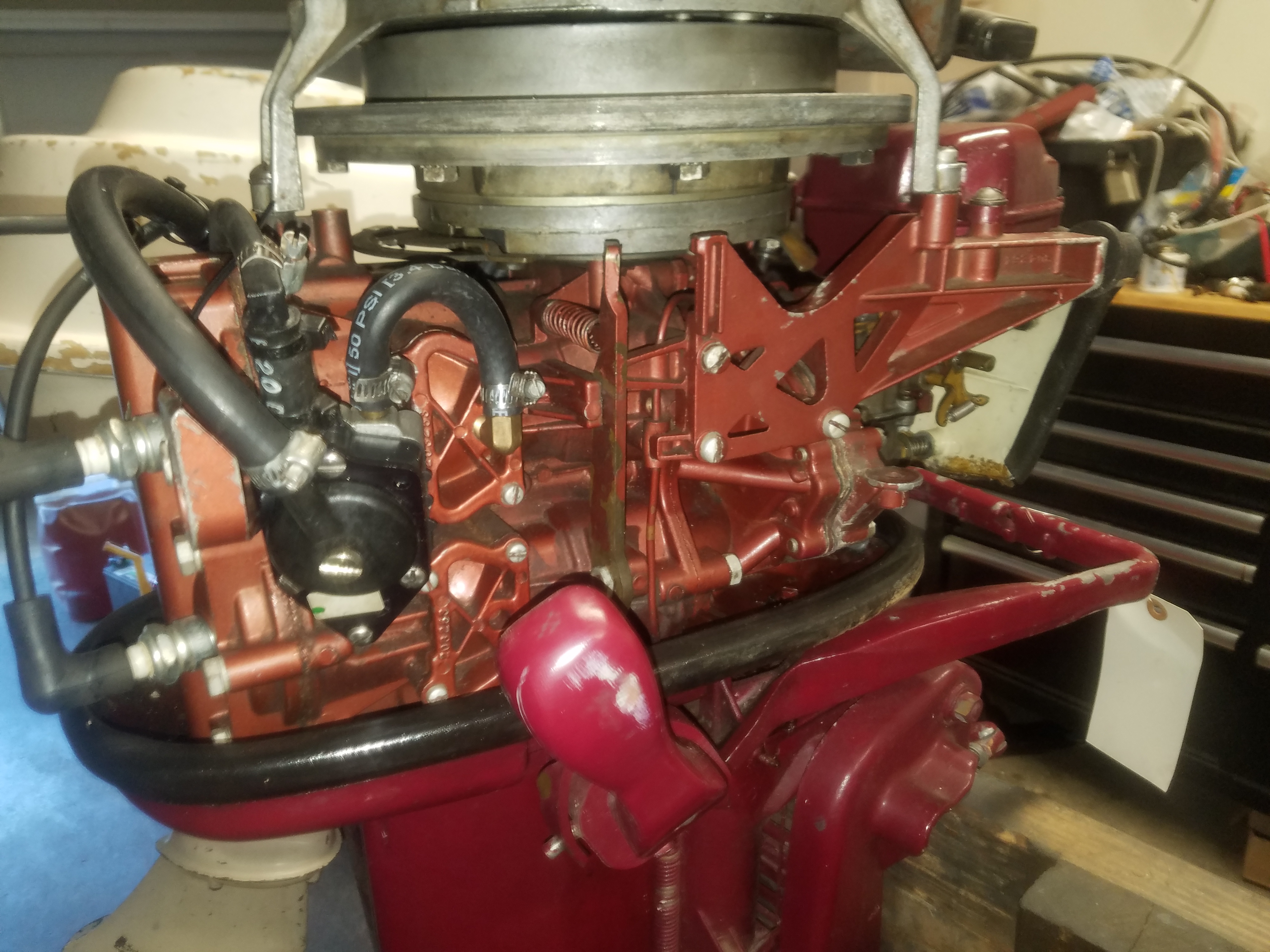

          david-bartlett
            A few more picks of the front and under the hood would help.

                rco
                  1956 would be an FD-10 15 hp, 57 would be a FD-11 18 horse. There was not a 54 or 55 FD model.

                    Steve D
                      That style exhaust cover and no side mounted sediment bowl…’56 15 HP FD-10. Here’s a manual for it.
                      #77129
                      bullie
                        That’s exactly what it is Steve. I don’t know how I got my wires crossed yesterday. Maybe I fat fingered google. The new cousin told me it was a 54 and maybe I fat fingered Google on my phone. I saw something that was a 54 also. But, now that I have it in my garage and get a good look at it, the tag reads FD-10.
