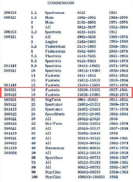

              Steve D
                Re: Confusion….I always wondered what the difference was between the ’61 and ’62 and up 18 HP motors that would require them to use the higher capacity condensers…
                Condensers2-1
                • This reply was modified 7 years, 2 months ago by Steve D.
                #161425
                  I had recently wondered the same thing about Fastwins. I did notice that the earlier Fastwins that called for the 580321, came originally with a thicker coil lamination stack, than the later ones. Why the later models would require a higher capacity condenser with a thinner lamination stack is way above my pay grade.
