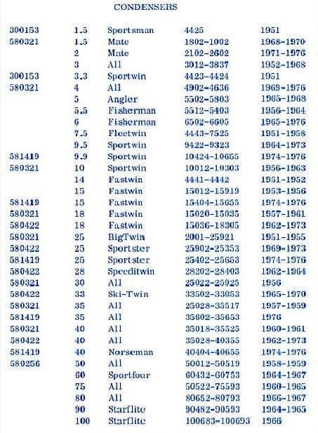

          #161272
            581419 is for the Lo-Tension Magneto. Capacity is 0.25-0.29 mfd. There is another number out there that I had in mind.
            #161274
              The other number I had in mind was 580422, used in various 33-40hp motors of the 1960-1970 era, replaced by 581419. Still confused.
              #161275
                From 1976 Evinrude where-used
                Condensers
