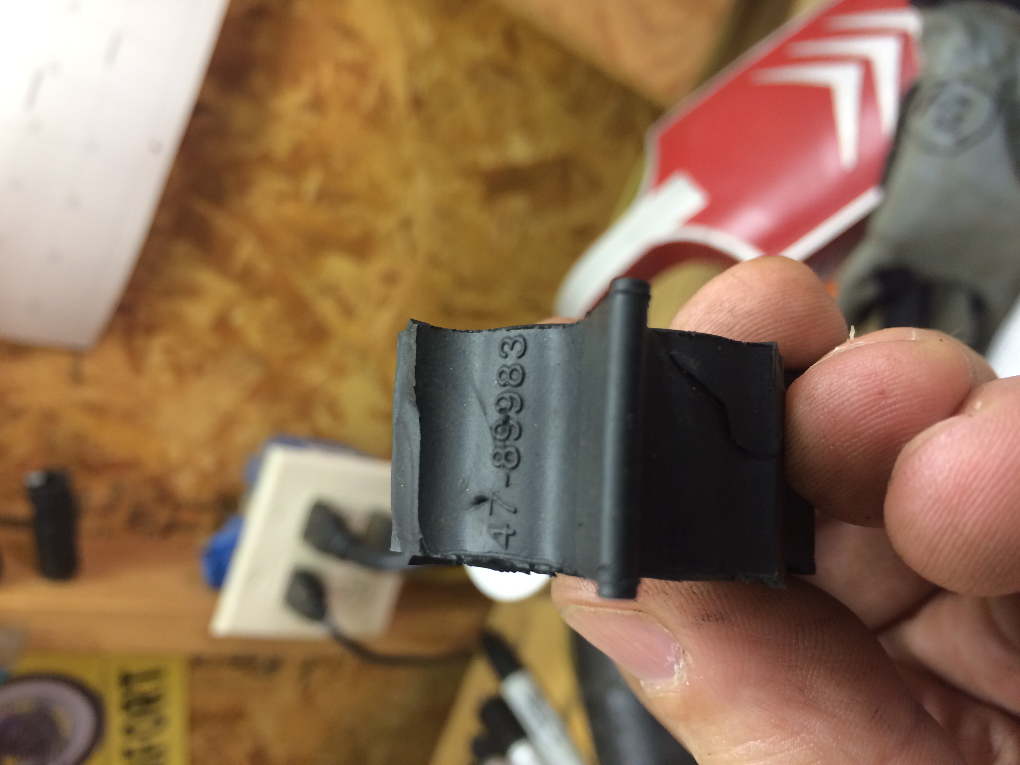

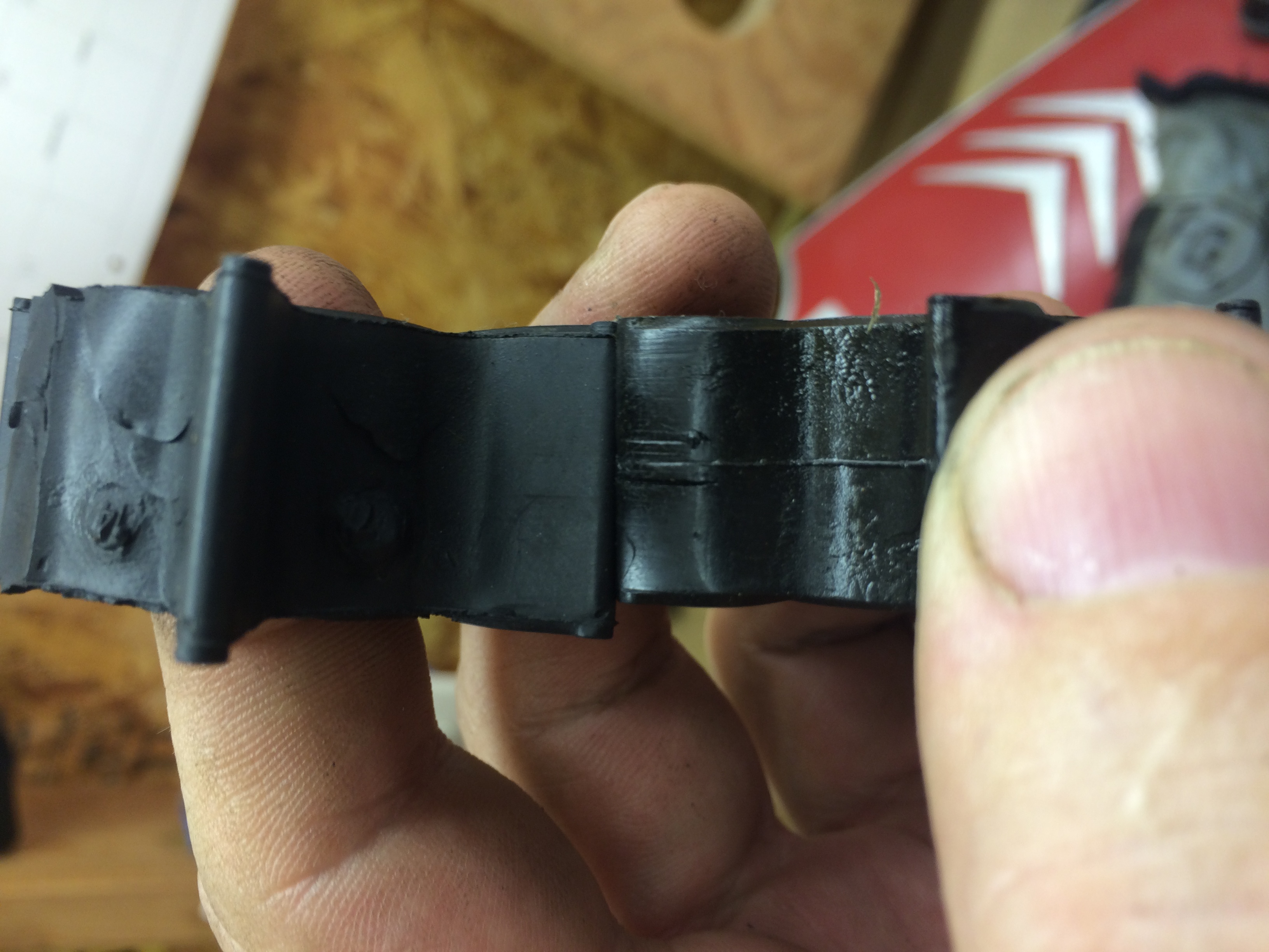

              Exactly why I don’t buy Sierra parts. Impeller for a 4cyl Mark55a and others Single pic is a Sierra impeller #47-89982 double pic has the factory merc impeller #47-89982 which as you see the Sierra is roughly 1/8" thicker!! Get out the sledge.

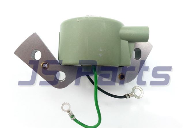

                I’ve used a lot of Sierra parts and most of them work OK, but I have had to pry hard with a big screwdriver to get those coil mounting holes to line up and force the laminations back far enough so they don’t rub; but I’ve gotten so I can do this pretty fast so I still use them. I use a lot of their impellers, but not for the low profile 9.9 and 15 Johnsons of the 1980s and early 1990s – their impellers, even with their new housings did not cool at a very slow trolling idle….in three different motors. The other thing I found was when I got a lower unit seal kit for a 1996 Mercruiser 4.3 liter V6 out-drive, the two seals for the driveshaft were not different OD like was needed, and when I got the Mercury kit, I found Mercury had made a revision, mounting these two seals in a slick, angled carrier to keep them from dislodging (as one of my original ones did) – Sierra did not have this modification.

                  That’s the worse misfit I’ve seen yet! The bad Sierra/OMC impellers are only a few thou too thick and can be sanded down to fit.
                  Quick coil question, has anyone used the riveted aftermarket coils and how do they fit compared to the stamped ones?
