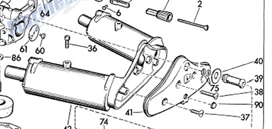

      anyone know the exact size/length of the silencer screws / bolts holding the silencer to the carb see#38 in diagram

        I measured one of mine as a 10-24 with a thread length of 1".

        ADAM GIBB
          The screws are oval head. Availabe at the Boathouse in Dorval. I don’t think Reno / HD have them.

            Thanks Adam, I tried a few but the thread size was giving me a bad feeling with some of my bolts ( seemed loose ).
            the stainless steel bolt bin at CT has oval head bolts but it is the thread size I needed .
            BTW silencer fits perfectly 🙂

              #85188
                😳 thanks BobW
                for some reason I hadn’t read your reply when I also found the answer… 10/24 1 inch long oval head
