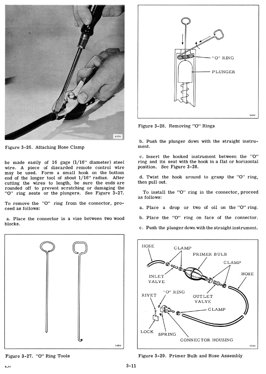

Thank you,September 26, 2018 at 7:49 pm #83566if the oring is just… out of place why not try to just reposition it ….push down on the plunger with a flat nail head to free up the oring and try to pop it back in place then release the plunger

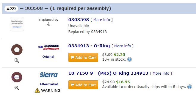

September 26, 2018 at 8:23 pm #83567If we dare assume it is an OEM OMC connector, the o-ring is part number 303598. Snag the old one with a home made wire hook and drag it out. Squeeze the new one double and slide it in & straighten it out.

September 26, 2018 at 11:13 pm #83574When I was a kid, my dad used a ball point pen to install the new O-ring in those. It’s blunt tip won’t damage the O-ring so easily.

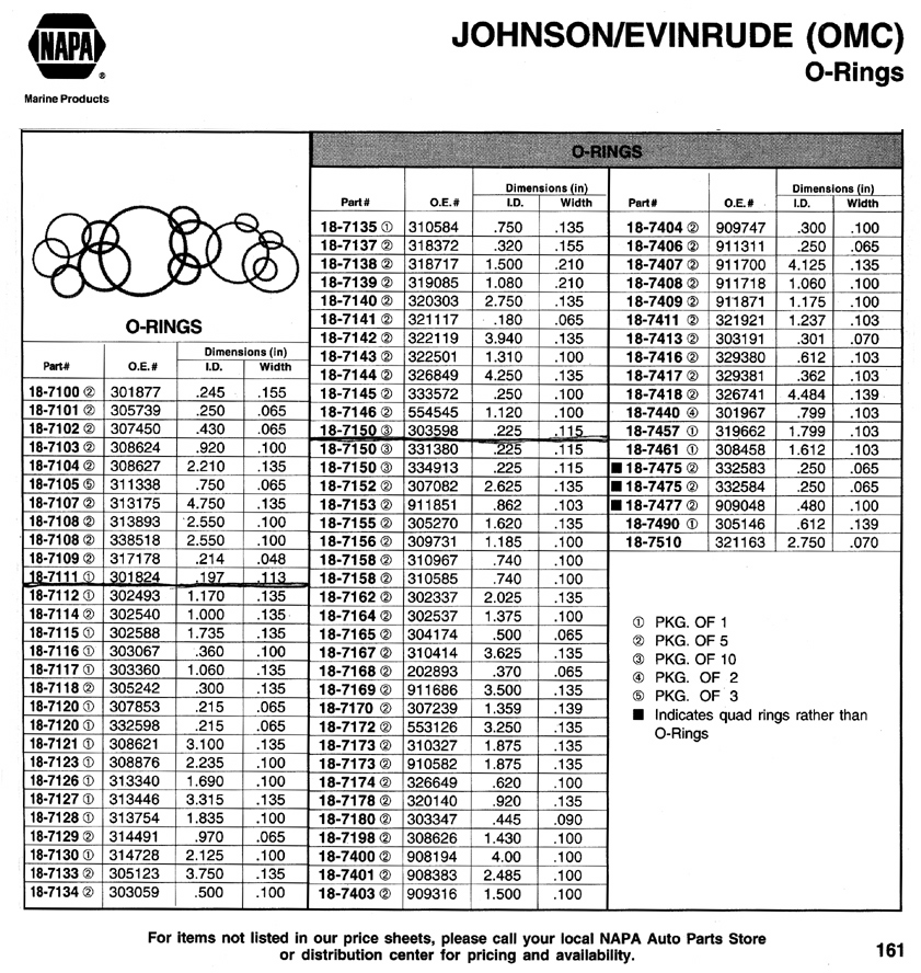

October 1, 2018 at 5:22 am #83789Having read this and other threads, I’m still confused. Want to replace the o rings in some leaky fuel line connectors. Probably also need to replace some valve o rings in the tanks. Can anybody provide a standard number for these? I don’t want to pay several dollars for an o ring that should cost several cents.
The most common o ring sizing standard is AS568, the US Aerospace Size Standard for O-rings ( I think it used to be AN). I would think OMC would have designed around standard sizes. There is a chart of standards sizes here: http://www.applerubber.com/src/pdf/as56 … -rings.pdf

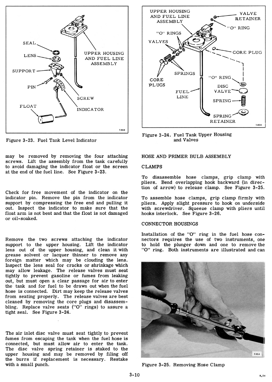

October 1, 2018 at 11:53 am #83793Yes, there were two sizes of the tiny o-ring around the pin on the tank outlet (behind the brass retainer washer). As I sort of remember, if the hose connector goes on vertically, it is the early, small version, but if it goes on horizontally, it is the later, larger version. But I could be all wet.

October 1, 2018 at 12:20 pm #83794Here’s some charts showing OEM numbers and sizes.
