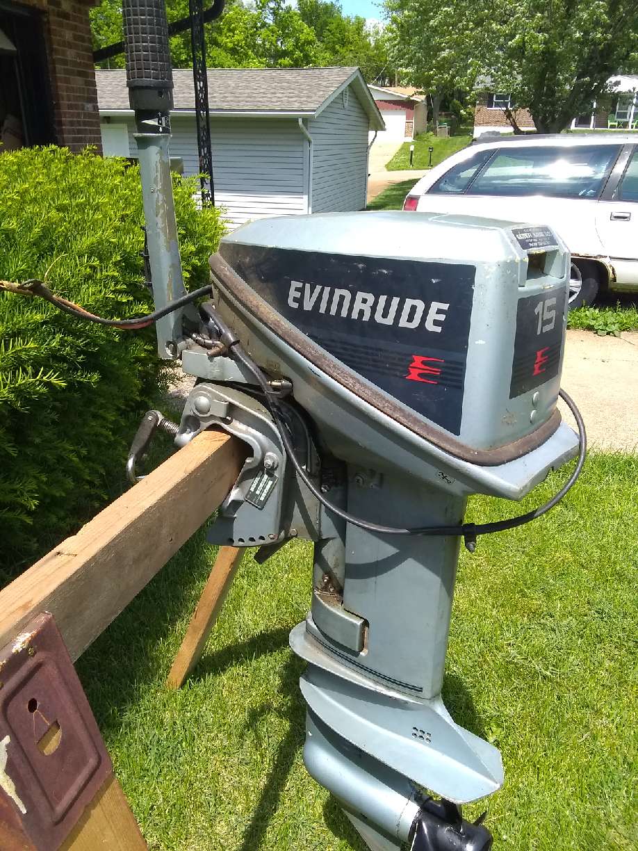

            Tinman
              Thanks everyone for the input. It’s a short shaft, freshwater motor. Going to look at it this weekend. Owner says he went to a larger motor for his boat. Been in garage for a few years, taking up space. I will check it out good. Included is a pic. Thanks.
              IMG_6020
              #206125
                Just based on it being a fresh water motor and the picture you posted, it is a bargain, unless the powerhead and gearcase are trashed…. You can always resell it, or its parts, for much more than $100 if you don’t like it once you get to working on it….

                David Stanton
                  I have five of these 15s with mega-hours on them from a failed resort, ranging from the late 1970s to 1991. I have the newest three running great (1989-1991), and have gotten the older two to start. Sometime in the late 1980s, tuned exhaust was added to get the output up to 15 HP measured at the propshaft to compete with the foreign brands – not sure what year it was added, but my 1989 has it, and I can tell from the photo that your 1986 does not. The only difference between the 15s and the 9.9s is the carb. I fixed a 9.9 for a neighbor that wouldn’t idle right no matter what i did, and switching to NGK spark plugs magically cured that. I have not seen that problem with any of my 15s. Not sure what year they went to throttle cables from the tiller, instead of the traditional rod/rear mechanical tiller that was known to wear out on these models with a lot of use. The only thing I’ve found that is a bit dicey to remove and repair is the recoil starter assembly – if you take it off for any reason, have a nut ready to put on the bottom of the long mounting bolt to hold the whole thing together – if I remember right, it’s a 3/8-16. I found the SIerra impellers , even with a new Sierra housing, don’t cool at slow idle, but OEM impellers work fine. Electric start is rare on these. For $100, I’d grab it!
                        How is it you can tell this engine does not have the open megaphone by the picture? This 1986 15hp should have the open megaphone, but I am judging its year and HP merely by the engine cover….
