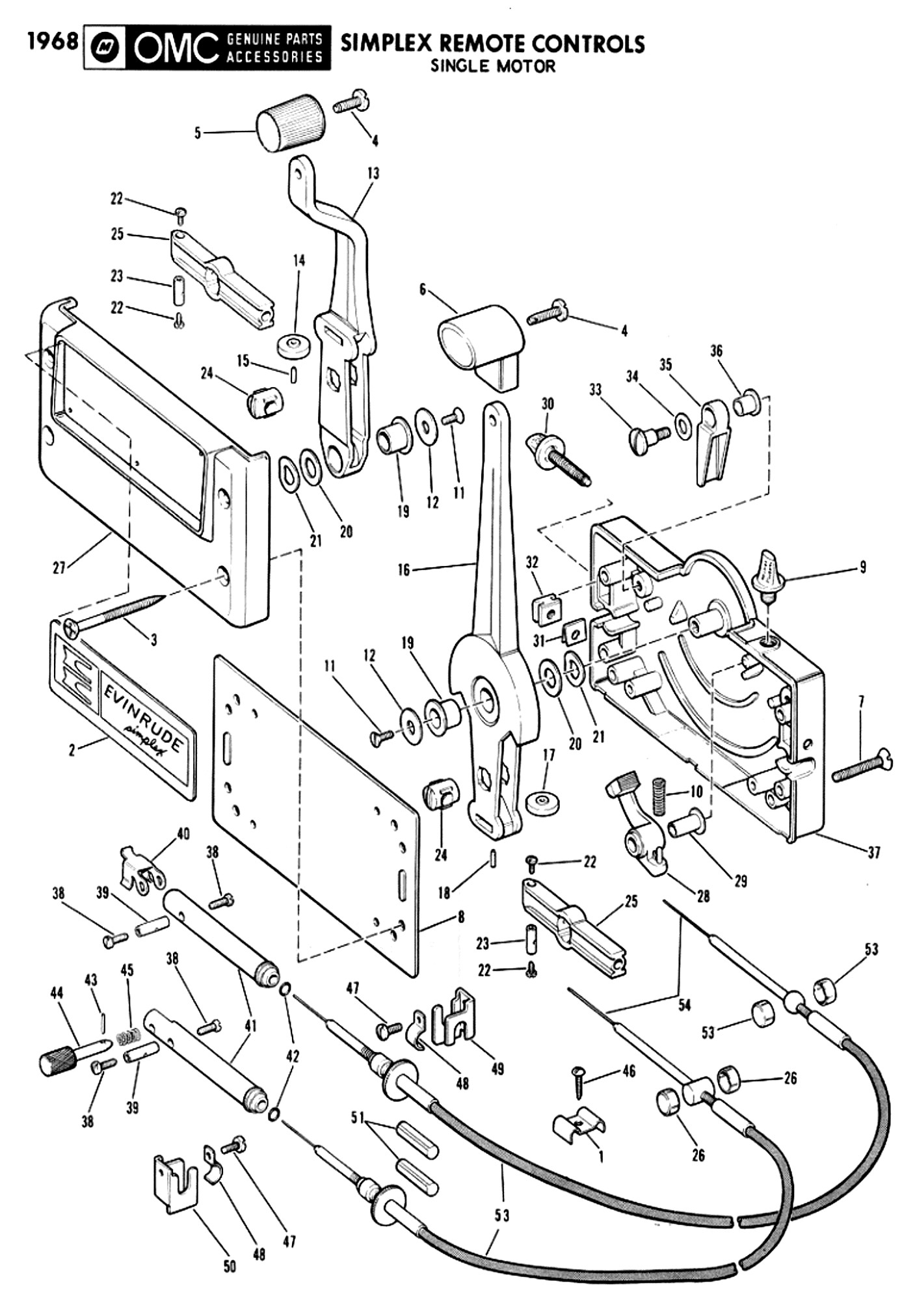

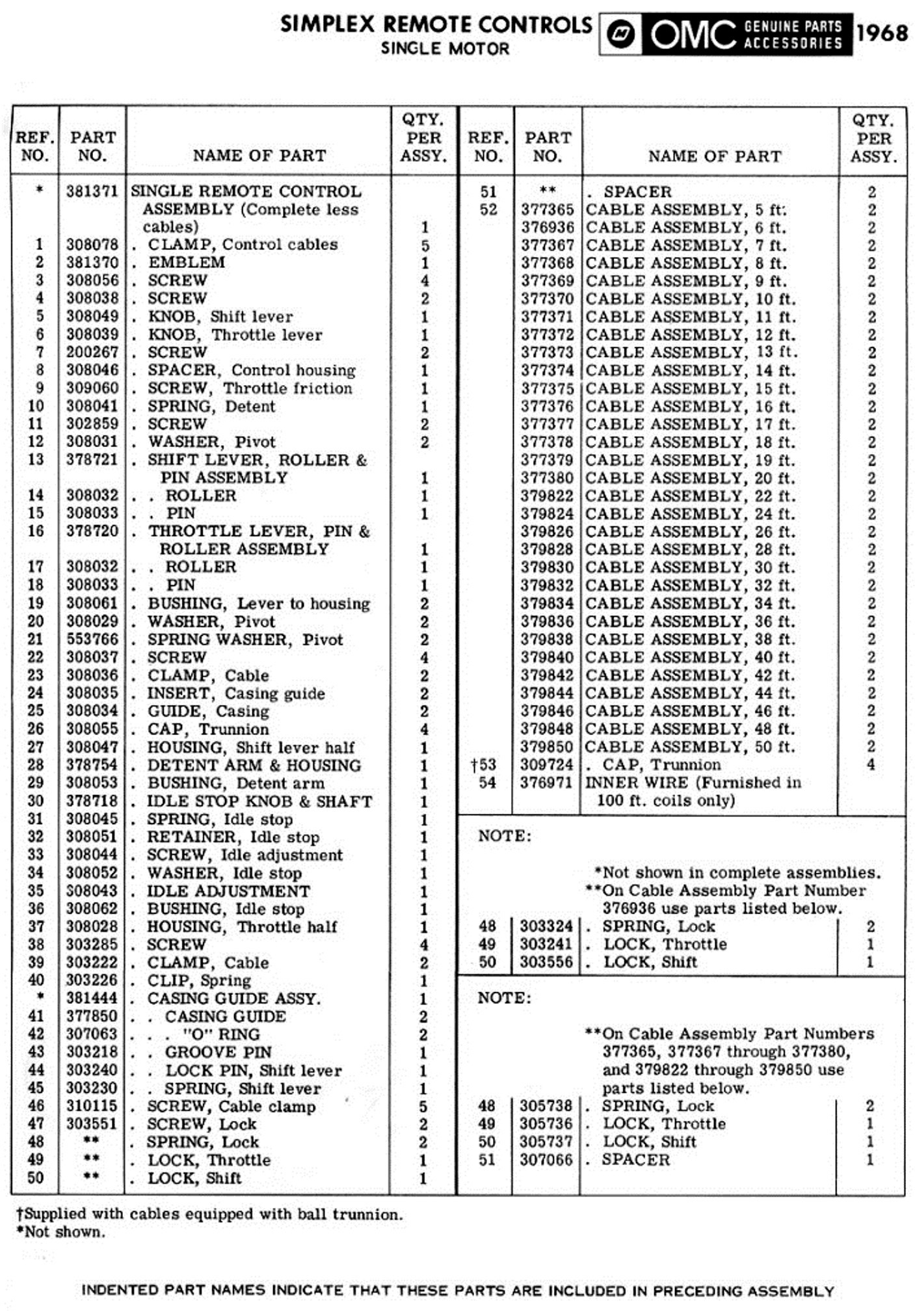

          These might help…

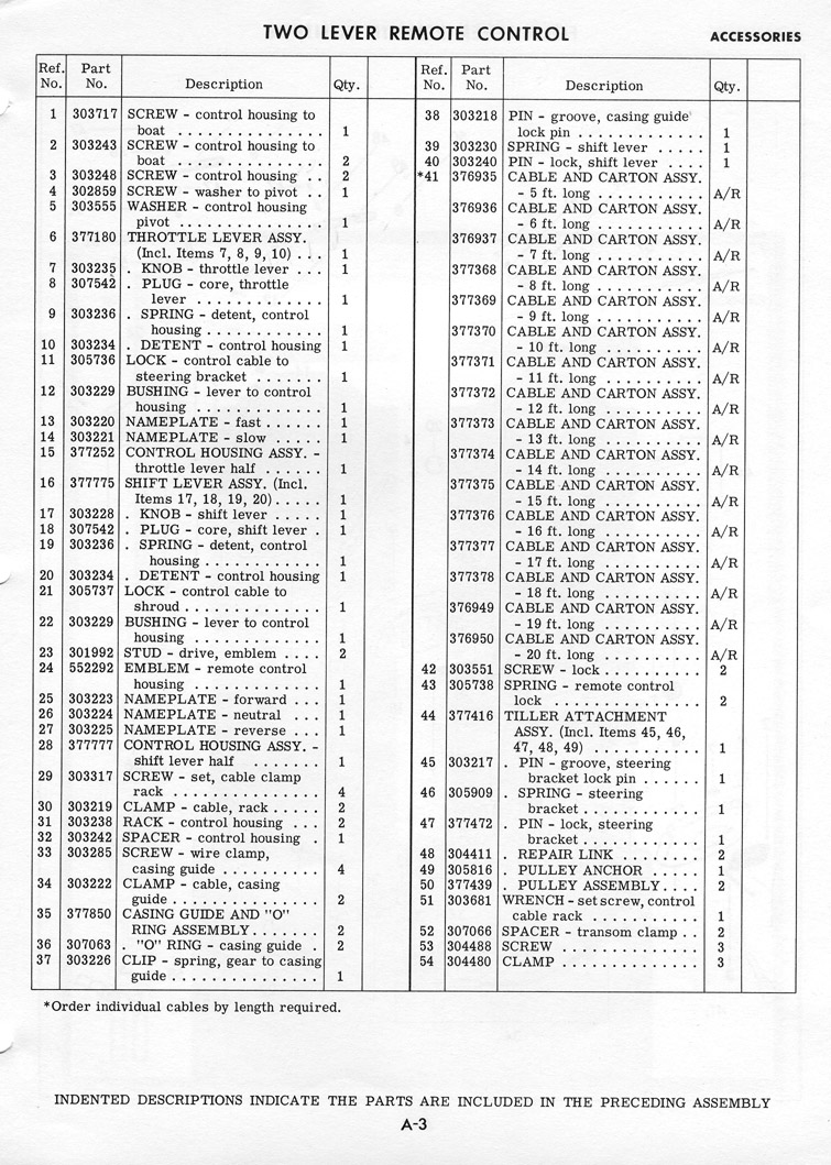

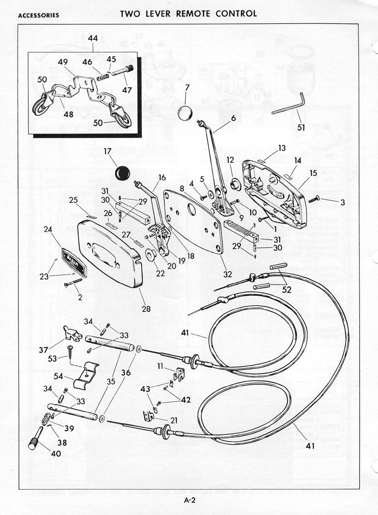

            This is the older style control if that is what you have.

                  Thanks guys. The innards of mine are clean and lubed but are worn. Those are some great resources and that parts breakdown just made my day!
