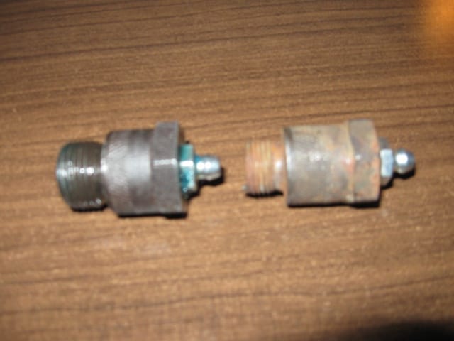

        I’m not sure if they are available commercially. It would seem that someone could make a few bucks at a meet by having some available for sale. I got mine from a friend (Thanks Steve!) who made it in his shop. Doesn’t take much if you have access to a welder and an old spark plug.

          A friend asked me to make up a batch a while back.
          Start with spark plugs with thread types you may need,
          Due to design differences some brands of spark plugs are less work than
          others.
          Hard part is cutting tapered thread for Zerk fitting.

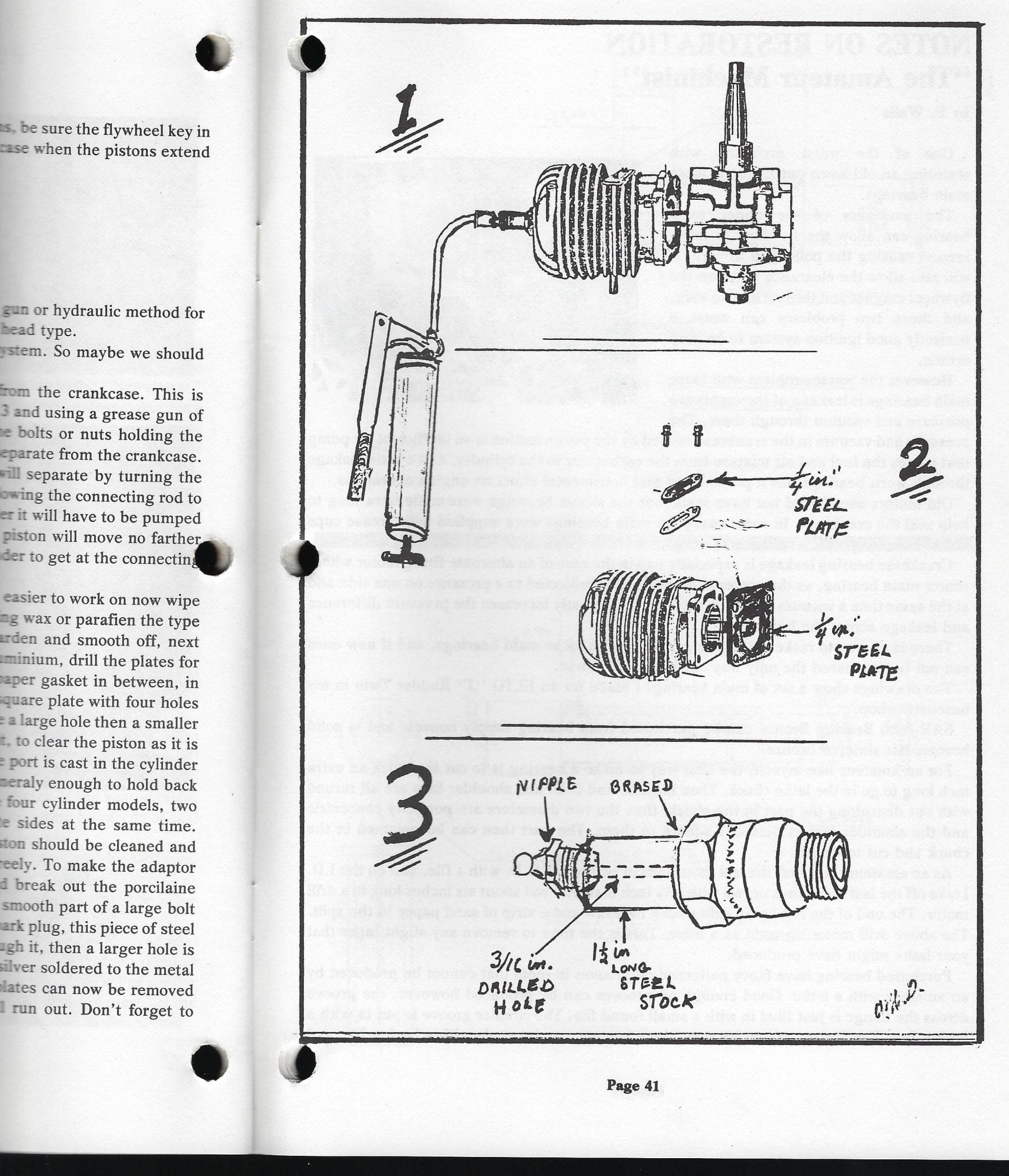

            I’ve made a few for my own use, i think the hard part is knocking out the porceline insulator. The steel is soft and you can run a 3/8 pipe tap through it rather easily. Most recently i got a Johnson A-25 to turn only one side was stuck. Kinda messy to clean up afterwords.

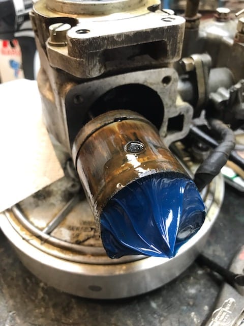

                      I would suggest pre soaking with GIBBS or MARVEL MYSTERY OIL first.
                      On my last stuck motor a 1933 NEPTUNE you can see the oil leaking
                      Down past the rings.
