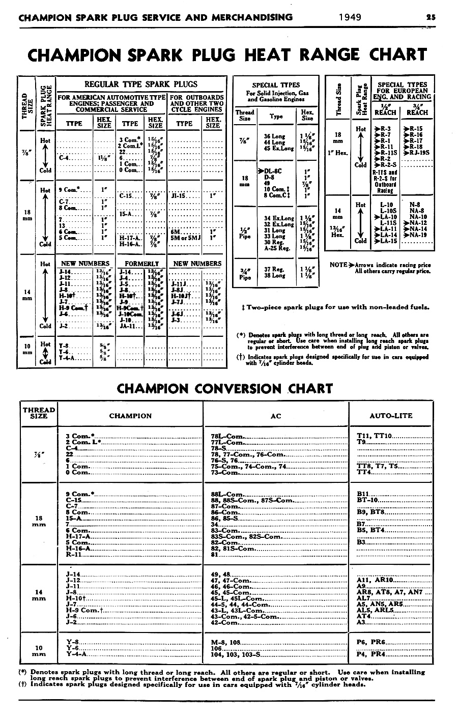

March 30, 2018 at 9:23 pm #73256I would not go with J8C plugs, as they are probably to hot. For me personally, I run J6C in my 35 Gale, 18 Johnson and so on. I got lucky at Tomahawk, and found some NOS J6J’s very cheap. I came home with a couple hand fulls!
March 30, 2018 at 9:54 pm #73257March 31, 2018 at 4:39 am #73269From 1949 . . . 😎
