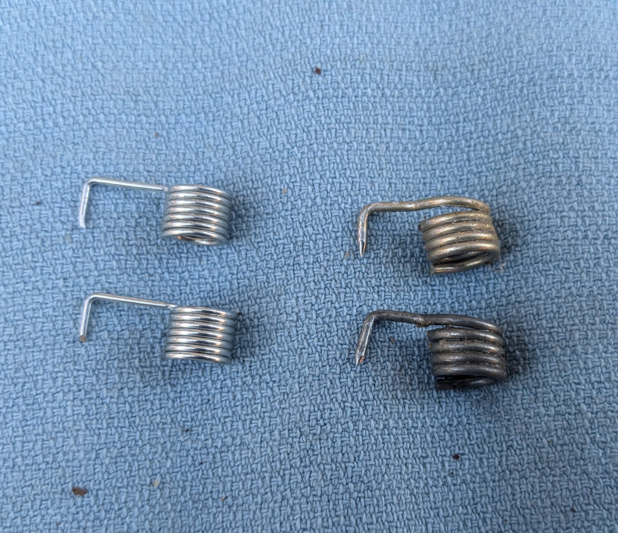

      Anyone ever seen terminals like these?  They came with some ZhongFaTec coils I bought off Amazon.PXL_20241023_180351758

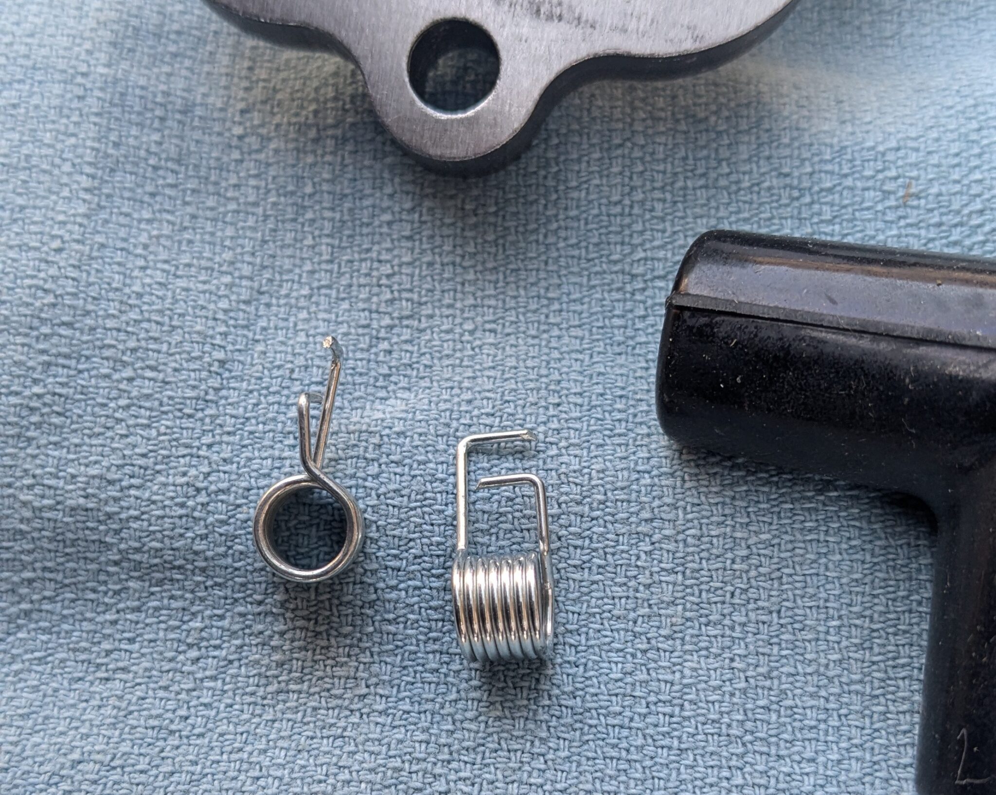

        I figured it out and nipped one of the prongs off. They sure are a lot thinner gauge than the originals. About .034 vs .050.PXL_20241023_184840673

          Thinner gage wire… think maybe the two prongs are to compensate for pull out strength. Why not just go with the two prongs?
          Joe
          #291737
          crosbyman
            agree with  joecb…. I would sharpen up both  “points”  to ease the installation.
            install the boot  on the plug wire / slip it  out to install  the spring   then pull it back in  carefully
            #291740
            joecb
              I have had good success pushing the terminated wire end into the boot, if the boot is stiff, warm it by soaking in hot water.
              Joe B
              #291840
                Two prongs were probably meant to help keep the terminal from coming off the wire but installing it would have been beyond my capabilities.  The first time I pulled the boot off the plug, the new terminal got left behind still attached to the plug. Using the original terminals seemed the logical choice so that’s what I did.
