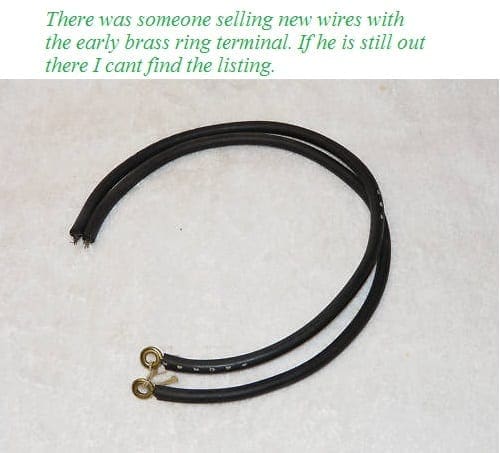

              Too bad no one is manufacturing those original style, crimped, “eyelet”
              plug wire terminals, but I suppose one would need a crimping tool of some
              kind. They’re a lot less bulky than what currently available, and probably
              less prone to arcing in close quarters.

                  Samuel Phelps
                    I did order the Packard 440 wire and these terminals . They are just like the ones that were on there originally .
                    https://brillman.com/product/brass-ring-crimp-spark-plug-magneto-terminal/
                    You kinda have to look through all the terminals to find them .. .25 cents a piece ..

                    Samuel Phelps
                      Dont ask me how that link picture got so big ! LOL!!!!
