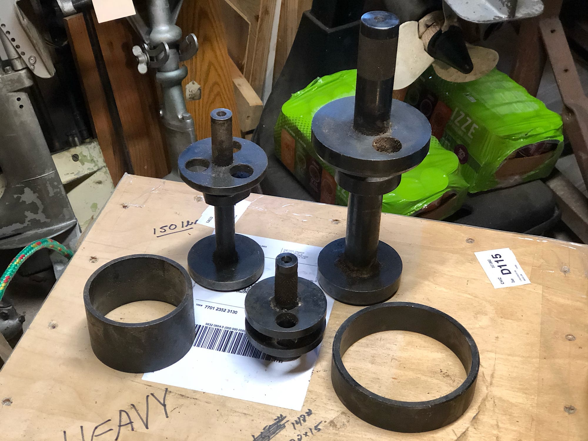

      I bought a pile of outboard tools and while most of them were mercury tools, there were a few OMC tools in there too. I think…..
      The bigger ring in this picture has the “M” stamped into it so it must be OMC. Any idea what these tools are for? Must be bigger and more modern I’m guessing.
      706360A5-BA2D-47E2-9EF6-138CF915E4F9
      • This topic was modified 6 years, 7 months ago by Mumbles.
      #199071
        OK, well the large diameter black ring looks to be the latest coil alignment tool that was introduced with the UFI ignition. This tool is just a little taller than the standard tool used for years so certainly can be used on the universal mag systems…
        Those tall tools look to be from the OMC King Cobra cone clutch outdrive or perhaps the Volvo/OMC joint venture outdrives.
        #199078
          The tall sleeve on the left is a piston ring compressor. Best kind ever made. Only thing is, it only fits one size.
          #199081
            Mercury has tools similar to the three standing on end which are used to shim the bearings and set the gear clearance in the Mercruiser stern drive units.
