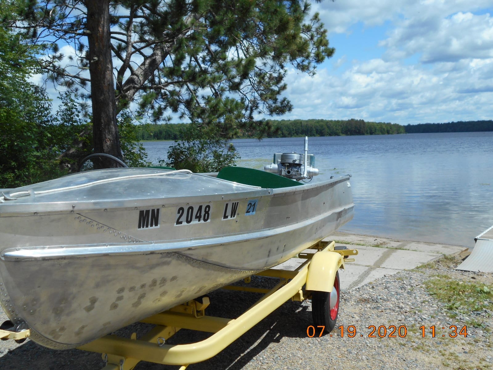

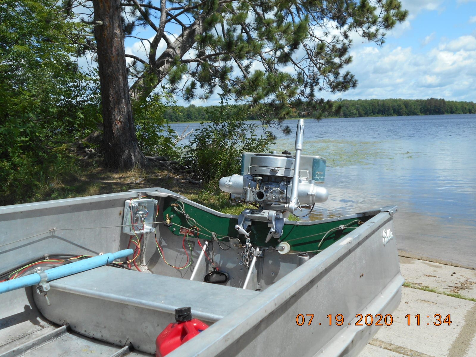

      DSCN9358
      DSCN9359

        Well, sorry it didn’t go as planned, but it sure looks great on the back of that boat!! I’m sure you’ll get it figured out.
