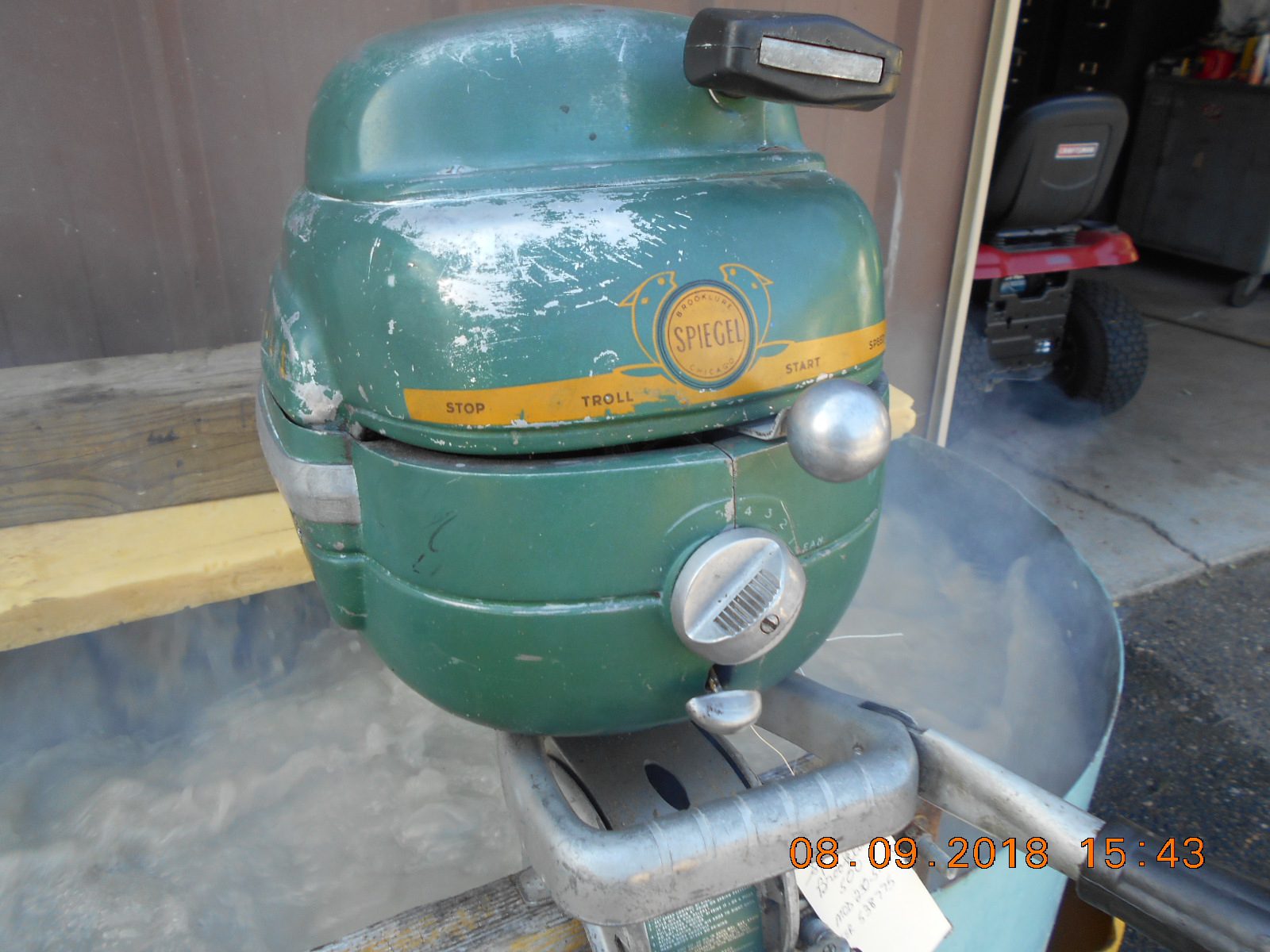

Picked up this motor recently and I believe it has the universal magneto, so that should be a breeze. The carb I can handle I hope. I know it’s different. The question I have for now is what water pump impeller does this take and how hard is it to change? This model has the neutral lever and I’m sure that will have to be possibly disconnected to get to the water pump. Thanks for any help. Sorry been gone for a bit, been busy with mom in hospital and nursing home. Be nice to get back to working on a few motors.

February 6, 2024 at 4:25 pm #284691That is a Gale 5D10 motor. Gearcase/water pump are the same as 5hp Johnson TN-xx models, except for a couple of items. Drain gear oil, or you will wind up with oily shoes, then cable has to be disconnected at the neutral lever, then gearcase and 1/4″ plate (#17) with the water pump can be dropped down to access the pump. Cable will follow it. No fear, the cable is fed up through a (#5) pipe to re-install. Warning!! If cable end is frayed, a different procedure is required. Don’t pull a frayed cable down or you’ll never get it back up through the pipe.
Hint— a 5.5/7.5 HP Johnson impeller will work by reaming out the center hub to fit over the slightly larger drive shaft.

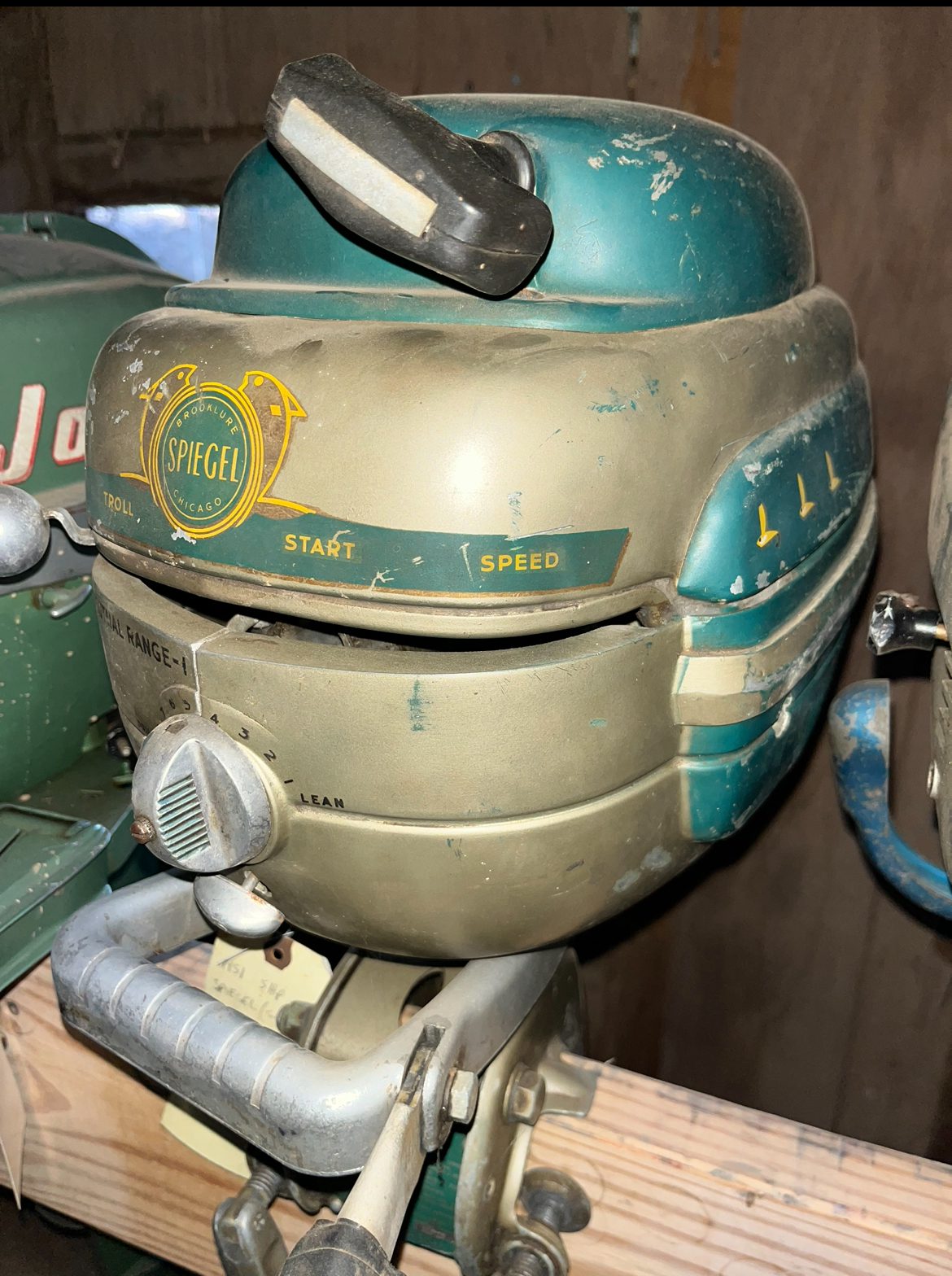

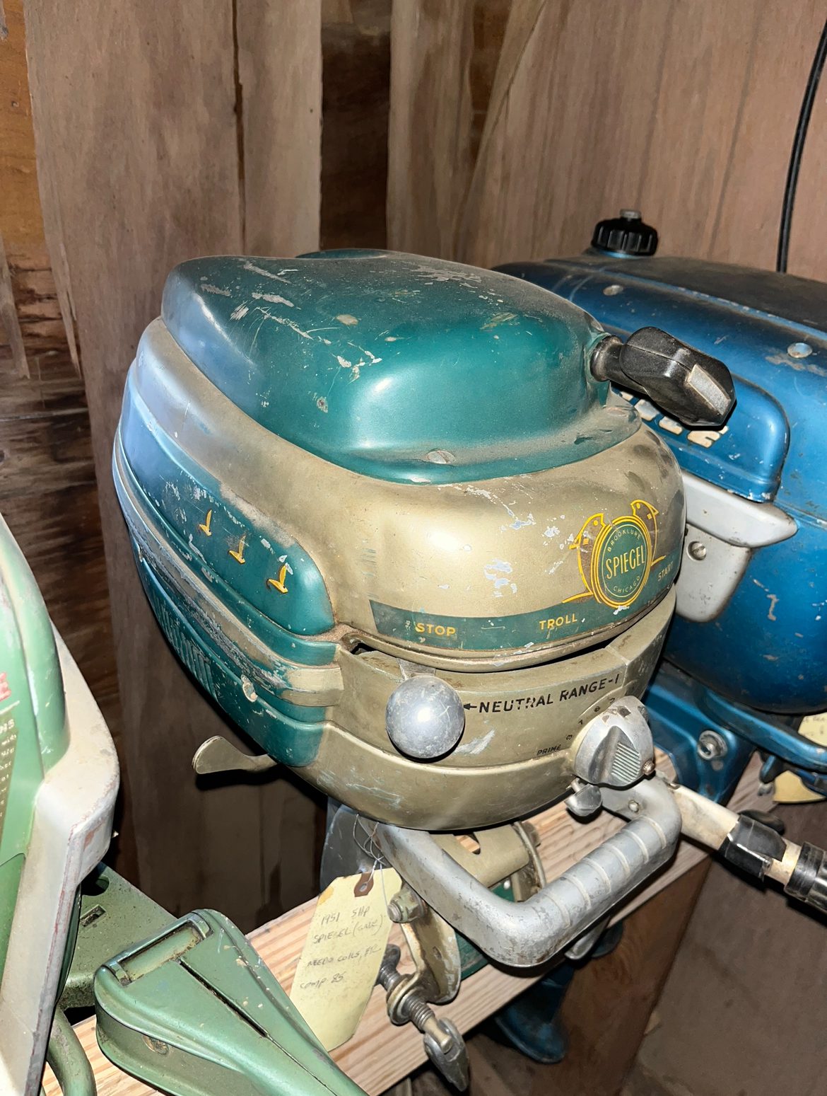

February 6, 2024 at 10:33 pm #284714February 7, 2024 at 9:08 am #284718February 7, 2024 at 12:06 pm #284722I have a Gale version and the Sea King. Both 5hp. One has neutral shift and one doesn’t. There’s a couple years difference in them though.
