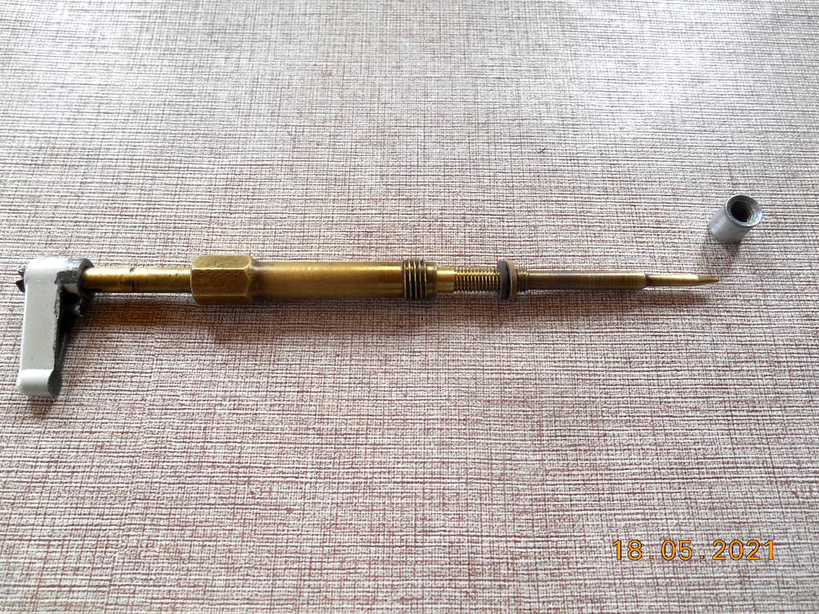

      As shown in pic, the lo-speed bushing came out with the needle.
      Have tried threading the bushing onto the needle a few threads, snugging up the packing and inserting into the carb.
      Then tighten packing nut enough to try and keep bushing from turning, then thread in the needle following simultaneously with the nut.
      No luck after several tries, looking for some sage advice.
      Bill.
      P.S.
      Assume the flat end of the bushing goes toward the carb, dished ent toward the packing disks.

        That’s the procedure. Try tightening the packing nut a bit tighter, to secure the bushing.

            Perhaps the threads are buggered up a bit making it hard to turn, forcing the bushing to spin…Try threading the needle into the bushing outside the carb to see if there is an issue
            #238635
              The thread pitch on this needle and bushing are 1/4 X 40 and the bushing has to spin freely on the needle for it to work.

                Thanks for the replies guys.
                Tried again and think I may have it now.Won’t know for sure until I fire it up of course.
                Great suggestions as always.
