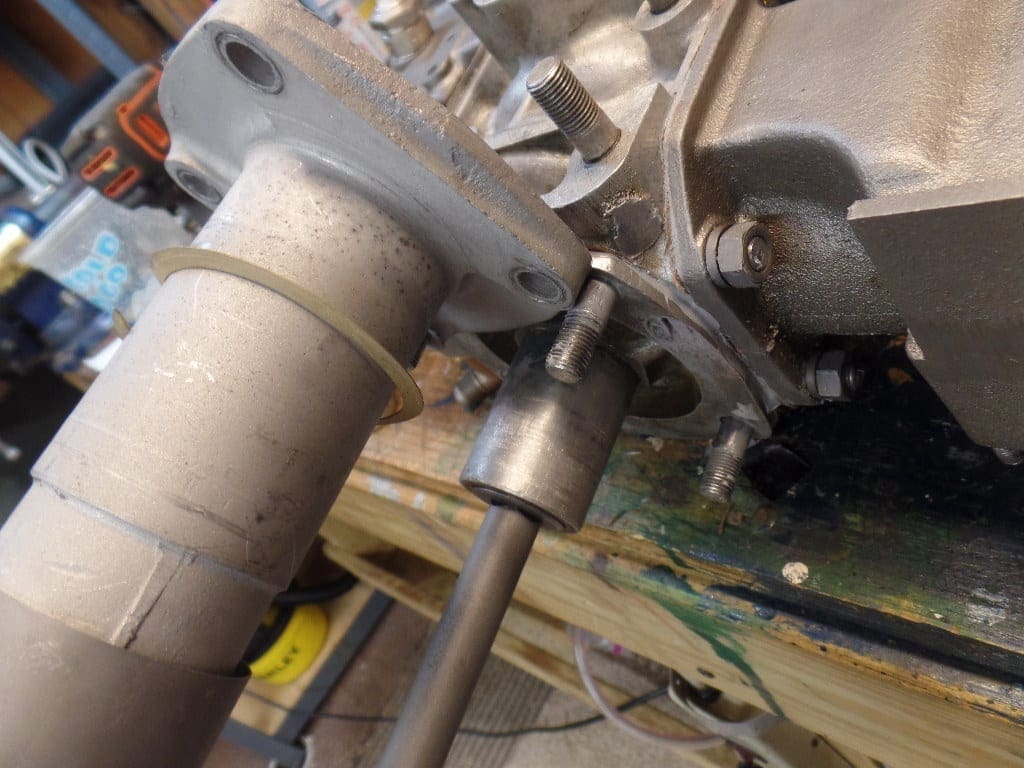

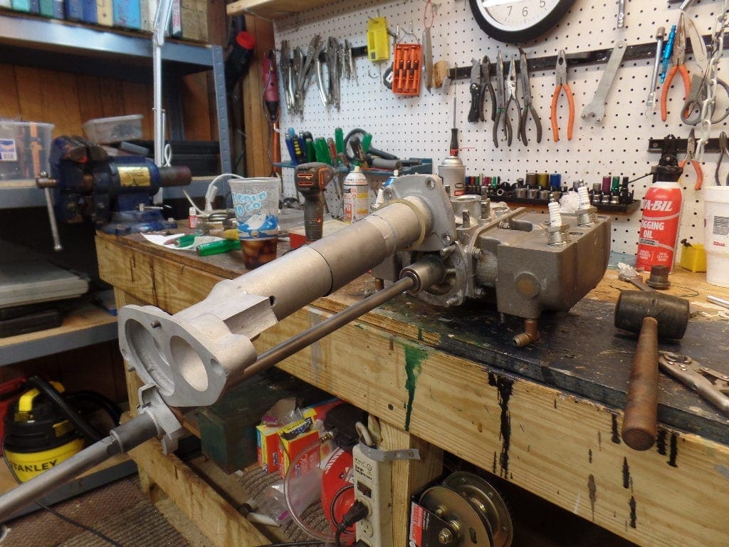

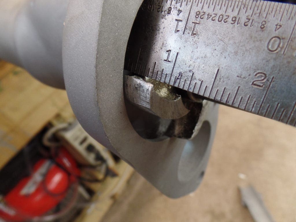

      I ran down a missing upper drive shaft and impeller. The impeller looks good and matches up with the housing. The drive shaft appears to be 1/2 inch too long even when fully seated in the crankshaft. Maybe from a different model? I could cut it down but I’m wondering if I am missing something obvious…

        If I’m seeing what I think is your concern, you are missing the point that the impeller is upside down on the shaft. The flat side of the impeller is supposed to be on the bottom, against the top of the gearcase.
        George
        #186527
          NO – The flat part goes against the housing. It picks up water from the center and throws into the outside (Centripetal Force) Early models had a different tiller arrangement. The drive shaft is Parkerized to prevent rust. Put the trimmed part at the top. Be sure the spline does not bottom out and bind the crank shaft.
          #186529
            P.S. – The rare 15 HP model 9039 Heavy Duty Twin used the same lower unit and gave the Sport Four a run for the money . . .
            #186544
            hank1995

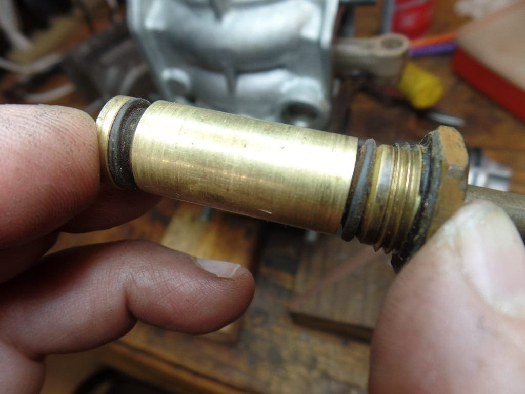

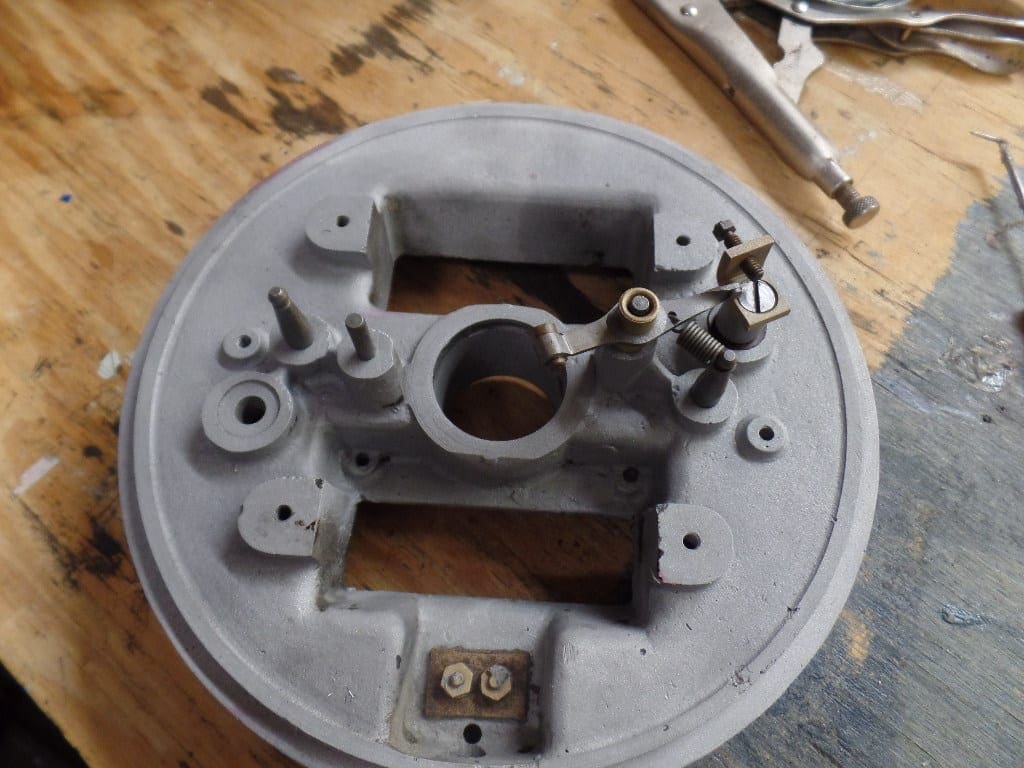

              Pls look at 2nd/4th pic again. The shaft on the lower right in pic 4 is the lower drive shaft. This is off a 39 and mine is a 35. Maybe they changed those dimensions at some point or it’s off another engine altogether.
              #186550
                Yes they did – trim it to fit.

                  PS – Also – The guy tells me from an ELTO. Still looking for coils – otherwise coming right along.

                    Another PS: Pic 4 is the enrichment valve. The leather washer look remarkably good. Has anyone had any luck substituting another material or I suppose you could cut new ones from leather.
