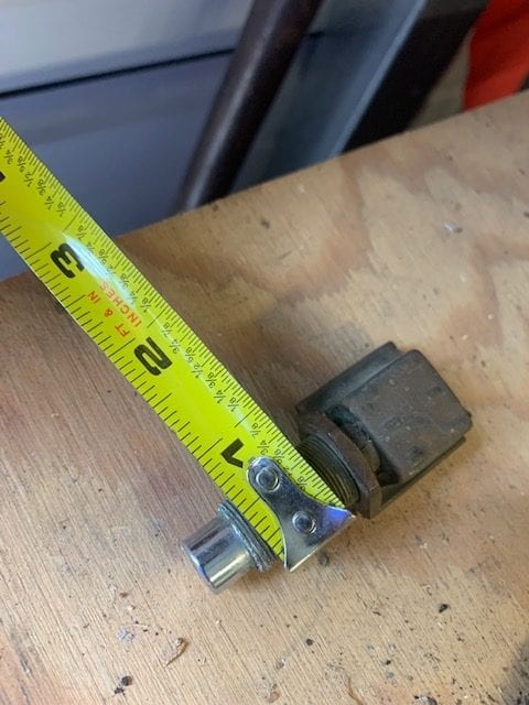

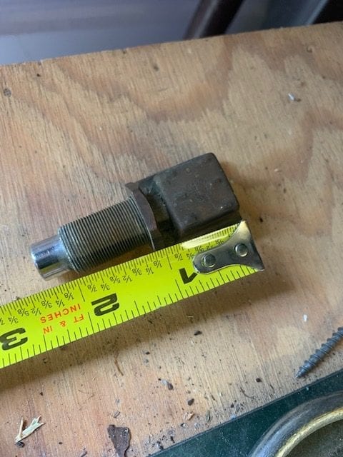

      Hi, anyone have a source for this start button? I’d like to get something to fit through the original hole and instrument plate, so far the auto parts stores have buttons that are too big.

        Go to your local NAPA and ask to see their marine catalog. They are available/

            The threaded portion of your switch looks like a standard 5/8″ shaft, so a google search for “push button starter switch” will give you a variety of selections that should work. You can get a 12V 50A switch for $15 or less.

              I found one at NAPA. Couldn’t clean the old one, the contacts ripped out of the bottom. Thanks for the help!
