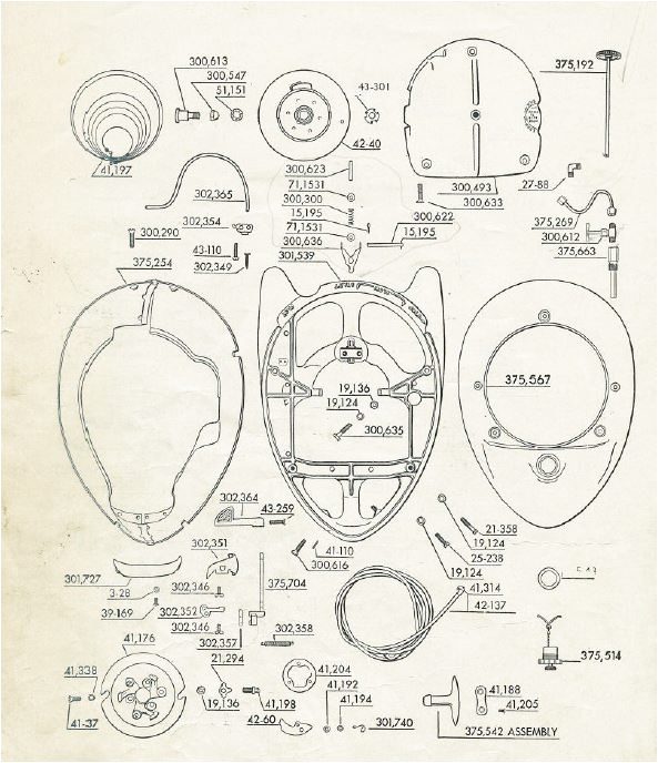

          As mentioned, undo the three screws on top holding the starter on and see if anything obvious is wrong. It could be anything from a frayed rope to dried out grease on the rope pulleys centre bolt or main spring. The pawl springs could also be broken or undone and jamming the mechanism.
          TN-Starter

              The centre bolt, 300613, also doubles as a bearing for the starter pully, 42-40, so yes, it requires lube of some kind for smooth operation.
