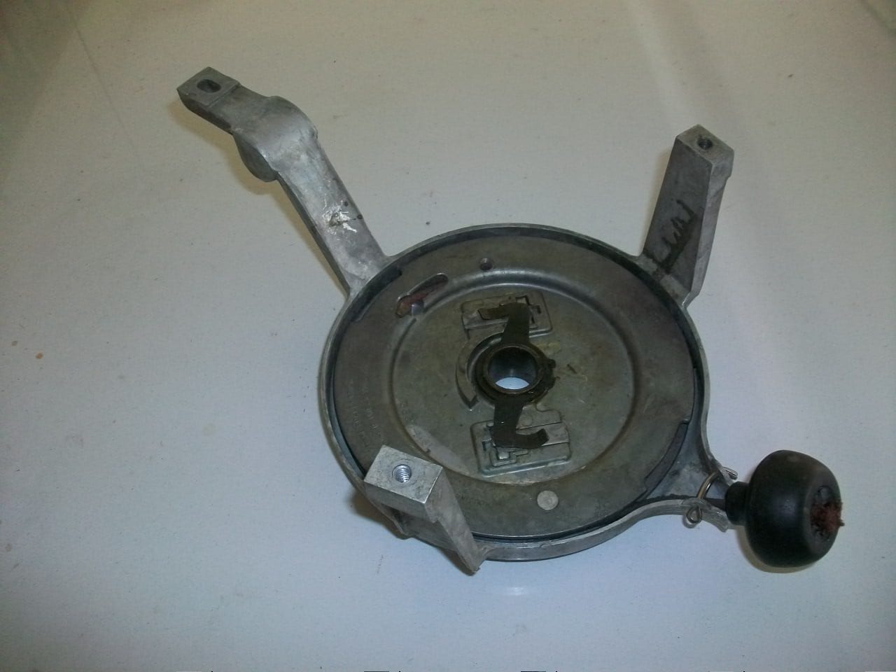

          That metal/plastic starter rope was made right here about five miles from where I’m sitting, by Olson Shear Pins Company. It actually is made from steering cable. The original was steel or bronze wire covered by brown woven cotton. I think I have a handle out in my shop, will look after I get my coffee.
          #210854
            The rope was simply tied in a knot which went inside the cavity, then a metal insert covered the hole. Insert is missing on this one. Starter is from a larger motor.
            100_1801

              Super helpful. Thanks for insights from everybody. It appears to me that the original handle must have broken so it was replaced and then kludged together with the U-Bolt. frankr if you happen to have a handle that would be more original, I would be interested in purchasing it. Let me know. Tom
