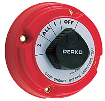

        You need to install a main battery switch, especially if your boat has dual batteries in it. Turning it off at the end of the day will turn the power off to everything except the automatic bilge pump, which will be hard wired to one of the batteries.
        Battery-Switch
