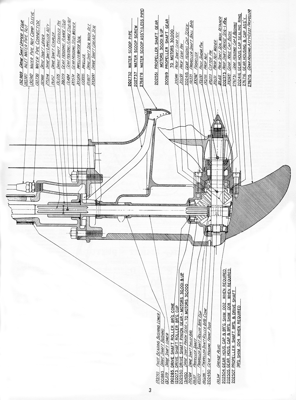

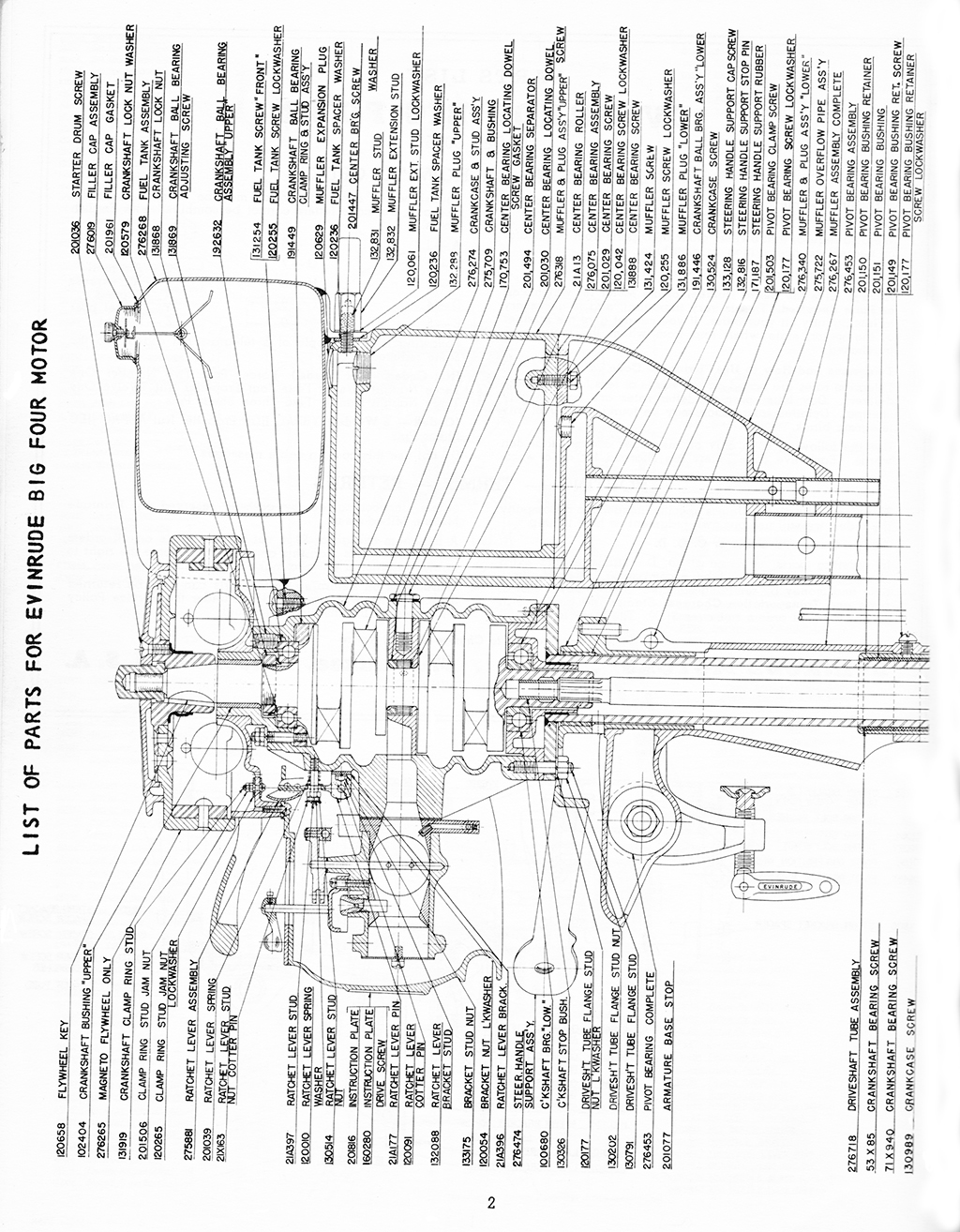

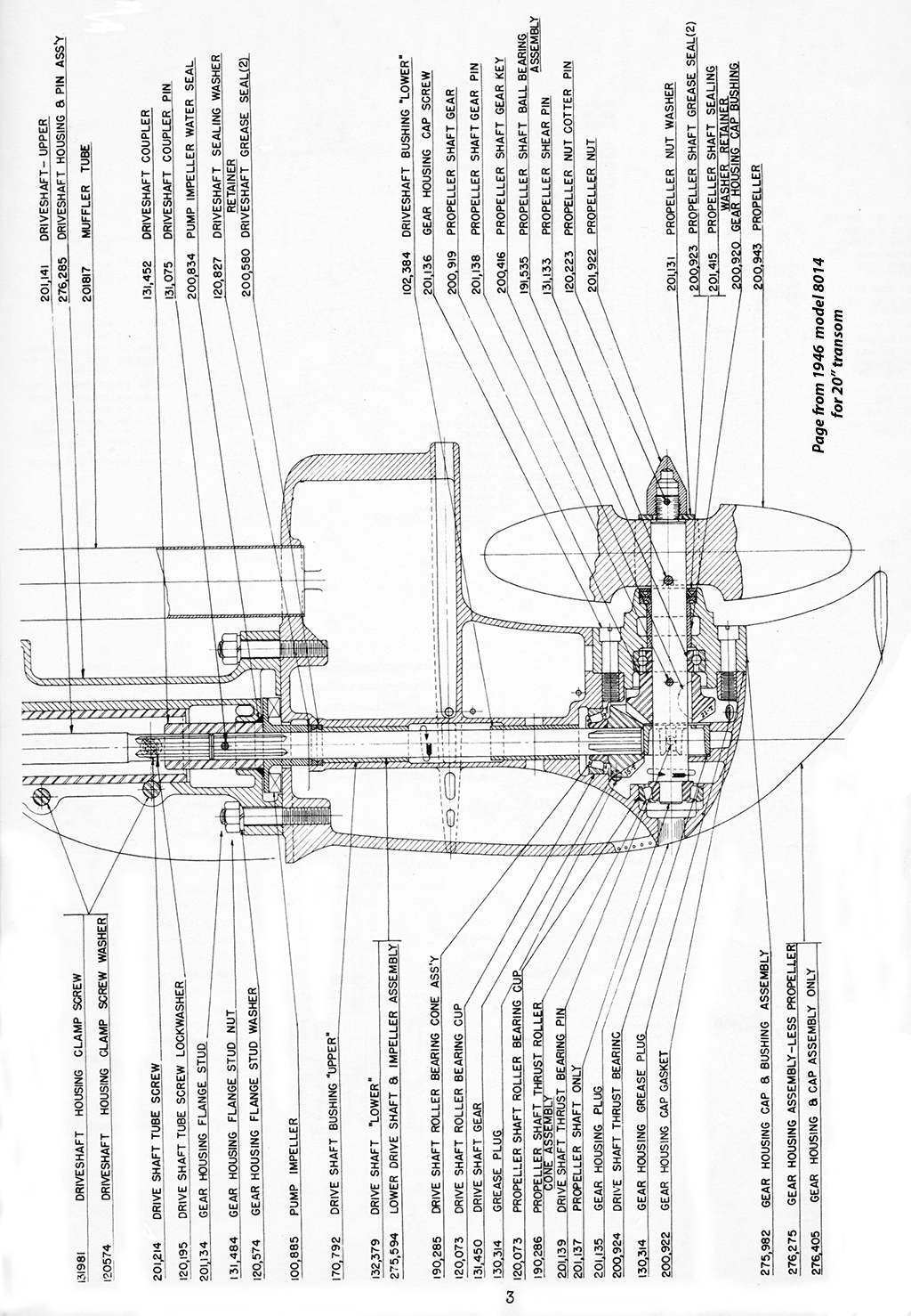

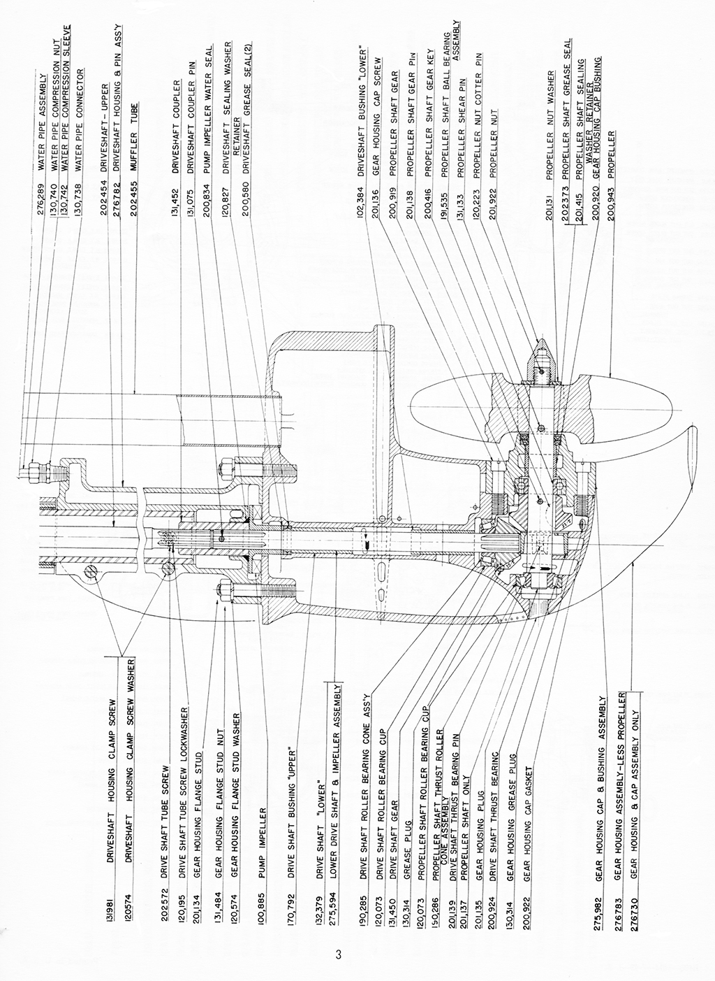

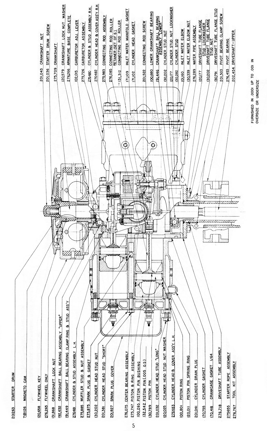

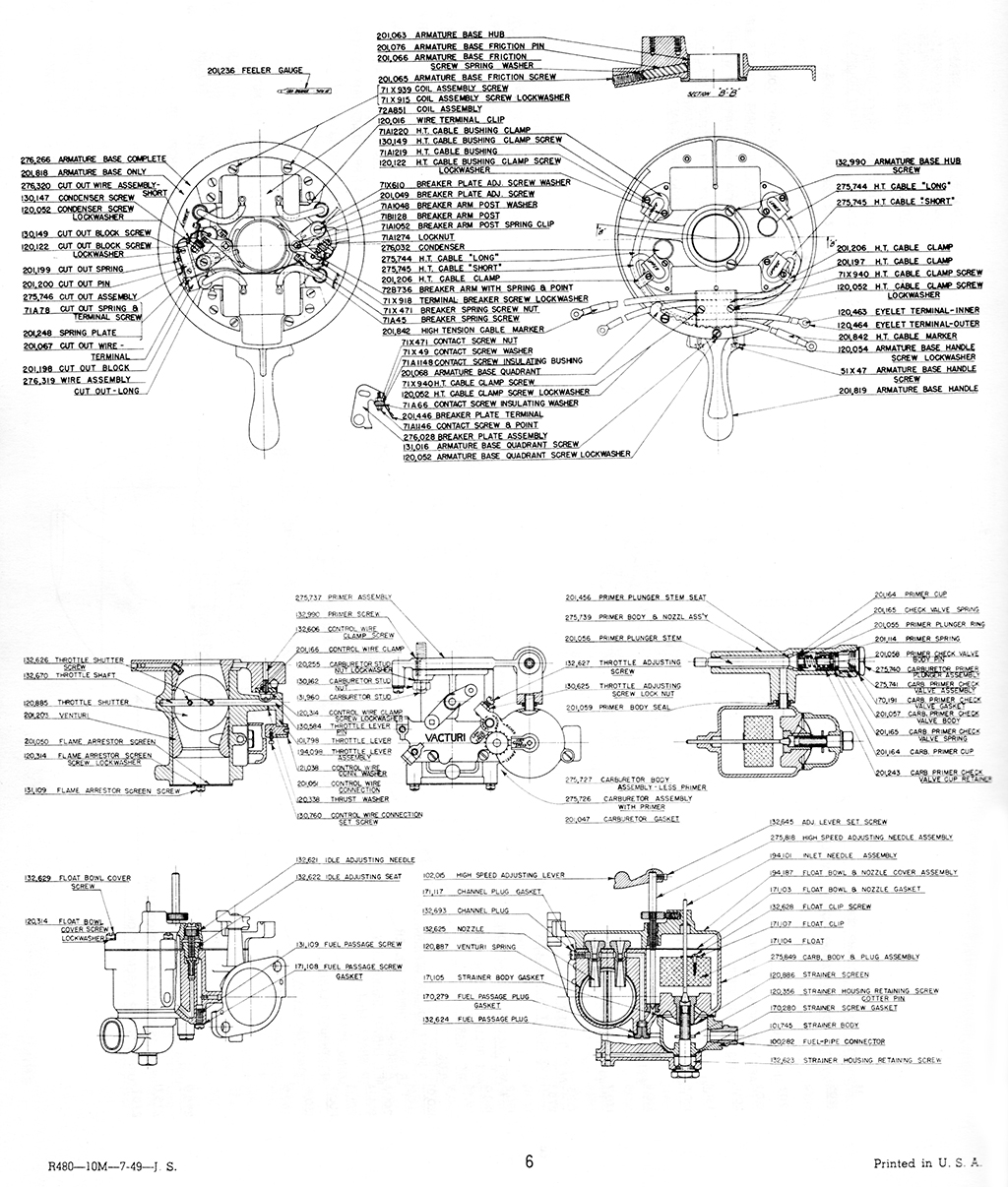

It’d depend what you wanted to do with it, or just running occasionally. Might be ok, in my opinion.December 21, 2016 at 12:01 am #49496I had heard that back in the mid to late 1940s one of the west coast racers/motor builders/parts suppliers cast a Evinrude Speeditwin driveshaft housing in bronze for "C" service racing.. It was also used for P500 pumper "F" racing conversions. I personally have never seen one.

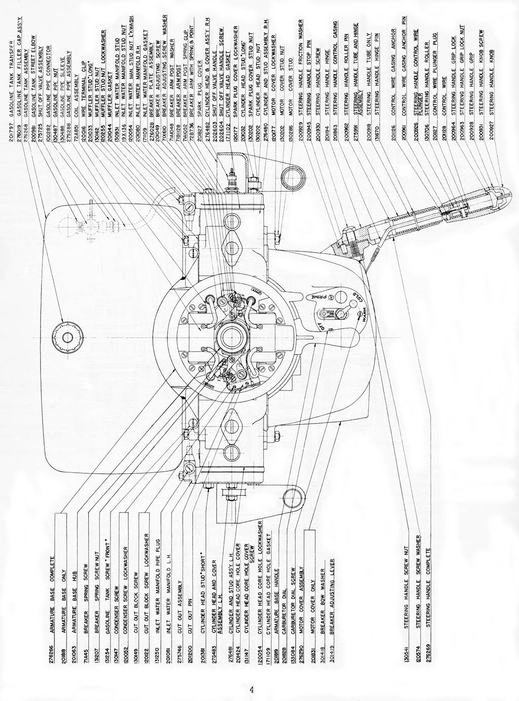

I am very happy you posted here because it is easier to post pictures here. . . 😎This is the best lower unit. It was patterned off one dad modified.
December 21, 2016 at 12:12 am #49498December 21, 2016 at 6:40 pm #49534Wow, Thanks Garry! I’m going to have to put some of this up on my shop wall.
