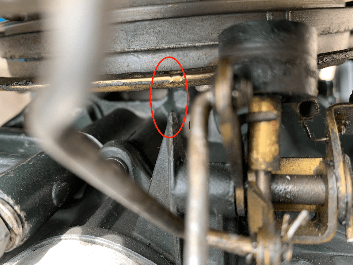

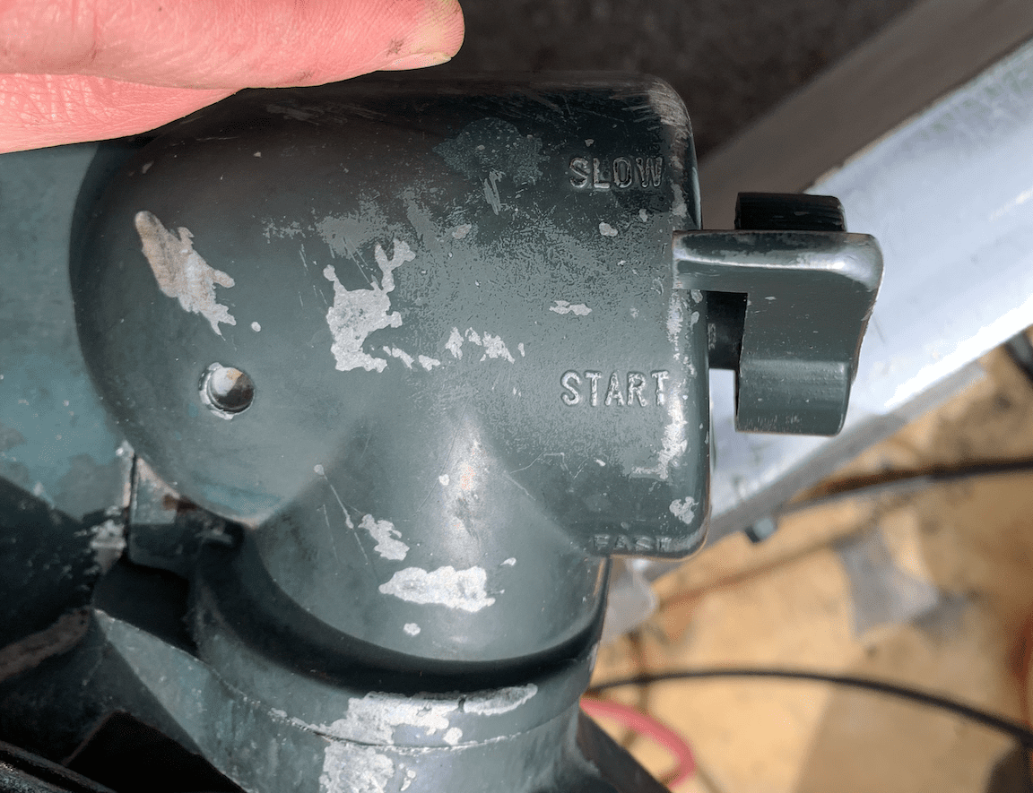

                    OK, so I replaced my fuel line, no problem. The carb is super clean. However, I’m looking at the cam alignment and that may be my problem. According to my official service manual, my manifold projection is supposed to line up with the two marks you see there. When I do line those up, you’ll see that my throttle is between “start” and “slow”. Now what do I do?
                    Manifold projection lined up

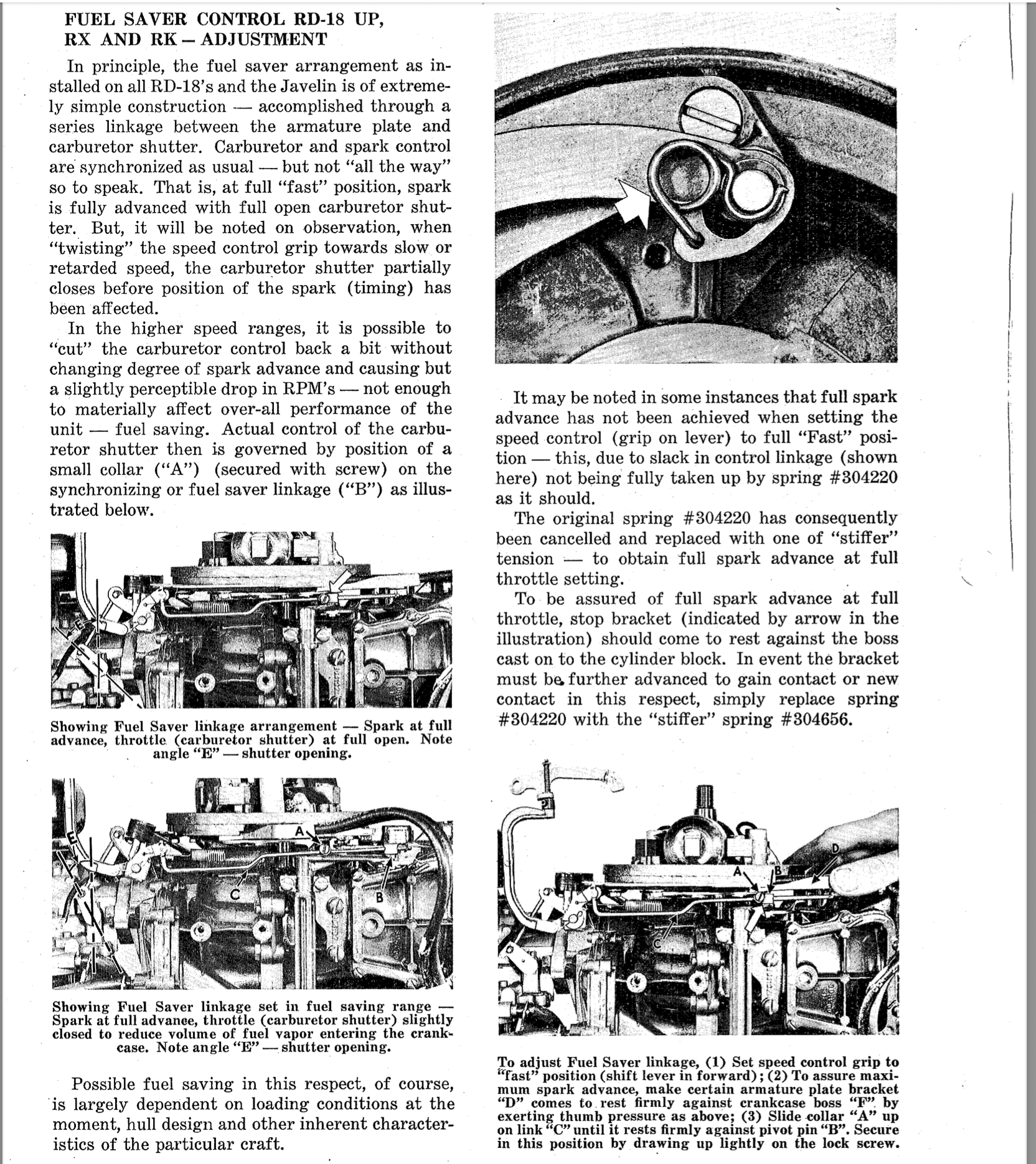

                      Well, I’m not too concerned about the cam pick up point, your issue is at high speed. The “economizer rod/linkage” is what I’m wondering about, this is the horizontal rod that runs from the mag plate up to the carb linkage. This linkage allows full timing advance to be achieved before the carb butterfly is opened fully. It can be a little tricky to set this correctly, you almost need two people to do it…
                      If not set properly, the carb butterfly might not open fully at WOT…Or, if the adjustment is somehow “preloaded”, this might prevent the mag plate from advancing fully… Sorry, I don’t have the manual pages to post, but I’m sure someone will do that for you.

                        Here’s the page out of the Service Manual for the fuel saver rod adjustment.
                        Fuel-Saver-Adjustment
                        1982 Evinrude 25hp
