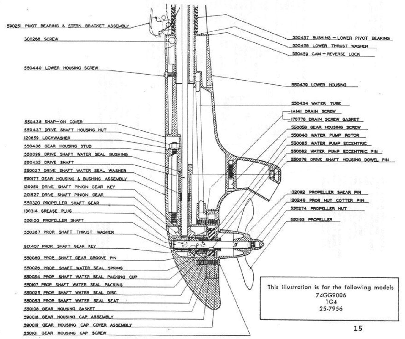

                Is this your model ? . . . ๐Ÿ˜•
                #65933
                  That 132092 shear pin is also used on the Evinrude Sportsman and Sportwin . . . ๐Ÿ™‚

                    quote Garry in Tampa:
                    Yep, that’s the one!

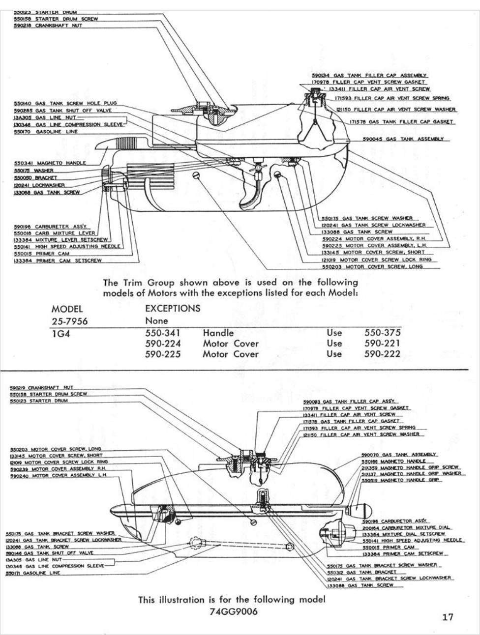

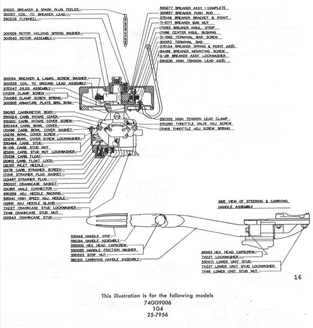

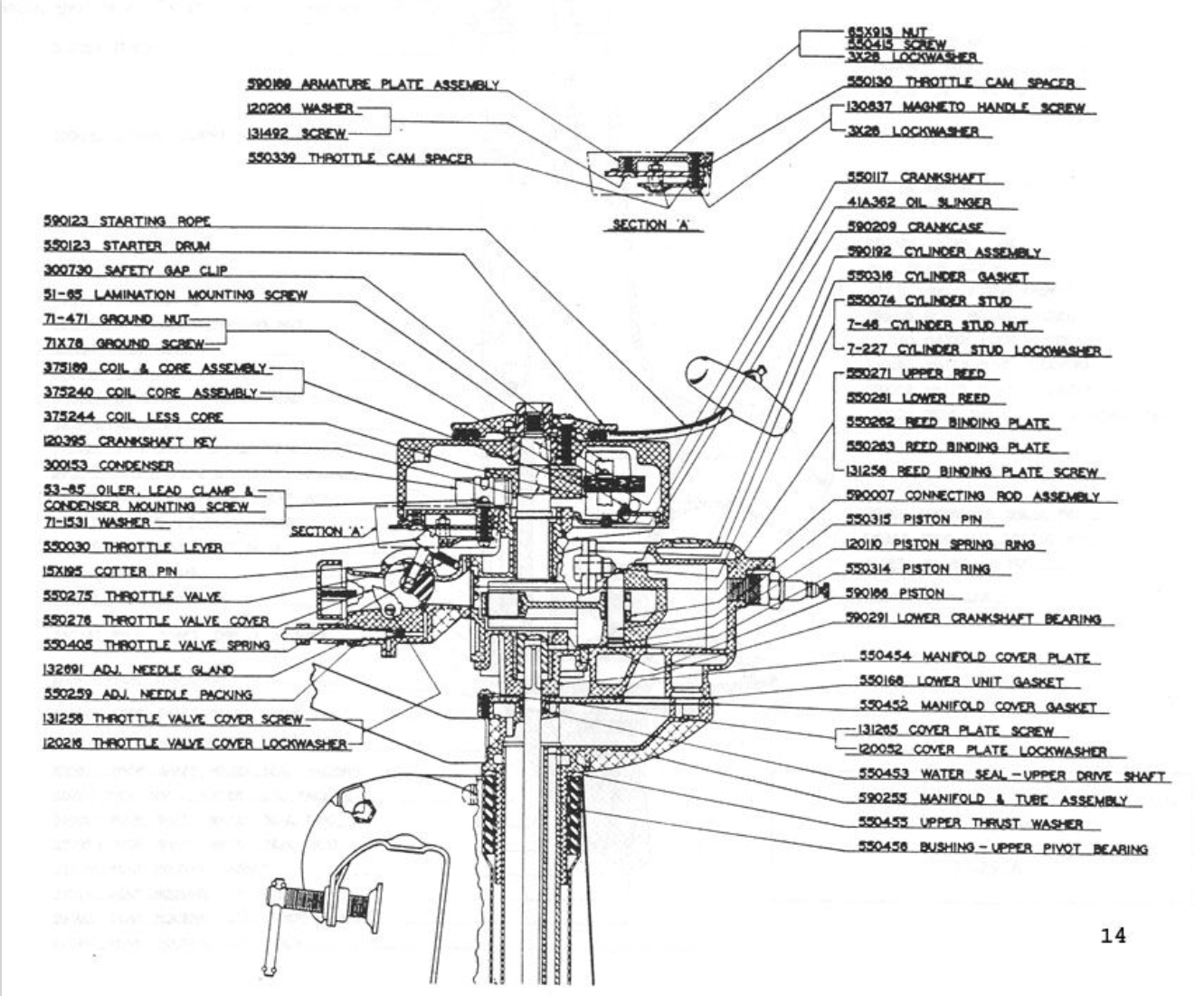

                      #65937
                        You may as well have the rest . . . ๐Ÿ™‚
