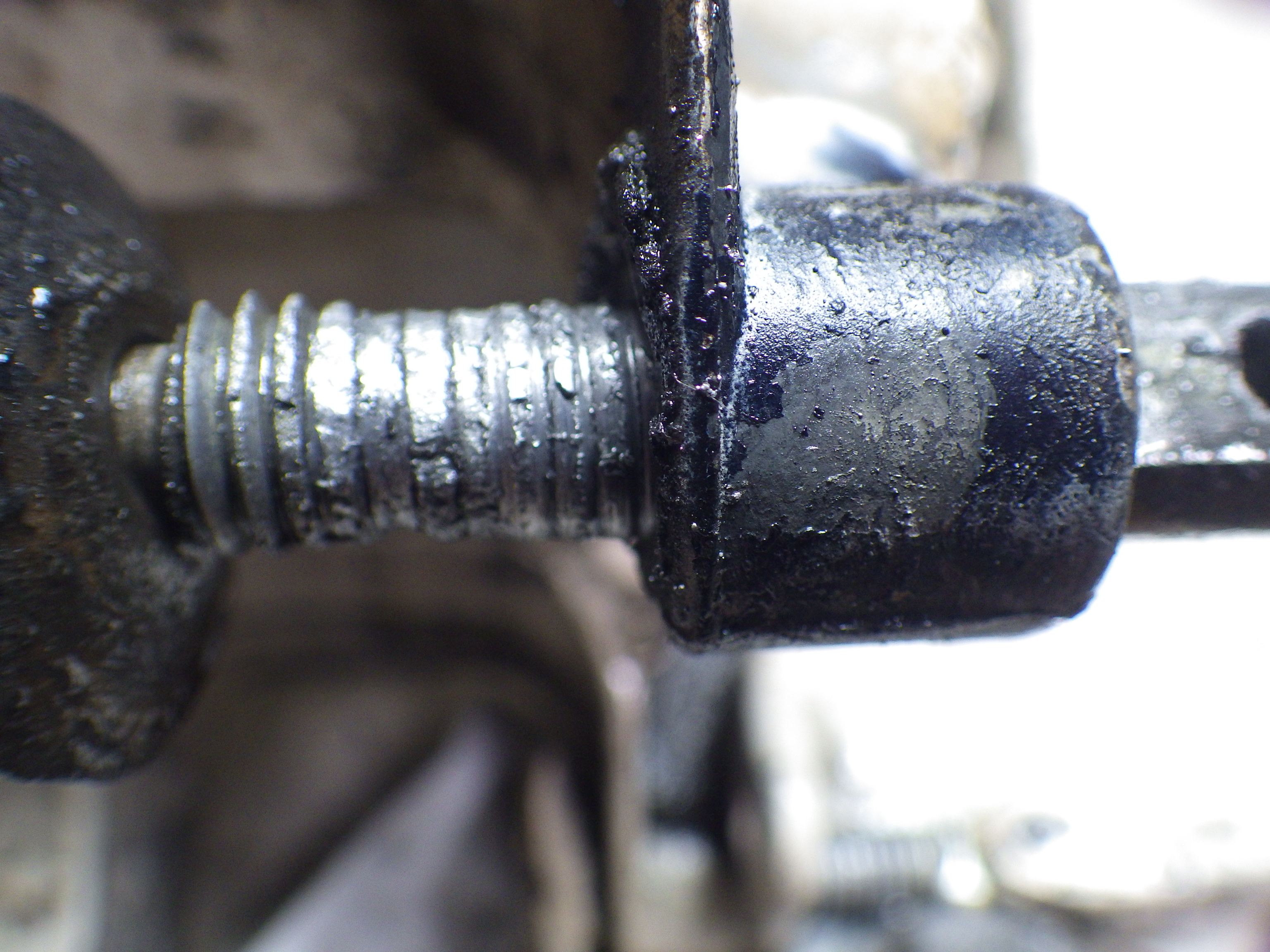

      Working on a little Evinrude Mate that has been sitting out in the weather and has a little rust on it. I have patiently been able to get most of the bolts loose with heat and oil, until… I get to the aluminum transom clamp screw. I am just using a propane torch and light oil, but no luck. Any ideas?

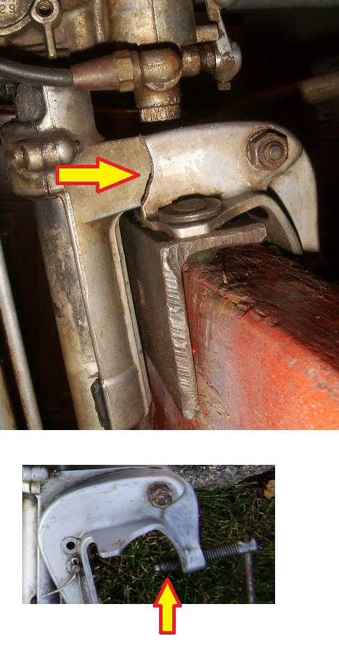

          I ran into this on a Mercury 400, that I tried heat from a Oxy./ Ac. torch. And had no luck the easy way. So I did it the hard way. On the side of the clamp that faces the ground, I cut a slot parallel with the threaded part of the screw, just to the threads. Then went back to heat and it came free. Then I welded up the slot and filed and shaped the weld to match the surrounding area.

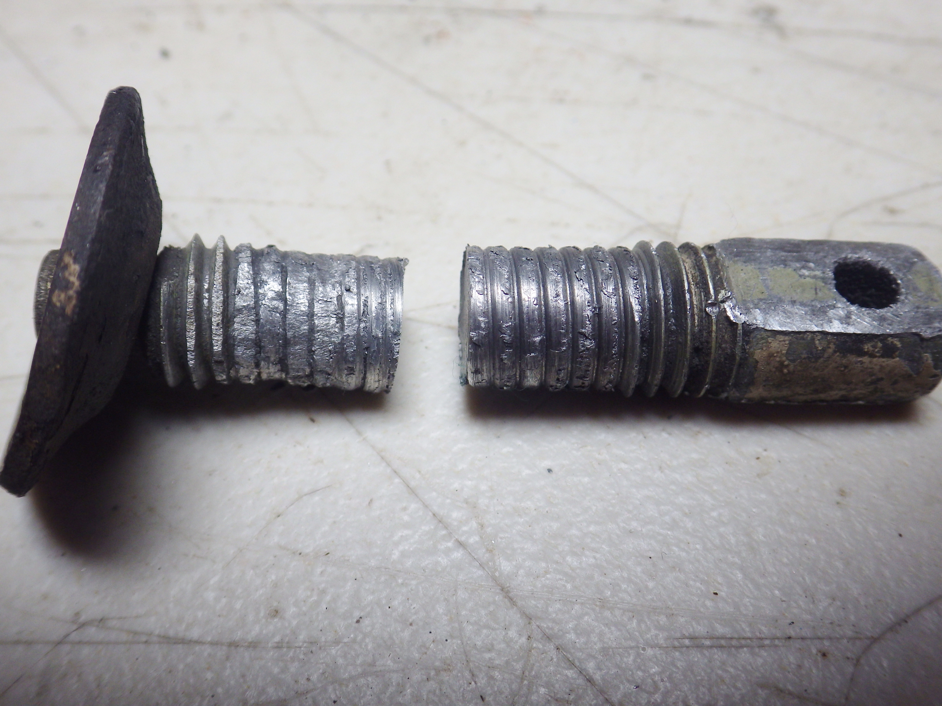

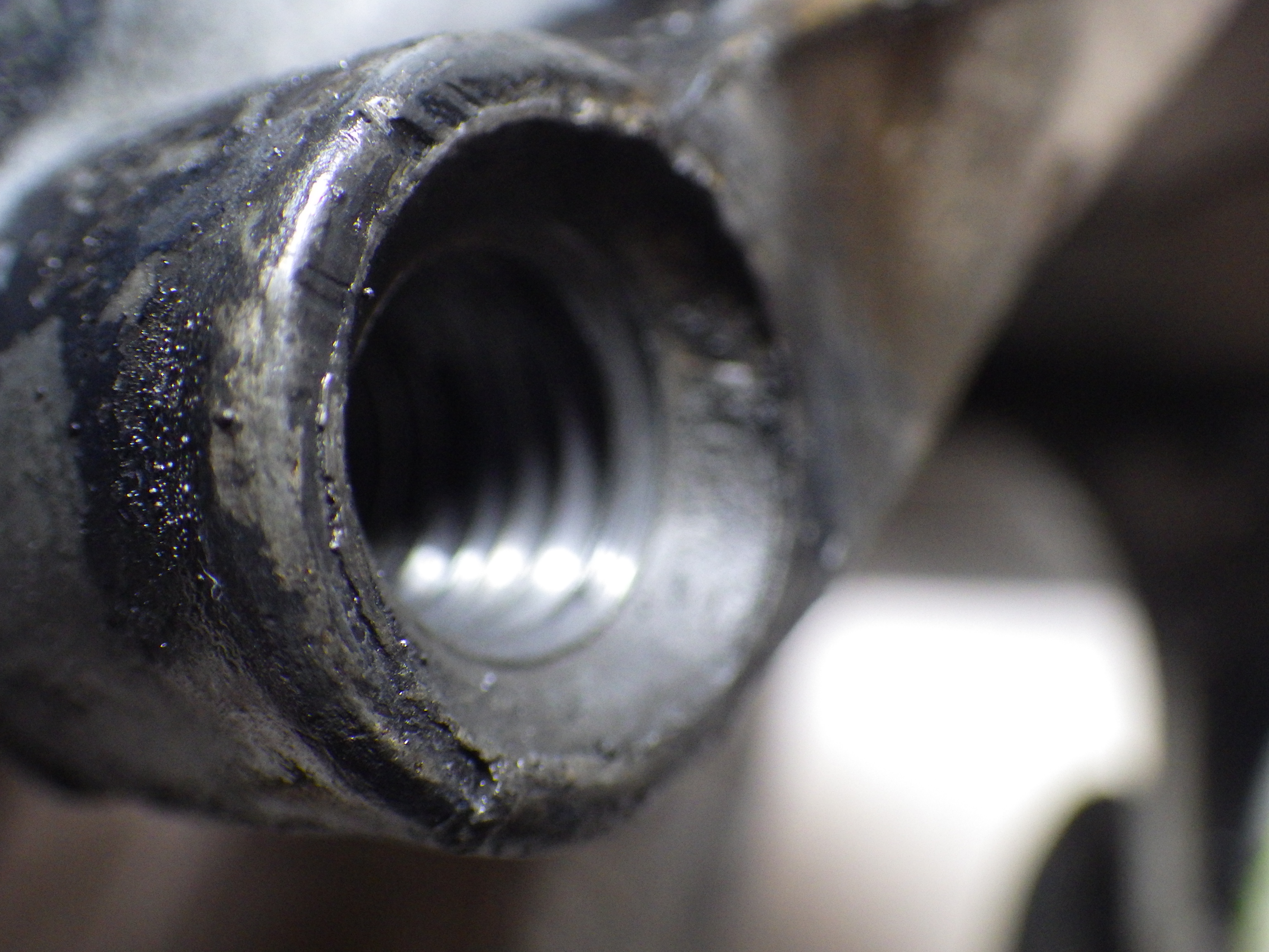

              The problem with aluminum and stainless threads is, if they aren’t kept well lubricated, they tend to gall. Being used in salt water doesn’t help them either. This galling can build up inside the transom clamp literally welding or jamming the parts together. Unfortunately, no amount of heat or penetrating oil can now release the parts. Drilling out the old clamp screw and chasing the existing threads will prepare the clamp for the new replacement part.

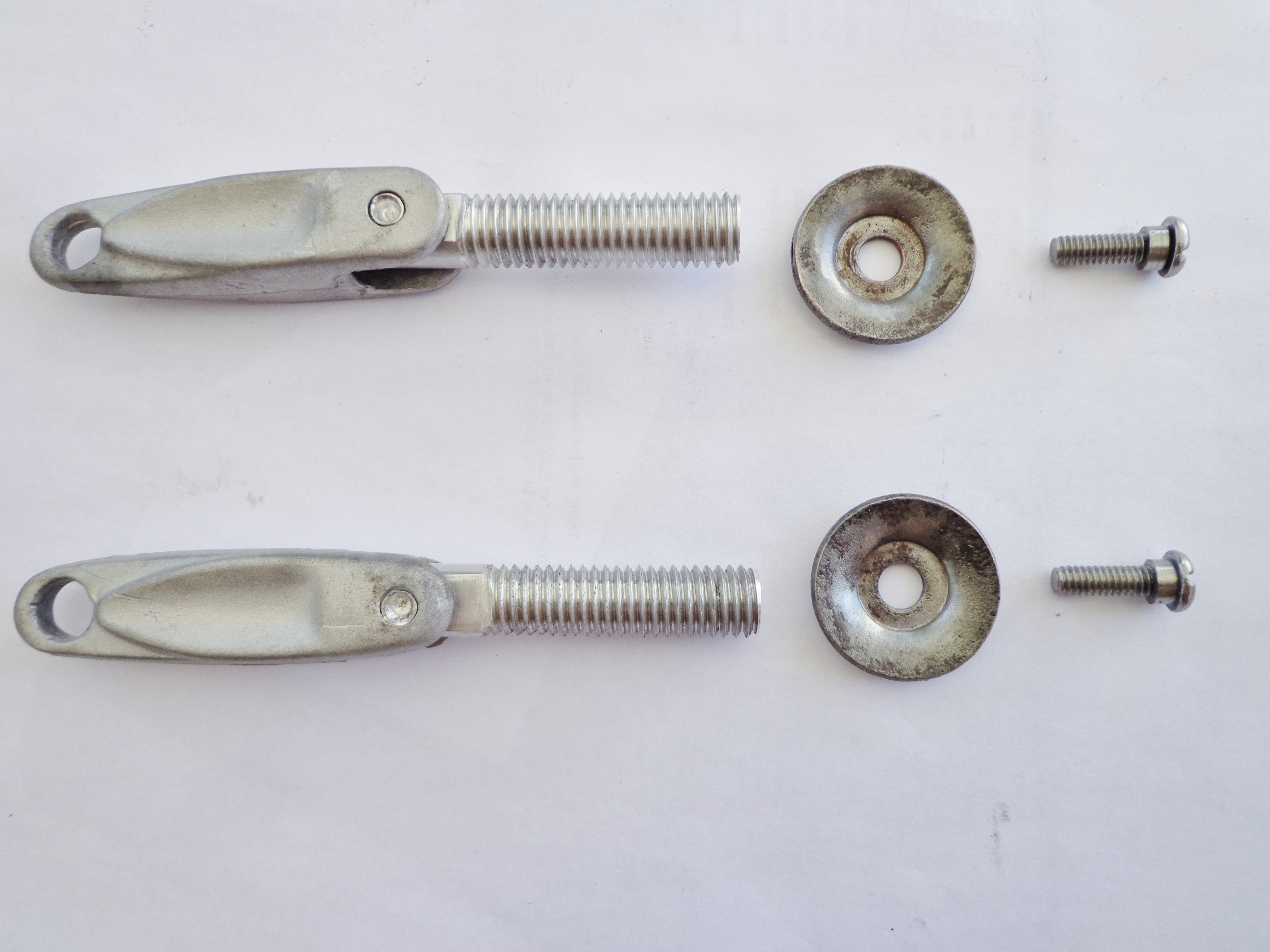

              Here’s a Johnson JW clamp I was working on today. The threads were badly galled so cutting it to remove it was the only solution. Making a replacement part isn’t too hard to do.

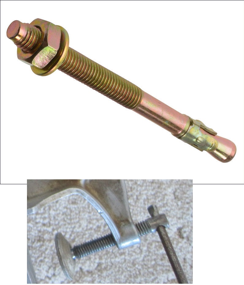

                I’ve used this style of anchor bolt
                to make something that looks
                somewhat like the original.
                  thats also my way and ……
                  that’s also the best way
