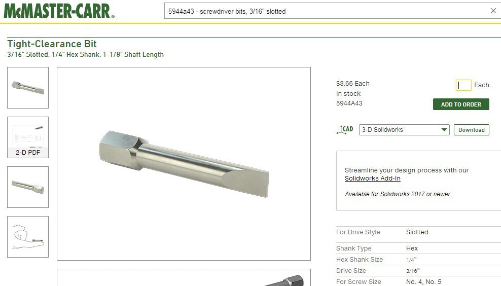

            #285630
            Steve D
              On the suggestion of Cajun Cook and Frank Robb I bought these some years ago and they work fine. Current price is $3.66 each.
              #5944A43 Tight Clearance Slotted Insert Bit, 1/4″ Hex Shank, 3/16″ Tip Width, 1-1/2″ Overall Length, 1-1/8″ Shaft Length
              https://www.mcmaster.com/5944A43/
              tight-clearance-bits-fixed-jet-removal
              #285633
              elgin2
                I bought a few of those years ago. They work great. I recall one or both of those guys recommended them.
                #285638
                  Yep, order 4 of them.  One to use, one to lose, one to give away, and one just because it is such a good deal.

                      cron78
                        Seems like the blades without flares would be good to adjust points, too, without having to move wires out of the way.
