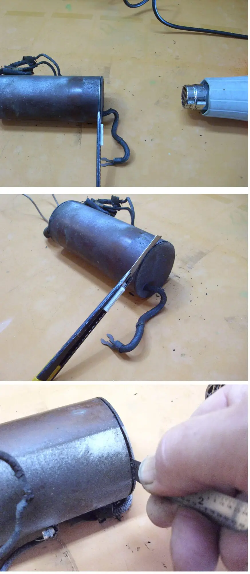

I’ve had pretty good luck getting the end caps off with a heat gun, wallpaper knife, and a machinist rule. Be careful with the heat. Don’t get the gun too close as it can damage the tube. If things don’t work out, Richard is there to save the day. Check ebay for elto straps.

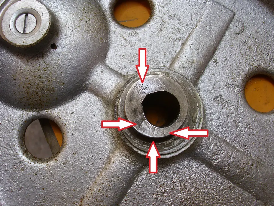

September 24, 2026 at 10:55 pm #329076
The flywheel on your model is prone to cracking if it is over tightened. You should check yours.
